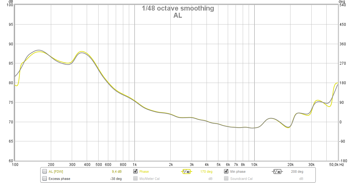

Please find below my most reliable impedance measurement, made by a friend.
An impedance bump is clearly visible above 2 kHz, together with a change in the phase response.
I wonder if this could be an artifact introduced by the pattern of slits in the phase plug?

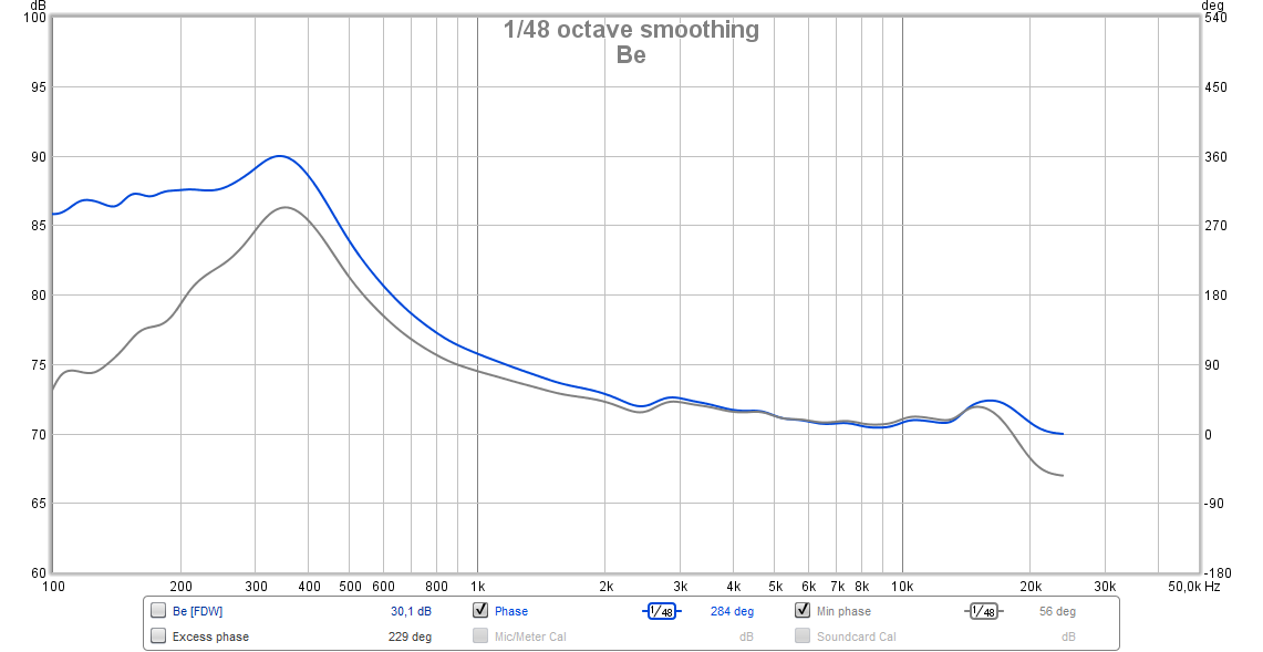

Can be wrong when it comes to real world but for me it looks docali have very fine device that if wanted can be corrected to nearly perfect in minimum phase domain whatever one use analog passive/active or DSP correction, base this because when we look at measured absolute phase verse amplitudes calculated minimum phase then docali have very fine data and only above 25kHz it starts deviate showing storage or other interference, below is phase examles FDW filtered to stay clear of looking at grass.
Measurement chain and calibration can of course be reasons the difference and also docali use 15 ohms dampening.

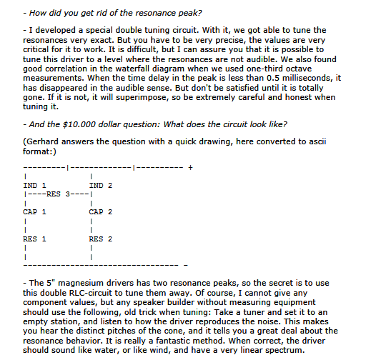

BTW dampening a double peak can also be done using below Joachim Gerhard recipe in combination using zma-file loaded to free XSim.

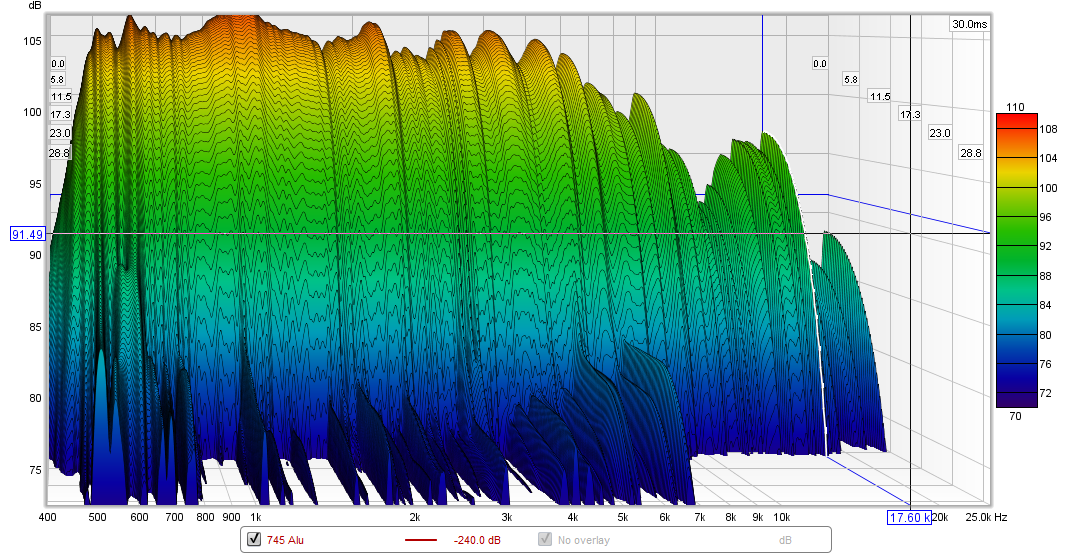

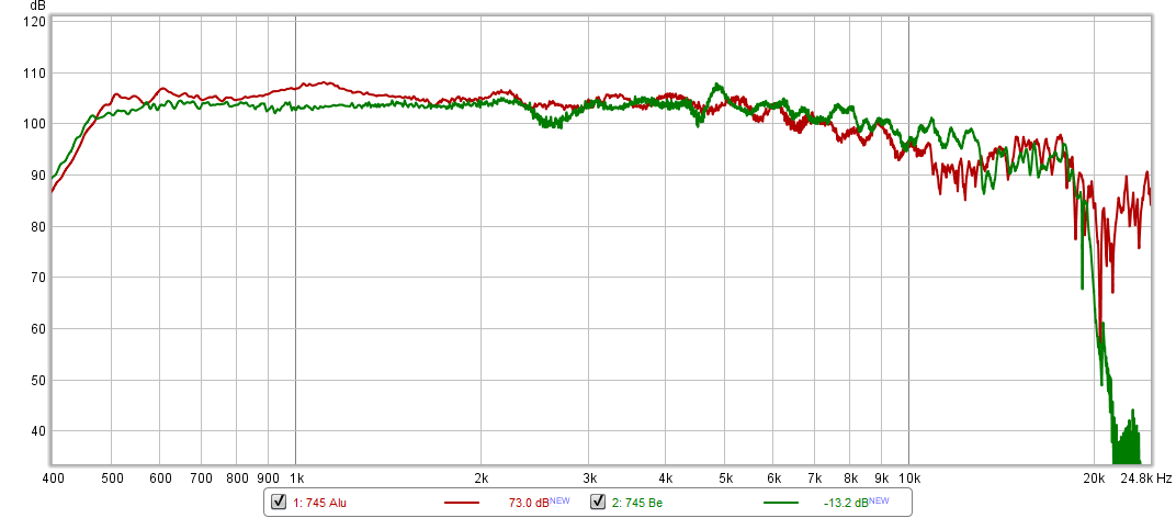

Here are some 1st looks at the two measurements, aluminum and beryllium.
I'm working on rise time for the waterfalls to see if there is a better setting to pull out more info.
No, in the last measurement I only used a single 8.2uF capacitor in the chain. Concerning the series resistor damping one can find a lot of information provided by Jmmlc here in the forum.

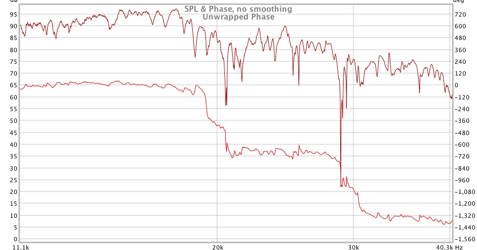

The ringing above 20K in this graph looks to me like it is from the DAC or ADC filters as it is very close to 22K which would make sense if the measurement was made at 44.1K.
639255d1507476980-beyond-ariel-horn-mouth-png
The impulse measured at 192K does not have that ringing. There is a couple of phase jumps which look like reflections.

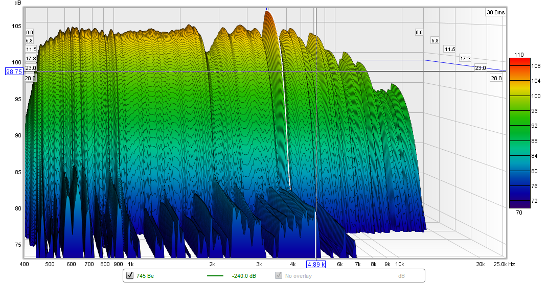

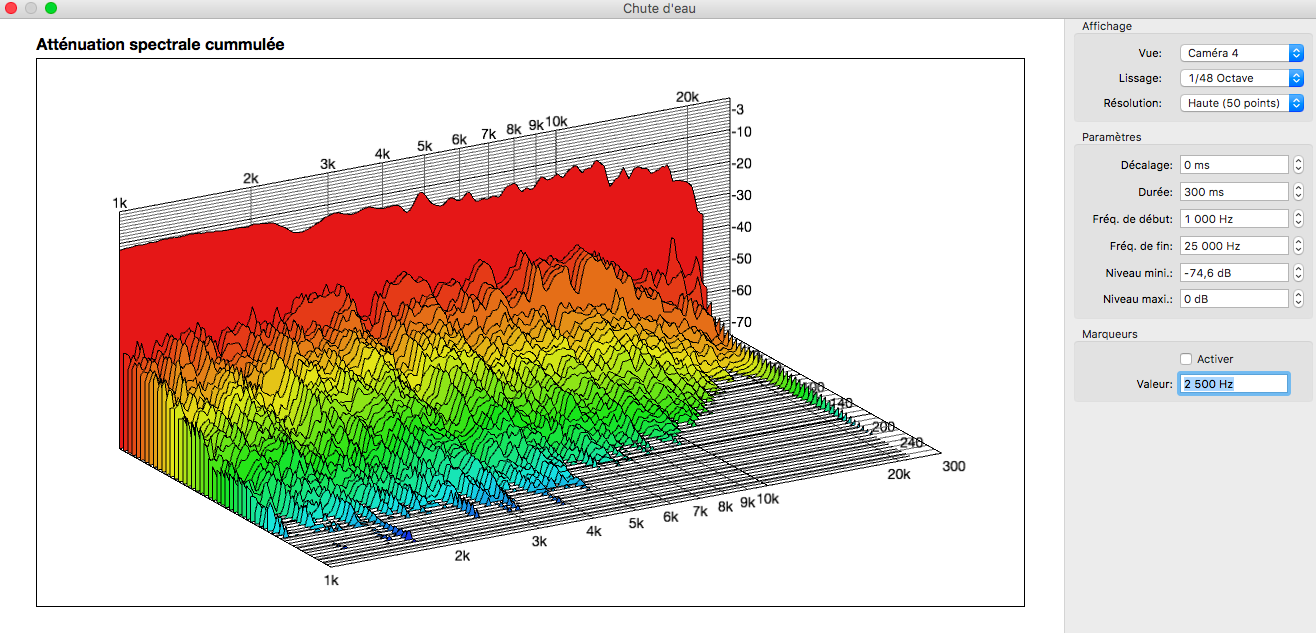

The early waterfall looks quite clean
attachment.php

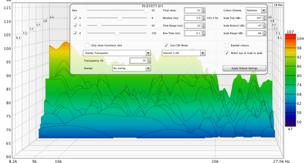

With settings shown
attachment.php

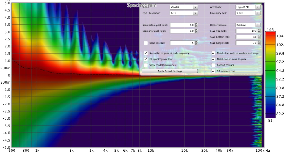

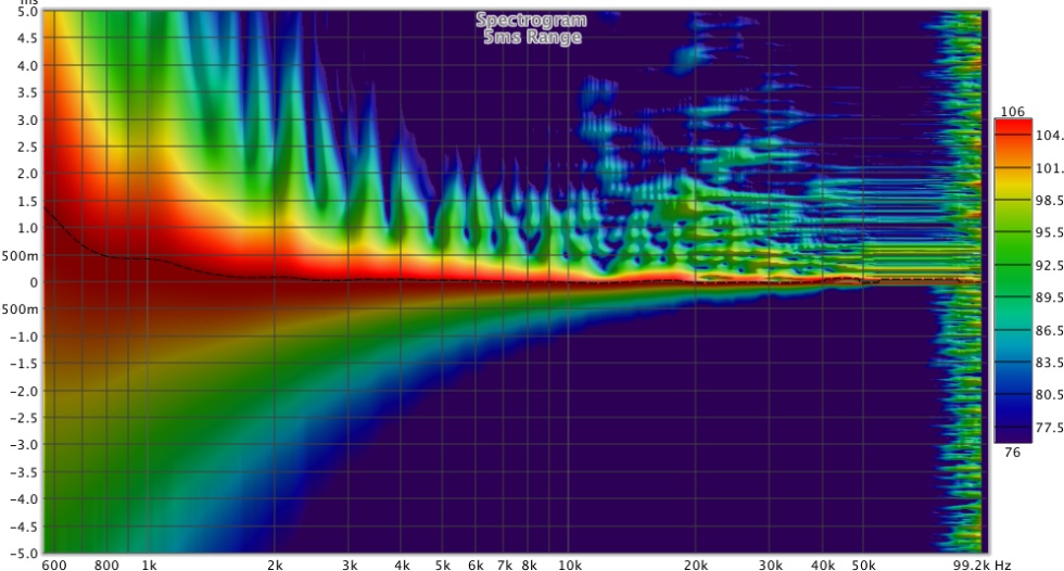

Spectrogram first 5ms
attachment.php

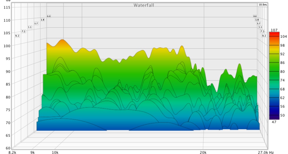

Thanks Fluid! That's a big help. Wesayso also gave me similar setting to try, which I will.
So you figure the notches up high are reflection cancellations? I used to have a terrible notch at 8.3K on my Altec 288 drivers. Never could figure it out.
A question about your sonogram, what are your settings? It looks like I would expect, but I can't get mine to look anywhere near that.
The deep dips with associated sharp phase drops suggests reflections. They are between 18K and 27K so the distances to create those reflections would be quite small.
The phase is remarkably flat to 18K and looks to be a very nice driver.
The Spectrogram settings are close to these I only started using the new REW version today so I don't 100% remember what I used. Change the limits to get the same frequencies shown and it should be close. Changing amplitude to Lin%Peak or Lin%FS gives graphs that look normalised.
attachment.php

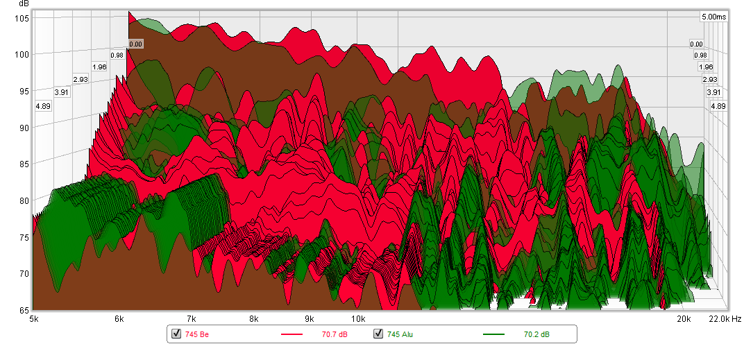

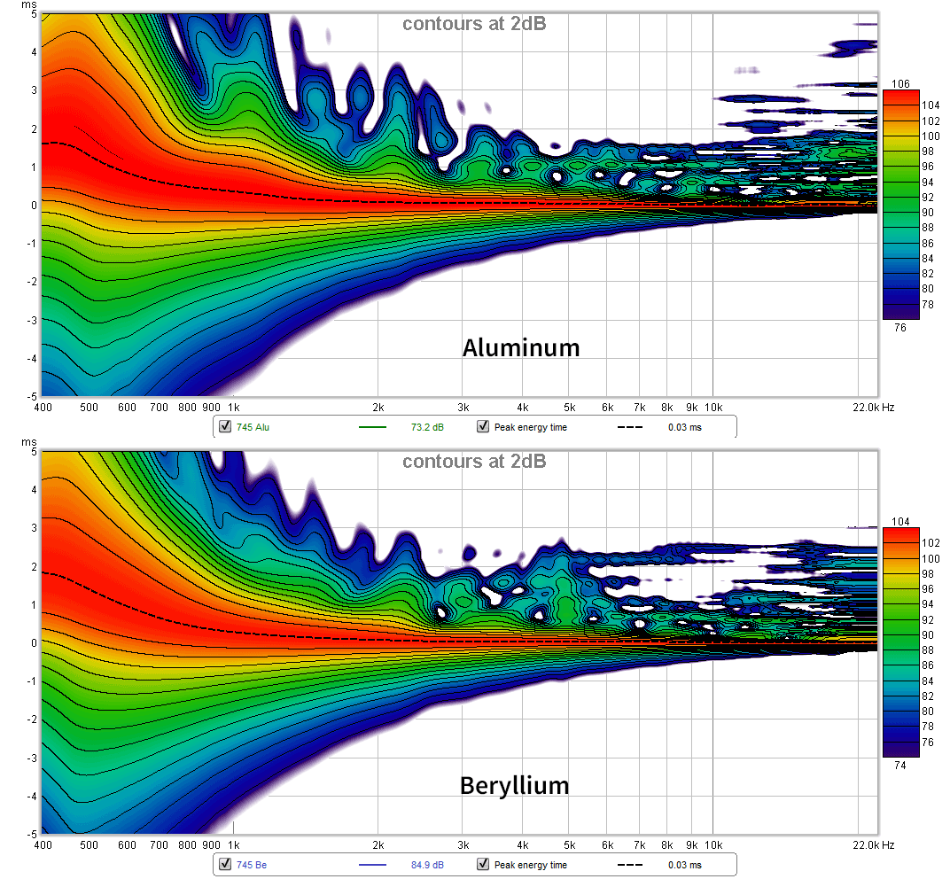

Here is another look at the aluminum and the beryllium impulse files. Remember that these are different horns. I limited these to 22K because the beryllium measurement was done at 48K.
On the left image you'll see a waterfall of the top end with the two measurements overlaid. If you see a higher level one on than the other going forward in time, don't forget that the initial level may be higher, too.
The other is a normalized spectrogram of each. In this all levels are the same. Contours are at 2dB, which may help. Honestly I can see that one of these is really better than the other, and my guess that the aluminum rings at the top isn't easy to see, if it actually exists. Maybe not.
Pretty noisy drivers!! too bad they are in different horns. The comparison probably doesn't mean too much though seeing the radian diaphragm mount is so erratic (bad!) and different horns. I like to look at fh to 5K most with upper mid compression drivers - 5k up is more for treble horns - I find be can settle fast (JBL 2435) but tends to have high high order distortion that gives illusion of "better detail" to some people
