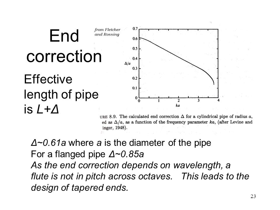

48" seems a little short for 60Hz, dosen't it? Not that I have room for horns that big. 🙂
It's using dual 15s, so more radiating area at the throat.
It has a large mouth, so if you include a little end correction it doesn't seem short.

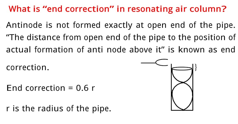

End correction to a horn mouth? Care to explain that?
I also don't know what's meant by end correction at the horn mouth, unless it's related to diffraction.
If we're talking about the acoustic length of a horn or closed end duct, the lowest resonance is usually lower than predicted by just the physical length. I don't know exactly why, but my assumption is that it's due to the shape of the wavefront at the exit versus the throat. At the throat the wave will be fairly close to plane and at the mouth it will have some radius that extends outwards from the horn past the physical end of the horn.
A very concise definition is:
"The “end correction” is the distance from the open end of a pipe to the antinode just above it".
This applies to standing waves in a pipe.
From Wiki:
A theoretical basis for computation of the end correction is the radiation acoustic impedance of a circular piston. This impedance represents the ratio of acoustic pressure at the piston, divided by the flow rate induced by it. The air speed is typically assumed to be uniform across the tube end. This is a good approximation, but not exactly true in reality, since air viscosity reduces the flow rate in the boundary layer very close to the tube surface. Thus, air column inside the tube is loaded by the external fluid due to sound energy radiation. This requires an additional length to be added to the regular length for calculating the natural frequency of the pipe system.
The concept of End Correction is widely used in Structural and Fluid Dynamics, Antenna Theory and notably the Acoustics of musical instruments (pipe and horn).
The point of reflection for air pressure fronts in brass instruments is not at the end of the tube, but some distance outside of it. End correction is the difference between the end of the physical tube and the actual point of reflection. This distance differs according to frequency.
There is no scientifically proven and accepted value for the end correction of a resonant tube, various values ranging from 0.3r to 0.6r have been suggested from numerous disparate experiments. Lord Rayleigh was the first scientist to publish a figure, in 1871: it was 0.3r.
Consider a pipe closed at one end and open at the other. A simple model tells that resonance will occur when the pipe length (plus end correction) is 1/4,3/4,5/4 etc. of the sound wavelength by assumption that antinode occurs at the open end. Due to the pipe wall waves can't expand freely, so there is not a perfect antinode. By addition of an end correction, the pipe appears to be acoustically somewhat longer than its physical length.
The most accurate value appears to be 0.58r (It is independent of the wavelength but does depend on the shape of the tube. Value is quoted for a circular cross section). Normally in such experiments, you eliminate (and can calculate) the end correction by finding two consecutive resonating lengths L1 and L2 at the same frequency, for example two cases where the L1+c is 1/4 wavelength and L2+c is 3/4 wavelength. Subtracting gives L2 - L1 = half wavelength. In most experiments, the speed of sound in the tube is calculated. However, it must be remembered this is not the same as the speed in free air.

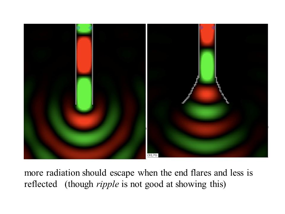

more+radiation+should+escape+when+the+end+flares+and+less+is+reflected+(though+ripple+is+not+goo.jpg49.9 KB · Views: 1,696

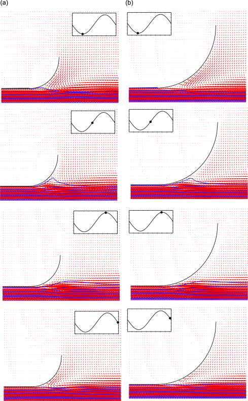

A properly flared horn/waveguide will not have any significant "end correction". The concept is ill-applied to a good waveguide.

On a different topic, my local horn manufacturer's chief designer recently told me that exponential horns still produce measured ripple when driven by a sine wavelength equal to the mouth circumference. Suggesting that the old linear model was inadequate.
The old linear model has been known to be inadequate since I wrote my Waveguide papers in 1991. All horns/waveguides produce "ripple" - some much much more than others. It's all about the design: flare: termination: phase plug; lots of different things can cause this well know problem.
