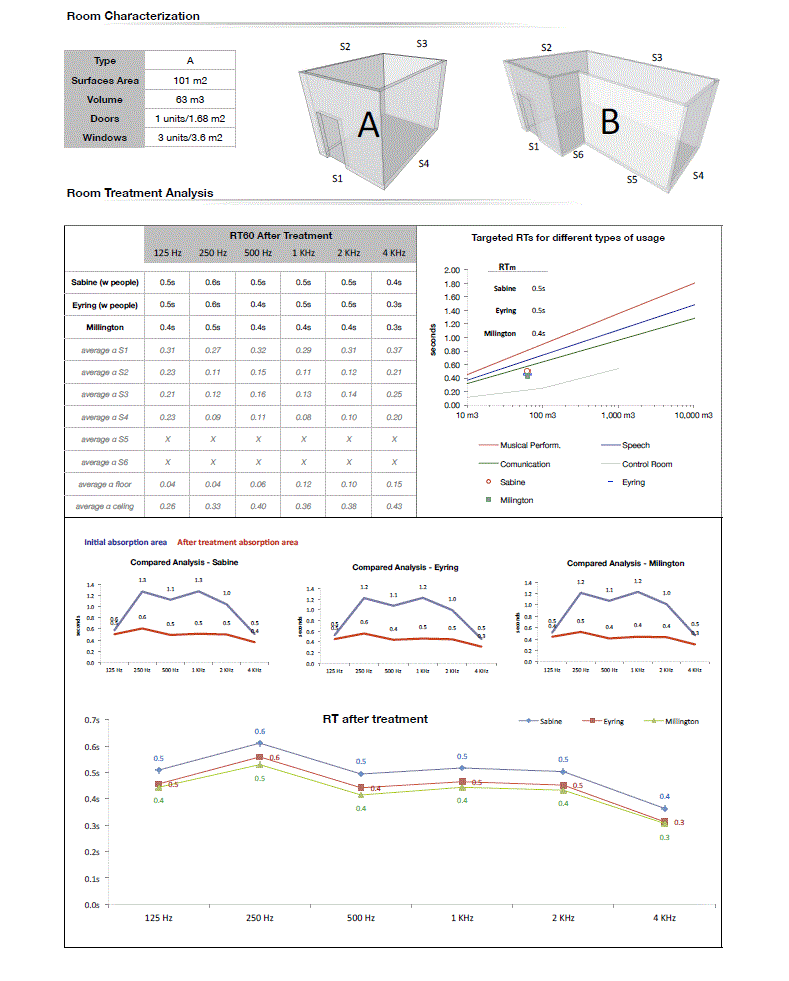

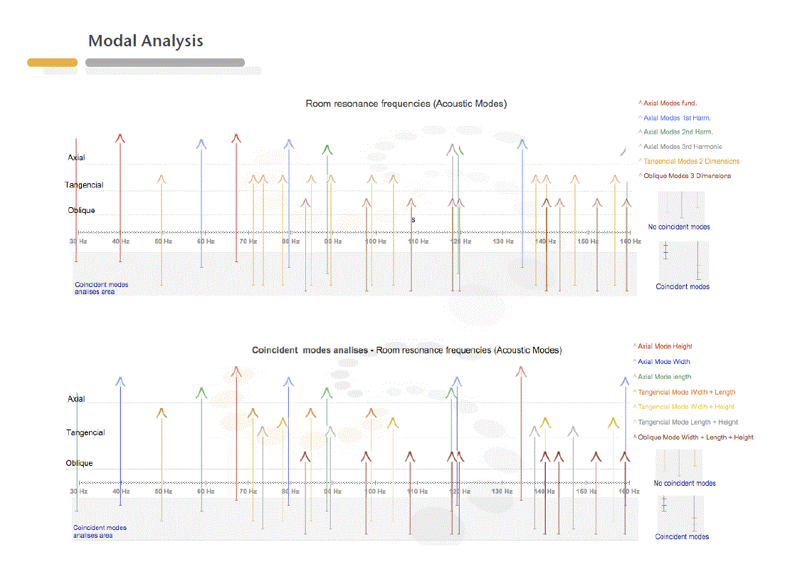

Room analysis and treatment
Only to show how complex room treatment is.
Analysis and treatment of the room. Only in this way it is possible to assess ANY reliable and extrapolatable difference in speaker sound!
So, if you do not have treated your room in this way and you show an simple FFT analysis without any windowing of the impulse respose or your speaker I will not believe the results 🙄

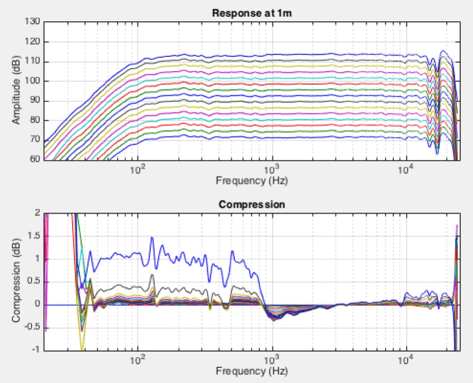

I have to say every time I see the comment about needing two 15" drivers I just chuckle to myself. I mean come on, one15" driver with not all that much power can easily drive you out of the room with raw SPL without taxing a modern 15" in the least. I would think that even a current GPA / Altec clone is using modern voice-coil wire, adhesives, and former material. So you surely aren't going to overdrive really a stereo pair of 15" drivers in any normal room. Now if as Earl is talking he is using multiple subs not for level but to counter room modes through distribution of sources plus room treatment. Now you want more bottom frequency extension by using two differently weighted cones so one has a lower fs than the other that works to extend the very low bass while the primary driver with the higher resonance frequency is used up to the xo point. Now me if that was what I wanted to do with two large drivers I would use a 15" for the primary speaker and an 18" to do the supplemental bass down to your low frequency of choice. I've done this before combining two differently tuned and sized bass drivers and it can work well. But I'm not worried that I can't get the realistic spl levels just with a single 15" per side. How loud is a 96 or 98db@8 ohm impedance speaker with a real 16 watt tube amp, pretty damned loud.

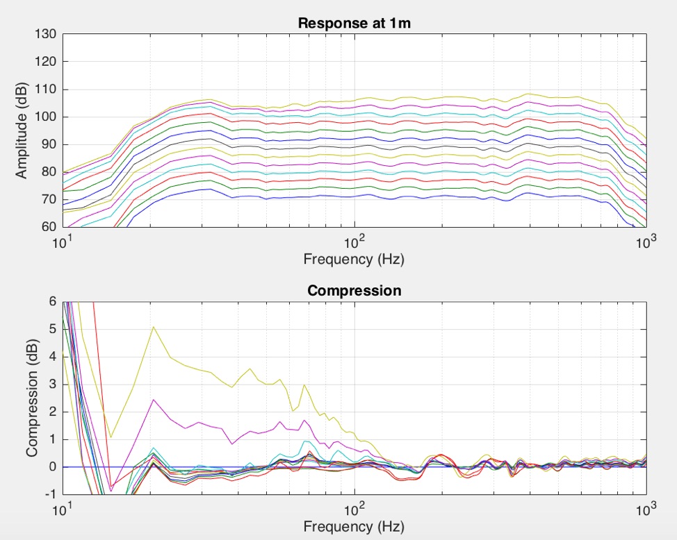

In my system, I have a 15" sealed sub and a 15" sealed midbass (JBL 2225) per side. The sub is the main contributor to power compression in the system followed by the midbass which makes perfect sense as the sub has the lowest efficiency and midbass is the next lowest. The mid and high frequency horns are better. I'm not sure how audible this is (although I plan to find out) as the compression is occurring at fairly high levels, but we're not building horn systems because we're happy with average results...
Anyway, some data - the first image is my system tuned for flat response without the sub. The second image is the sub and midbass. Stimulus was 5 seconds of pink noise for preconditioning followed by 5s of the same noise for a measurement at increasing drive levels. Compression is relative to the first response curve accounting for the expected rise in level.

I don't think I've ever seen a compression graph before - how did you plot that? The measurement by pink at rising levels is clear enough, but what do you use to calculate and plot the compression?ICompression is relative to the first response curve accounting for the expected rise in level.
Looks like you are good up to 110dB on the midmbass and 100dB on the subbass with compression starting above that. Thanks for the pots.
I use Matlab, but the same thing as excel other than that it is doing it real time and making decisions to continue or not based on the measured performance. The ability to script your own tests is very nice. For this I just measure response at a low level, measure response at a higher level, calculate the difference between the curves, and subtract out the amount I increased the output by between tests. If there is anything left (non zero), that is compression or expansion. I set up that test to increase by 3dB each time.
