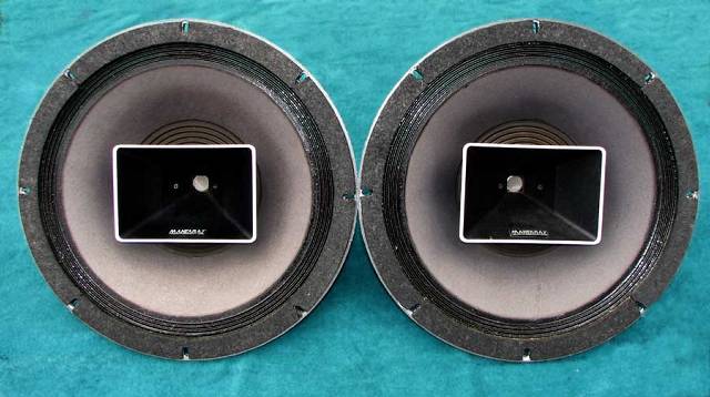

The Mantaray horn was a bit of a problem. Not big enough for the frequnecy where you'd like to cross it, . . . .
Knee jerk question from somebody who doesn't know much : Could the M-ray sides be extended or would the reflections from woofer cone then become the problem?
I think it's so big already, you'd end up shadowing too much of the woofer cone. Urei did use foam in the edges of the horn, maybe a bigger foam piece could help. Don't know, never tried.

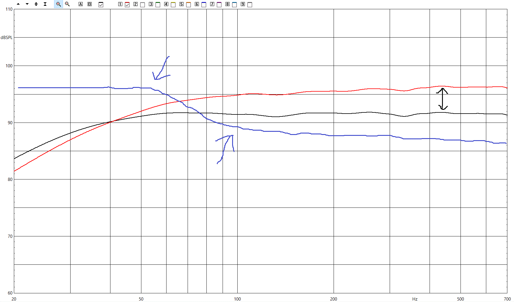

Here are my own measurements in the open baffle (job_for_lower_woofer.gif).
The red line is the resonse for 3.0A and the black line at 1.5A up to 700Hz. Normally, one would say, hey the woofer has a more flat response for 1.5A and has a slightly better extension to LF. But in this way you give away 4-5 dB effiency in the upper region. Ok, let's go to 3.0A with slightly rising response from about 80 Hz on. I hope you clearly see that the baffle step (baffle is about 1m width) coming from 20 Hz with about 6bB per octave is turning around 70-80 Hz in a slightly rising response. And that's where the blue curve is coming into the game. It is the cross-over function for the lower woofer. A big sereis coil is doing the job to bring the woofer down but a parallel arrangement of an resitor in series with a much smaller coil resembles the curve to fill up to a nearly flat response. After that all, a parallel capacitor is doing it's job to resemble the roll-off of the middle woofer. I thought that is is a good idea that the the lower woofer shows the same acoustic roll-off where the compression driver comes into the game as the middle woofer but at much lower in level. In this way it works for me. Maybe because both woofers have comparable properties even with different field coil current. And the best thing is that you can lift up or down the woofers using the field coil supply to flat response.

Not the stand alone Mantas you are thinking of. The little horns in the center of the 604 coaxial driver.Pano,
Which Altec Manta-ray's are you referring to? The ones I remember were rather large.
Got you Pano. Whether that was an improvement over the original multi-cell horn is the question or just different. That horn is just to small to cover the top end of a 15" cone and have a chance.
I was thinking of the standalone big Manta's that is what I was around when I was working on horns, Manta's, Bi-radials, EV's CD horns, Community, EAW, saw it all.

Thanks John, that makes sense and is what I would expect. I was just hoping that maybe it was a feature I had missed in some off the shelf software.For this I just measure response at a low level, measure response at a higher level, calculate the difference between the curves, and subtract out the amount I increased the output by between tests. If there is anything left (non zero), that is compression or expansion.
I liked your measurements enough to take a serious look at them, and try to get an idea of what they might tell us. Earl Geddes is correct, music isn't loud all the time, so pink noise may not be the best way to test this, it being a rather continuous level. Noise like that also is not a good match for the spectral content of music.
Pink and Brownian noise contain much more energy below 100Hz than most music does. I've run spectral analysis on many recording and genres before, and did again. A good approximation of big classical recording would be Brownian noise high passed filtered at 52 Hz, 2nd order. Some like Pink Floyd also fit that shape, with other rock and Pop - ACDC, Metallica, Black Eyed Peas, Green Day, the Eagles and others - rolling off faster under ~52Hz, perhaps 4th order. Testing with the heavy bass content of pink or brown noise may be showing more compression in your 15" sub than you are actually getting.
Looking at your graphs shows that with pink noise your sub starts compressing 10dB before your 15" mid bass. That made me wonder how much your subs would be into compression for various types of music, if your mid-bass is just at the onset of compression. Looking at various recordings, I'd say that the sub is into your compression zone about 2% of the time when the mid-bass is just touching that region. But on Pink noise? The sub would be into the compression zone 25% of the time. A major difference.
I made some graphics to show the compression differences of the sub in music vs pink noise. I can post them if anyone is interested.
Music vers Pinks graphs
