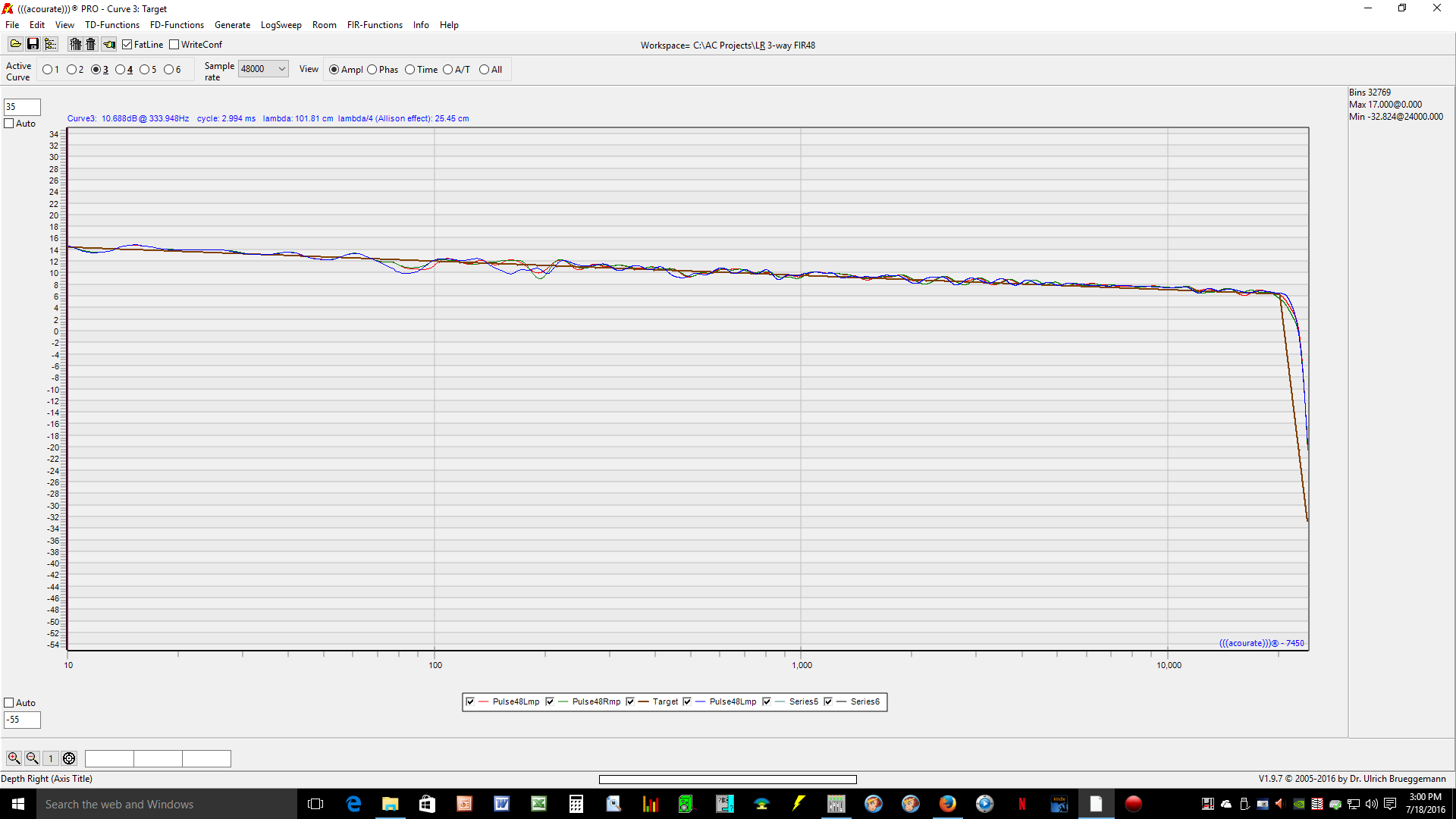

Here is the pic that apparently started the conversation. FR of my LCRs from the MLP, 10Hz to 24kHz vs target. Except just below 100 and 200 Hz, +/-1db from 10Hz to the target 20k rolloff.

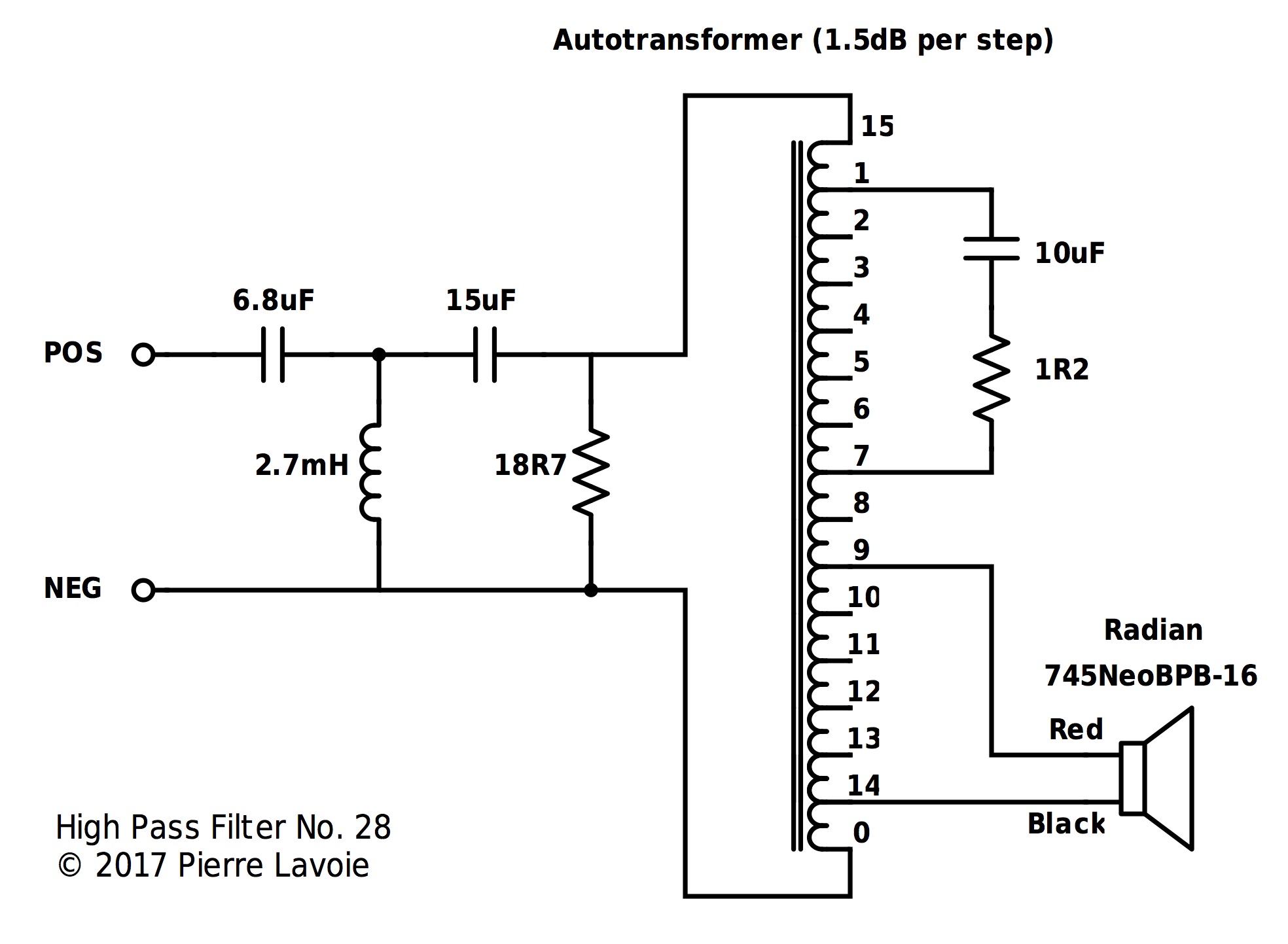

High pass filter
Our first build was a three way prototype completed in early 2014. The filter was a 6th order electrical L-R with Zobel for the TAD - similar to the TAD TN-2 filter, and a 4th order electrical L-R on the Yamaha JA-6681B midrange-tweeter. This Yamaha uses a unique high compliance, low fatigue beryllium/copper suspension (patented) and has a 35 mm (1.38 inch) throat. For super tweeter duty I relied on RAALs high pass filtered above 10 kHz. On the bright side, the extended dynamic range conveyed a natural, unconstrained delivery on well recorded music. Somehow live recordings were more enjoyable than studio recordings.
Version 1 of the crossover had many flaws though.
1. A lack of low end.
2. Poor top end spatial integration (3 way) or dull top end (super tweeter removed)
3. Overemphasized presence/ intelligibility.
4. Blurry imaging.
5. Cupped hands coloration.
Over two years we came up with the following solutions.
1. Added baffle step compensation.
2. Chose a 2 way over a 3 way configuration, and added a resistor and a cap to equalize the response of a Radian Beryllium driver.
3. Attenuated the 3 to 6 kHz bump in the response of the Radian Be driver. The Radian is efficient enough to be equalized passively. Since it was not selected for this reason, we got lucky.
4. Stiffer cabinets, with dampening to reduce the midrange back wave. The final cabinets have a thick bamboo baffle and curved plywood sides.
5. Lowered the Q of the high pass filter and adjusted the low pass filter to equalize the response of the TAD.
The most recent high pass filter for the Radian fitted to the Azura AH425 horn is shown below.
For newcomers to this thread, the Azura Horn AH425 is a medium-size horn that is the result of a collaboration started between Lynn Olson, Jean-Michel Le Cleac'h, Bjorn Kolbrek (who performed detailed BEM simulations) and Martin Seddon. Among its virtues, opening the horn angle reduces the reflection of waves from mouth to throat. The angle of the AH425 throat matches that of the Altec 288 and similar drivers, and its size and cutoff frequency allow integration with a large diameter midwoofer. Martin built a first pair for me in the summer 2013. His horns are superb in every way.
To equalize the response of the Radian driver, instead of adding a resistive L-pad, I chose to use the taps of the autotransformer already in the high-pass circuit. Simulations provided a starting point in the right ballpark for bypass capacitor and resistor values, but empirical tests were essential here. Choosing different autotransformer taps does not only adjust the level of the high frequencies, but also the shape of the response of the “notch” RLC circuit resultant from the bypass cap. So the three variables interacting with each other are the cap value, resistor value, and choice of attenuation taps. Finding a sweet spot between the three took a while. Fortunately measurements are straightforward in this frequency range.
As Lynn pointed out, the HF bypass cap idea probably goes back to the Altec Model 19. This is nothing new, but since the Beryllium diaphragm has good self-damping, we thought this approach should work quite well with this particular driver. Indeed it did.
What sounded best to my ears is an EQ circuit that attenuates lower frequencies by about 10 dB relative to the driver’s output at 15 kHz. The resulting response is flat-ish around 10 degrees off axis, and rises about 3 dB on axis. My hypothesis is that the rising on axis response subjectively makes up for the narrower HF dispersion pattern of this particular horn profile – which is not constant directivity.
The EQ circuit plays another equally important role. The Radian Be exhibits a bump in the “presence region” of its frequency response. This is a common flaw in an otherwise excellent driver. Some may like this sound – there is a reason why this region is called “presence.” Personally I find this objectionable and prefer the more neutral presentation obtained when the EQ circuit is in place.

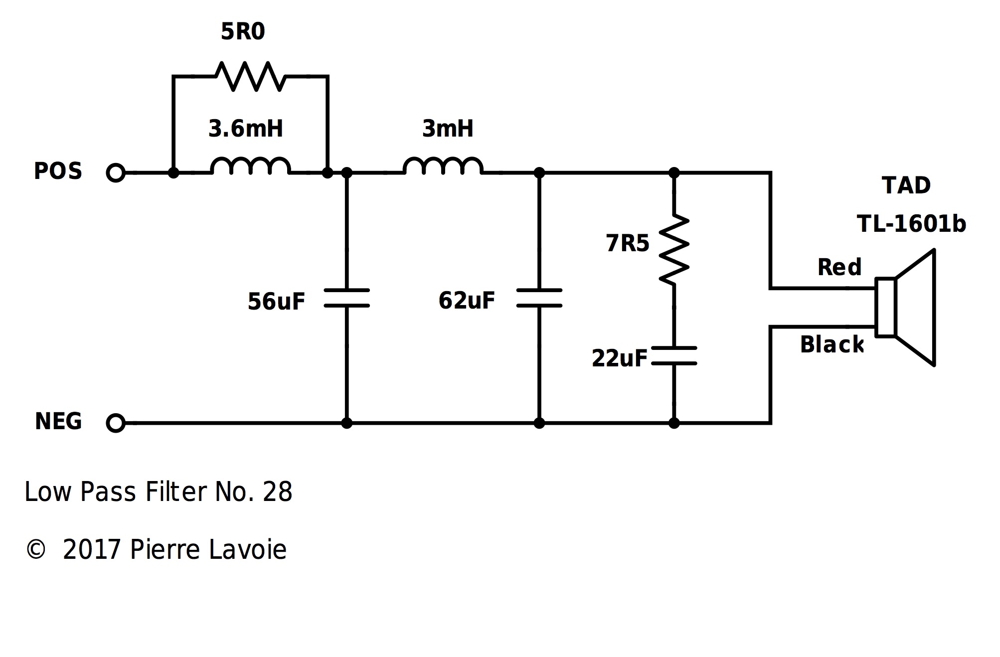

Low pass filter
Voicing the low pass filter took as long as voicing the high pass filter.
Here’s the most recent low pass filter for the TAD in a closed box of 134 L volume.
I agree, your explanation makes a lot of sense to me. In fact, this is very similar behaviour to some well-regarded "full-range" cone drivers.
Instead, with my radial horns, which are almost constant-directivity in the horizontal plane from ~300 to ~6k Hz, I find that I need an opposite, downward tilt for them to sound balanced.
Marco
I see that you ended up using similar 4th order slopes on the LP and HP branches.
From the picture you posted, however, I see a significant front-to-back offset between the woofer and the compression driver.
My question is: how did you get the two drivers to "phase track" over a reasonable frequency range around the crossover point?
In fact: did you?
In my experience, achieving good phase tracking with that kind of offset typically calls for a very asymmetrical crossover (like the TAD's 6th order LP and 2nd order HP, for instance).
Marco
