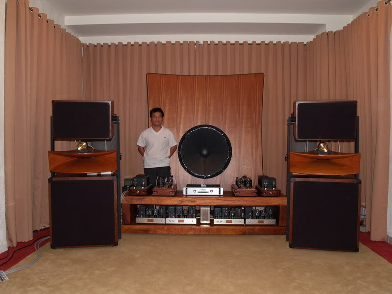

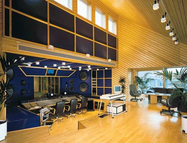

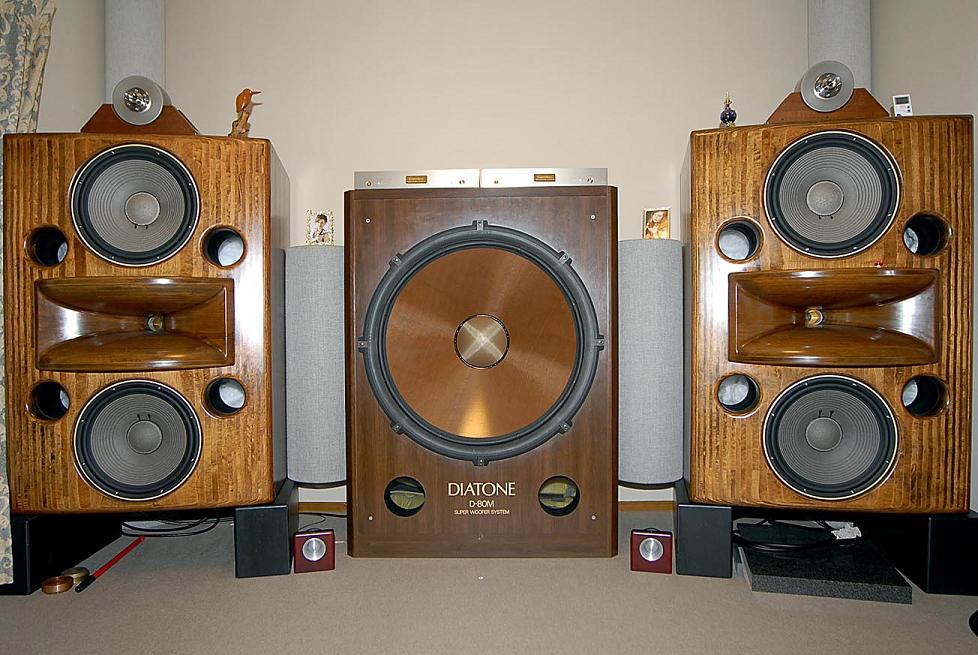

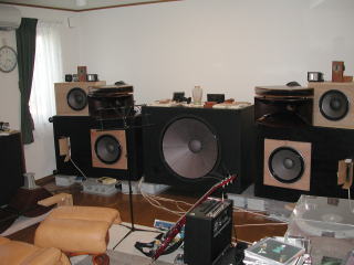

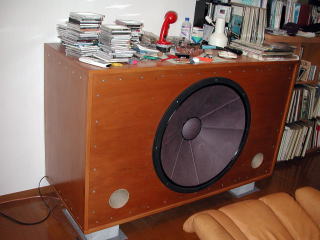

I agree. To put it simply, the lower the excursion required to produce a given SPL, the better (i.e. more 'natural') the sound.
That's why 80cm woofers like the Fostex FW800 / -N / -HS and the Diatone D-80M exist(ed), and why some Japanese audiophile use them. Yes, they are relatively Xmax-limited, and yes, you can produce the same SPL at 20-40Hz with a single high-excursion, high Mms 12" subwoofer. But NO, it will not sound the same.
Marco.
[Edit] P.S. The last picture is of the control room of a recording studio employing 2 Fostex FW800N per channel.
