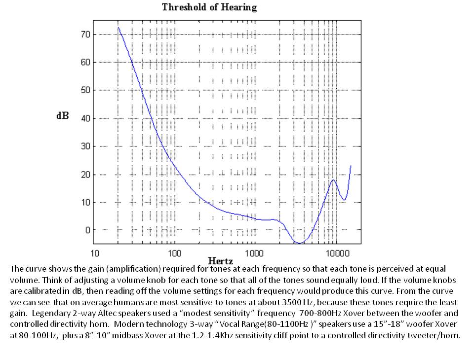

Perception of distortion tends to follow the Fletcher-Munson curve, so distortion in the 1~5 kHz range is most audible (and annoying), while the peak energy in the musical spectrum is around 200~800 Hz.
The Fletcher-Munson hearing threshold effect also helps the 90x40 SEOS waveguide folks like me to put a "coherent" crossover ~1.1-1.4Khz to 10"-12" midbass drivers. Vocal range is defined as 80-1,100Hz, which can be covered by a single midbass in this design philosophy. 90x40 polar response is perfect for HT couch families. The F-M sensitivity peak is ~3500kHz.
I am also trying to understand why accepting a physically larger woofer does not also make larger horns like the JMLC-350 or JMLC-270 which still use 1.4" compression drivers more attractive. If you purchase a $700 Be compression driver, and add a $400 big woofer, the horn cost cannot be the issue.

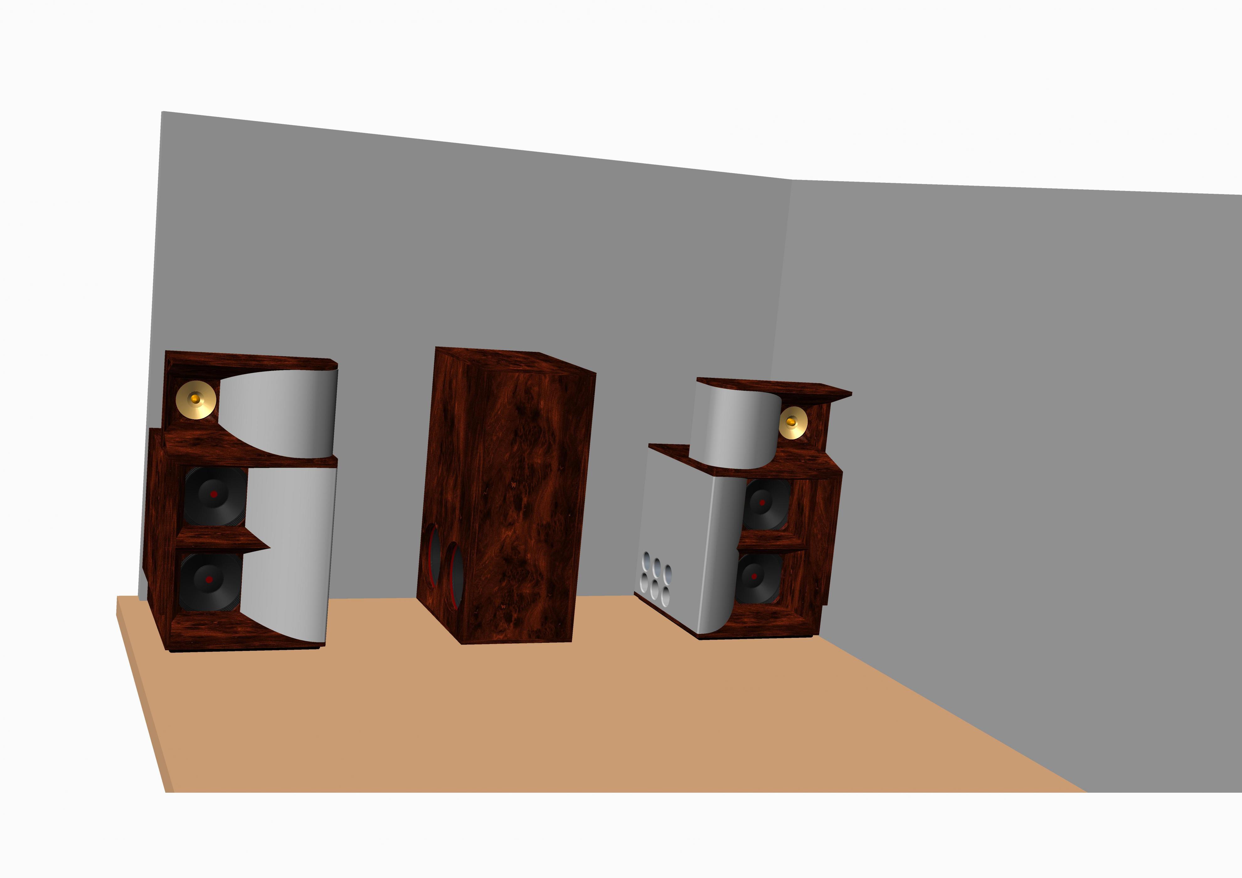

Hi All,
I´ve been reading through this thread with great interest 🙂 I do not know how many boxes i have built over the years but i have always returned to some form of horn loading of "full" range cone drivers. As it seems my taste in music and my way of listening is much in agreement with Lynn´s and a few others here 🙂
What i have struggled with over the years is to find a bass system that can keep up with the horn dynamics and i have been living with a system for a few years now that uses 4x15" IB for bass and it is over all the best I´ve had. It cannot really compete with the few (2 or 3) fully horn loaded systems that i have heard that really worked. They were all based on the article "Acoustic Compensation" by Rex Baldock from the mid-sixties. The bass from these systems are truly weightless and they can, fully time aligned, give full justice to a 32´ organ pipe. I have not found this article on the web but can scan and post it tonight.
I have always found CD based systems lacking energy and dynamics in the 300-500Hz region except on a few rare occasions and have stuck to my horn loaded cones, a force of habit and comfort as much as anything i guess 🙂
I have recently relocated and had to give up the old IB/horn system and is therefore setting up a little winter project looking something like below. The drivers used for the mid/high will be the same as in the old system, Feastrex D9e and for bass i have four GPA 416-16B. The aim is to get an as seamless integration as possible in the crossover region and radiation pattern that is smooth and well integrated with the room below say 5k.
I will have a go without sub to begin with and take it from there.

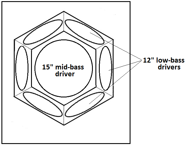

I just had another possible idea, and I thought I'd share it. It is based on the fact that Lynn is toying with the idea of a front horn for the mid-bass. How about making a hexagonal front horn, and the turning it into a type of Unity-horn. Start with a side length (for the sides of the hexagon where it meets the baffle of the mid-bass) of 26cm per side, the inner radius of the hexagon will be 22.5cm, giving an inner diameter of 45cm- just enough for a 15" woofer. Increase the length of the sides so that at the mouth the length of each side is say 46cm, then the inner radius will be 39.8cm, giving a inner diameter of circa 80cm. True, if you add a round-over to the outer edge of the horn-mouth you'd end up with a box of about 40" wide and about 44" high, but that is the one of the compromises. Now add a 12" woofer on each of the sides of this horn mouth. That will be six 12" drivers, enough to ensure good low bass. Not only that, but there will be a partial force cancellation between the opposing bass drivers. The sound will be also co-incident. My only problem with this idea is horn-mouth reflections from the bass drivers could be a problem somewhere in the mid-bass region, so I am not sure if this will work. Adding a round-over to the horn-mouth will also reduce reflections. I added an pic to better illustrate my idea, but again I apologize for the crudeness of my drawing. I only have MS Paint to do my drawings in.
Deon
PS. I got so caught up in the idea of a hexagon, I never gave thought to just a plain, square horn-mouth. Same idea, just fewer sides. That could also work, but from my own personal perspective, still need some help in the low bass. I really think 3 pairs of 12" drivers should be the minimum, but that's just me.

At this point I would also like to relate the experience of a friend of mine with regards to front horns on large drivers (I am talking about large cone drivers.) My friend, Chris Templer (you can look him up on TNT-Audio where he is one of the new reviewers - Chris on TNT-Audio), had a pair of the big Tannoy Autograph cabinets built for his Tannoy dual-concentric drivers. But instead of the standard conical front-horn, he decided to make it an exponential-type front horn. The exact expansion profile was 'toilet-seat cover' (his words). Basically he took a toilet-seat cover, traced to curve onto paper, and that became the curve for the front horns. The result was that they never sounded right. He said one of the things that was wrong was that they tended to throw the images to the ceiling. He later on had the Autographs rebuilt with the factory-spec conical front horn, and he said they sounded excellent that way. Since then he has upgraded to a double Autograph with a sub consisting of four 18" woofers in 6 meter tube (see a pattern here 😀). Nevertheless, his experience was that a conical front horn is best with a large driver and that is what he still uses.
Deon
