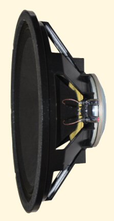

OK, another suggestion, but this will make the LTO a sub-sat. How about a good 15" driver (Rythmik Audio DS1500 CI anyone?) in the Decware Imperial SO subwoofer horns. Then we have a horn for the upper-mids and low bass (not sure how low the Imperial SO goes though). Only problem with this is that it'll place more pressure on getting the mid-bass driver correct. Anybody got any experience with these that they can share?
Speaking of mid-bass, has anybody mentioned/considered the BD-Design BD15 15" bass drivers for the range between 700Hz and the sub? Pricing (per pair) is about in the same range as the GPA 515.
From the BD-Design site:
Some specific elements responsible for the performance of these fine sounding bass drivers are:
- Light weight and high strength and, most importantly, a good sounding cast aluminium basket.
- Light and very rigid custom made paper diaphragm.
- A diaphragm able to resist air pressure and therefore capable of actually delivering bass.
- Spiders and surrounds specified for both good sound and very long life.
- Flat wired, light weight, extremely short and underhung voice coil.
- Small but very strong "double" Neodynium magnet construction with a 14mm(!) thick pole plate.
- Nearly 100dB sensitivity with 16 ohm impedance (almost 103dB sensitivity at 8ohm when used in parallel).
- Linear and clean response without noticeable break up problems.
- Very light total weight saves on shipping costs.
Here are the specs (also from the BD-Design site):

OK, I know I am a Johnny-come-lately, but with two drivers in parallel they give an 8-ohm and about 103dB/W SPL, and the Neo magnets should be a good match sonically for the Radian Neo. These were also made specifically to match up with a horn mid. Again, has anybody got any experience about these to share?
