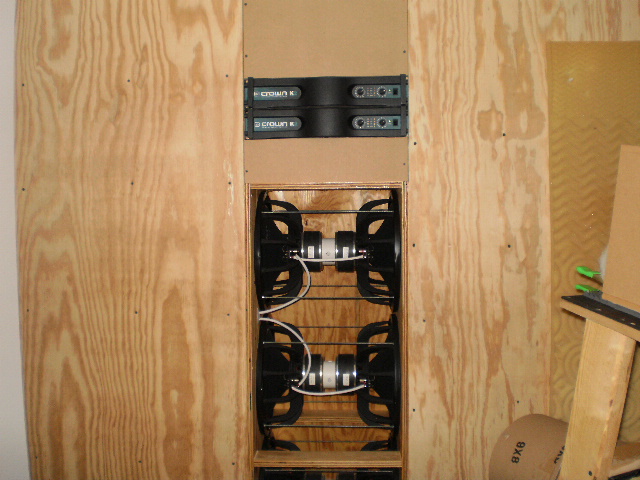

okay here's how I did mine (sub-bass)
I have been preaching this for years and years now. One has to be able to MOVE some air. My sub unit is just (one, mono) Infinite baffle utilizing 8 units of the Acoustic Elegance IB-15 back when John still produced them. They are indeed reaction-canceling.

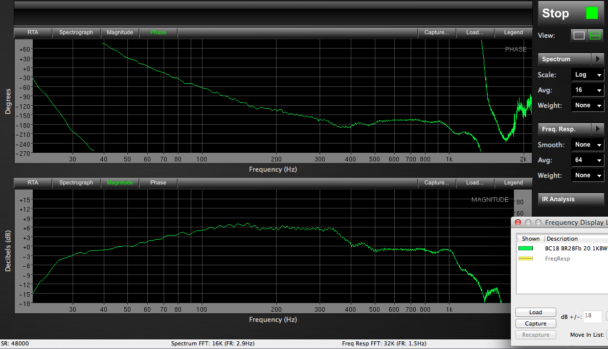

The screen shot below is a B&C 18SW115-4 in an approximately 9 cubic foot Fb 28 box measured outdoors at two meters, no smoothing at all. Larger box would flatten the response to 28 Hz.
The Eminence Lab 12 has excellent performance in the 20-200 Hz range, very low distortion too.
Like Earl, I'd be inclined to use multiple smaller drivers rather than one big driver- more options are available.
If you would like to see the higher order distortion response of either of these drivers I can provide them.
The distortion response of the B&C 18SW115-4 previously posted demonstrating high orders of distortion was at around 1500 watts, at home level distortion is hard to see above the noise threshold.
