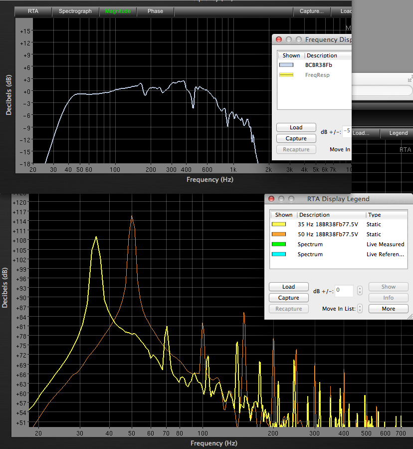

Although I agree with you that B&C woofers have a great BL curve, and that distortion should generally never be an audible problem with them at the power levels Lynn can achieve with the amps he prefers, I disagree that their speakers have virtually no harmonics higher than 2nd and 3rd.
In the screen shot below you can clearly see harmonics out past 11th order in the B&C 18SW115-4.
Not to say that this speaker would be a great choice for crossing around 700 Hz, but the BL curve does not eliminate upper harmonics.

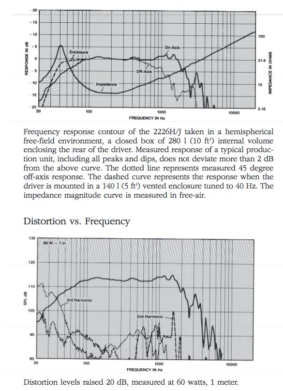

That said, the JBL 2226 distortion is also so low at the levels Lynn has presented it in the LTO Apollo (or Athena) that I would doubt distortion has anything to do with his preference of the GPA 416B (16 ohm version) over it, impedance, inductance and frequency response variations are more far more likely.
Art
