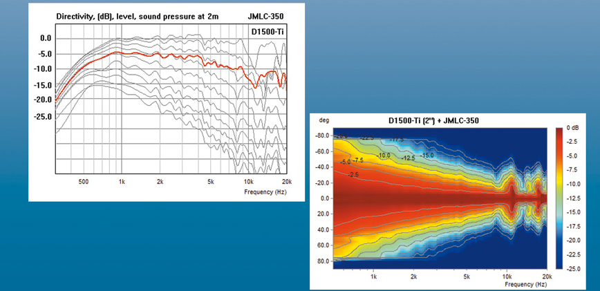

Hello,
You are forgetting that the simulation of the AH424 is based on a theorical source having a constant velocity.
Real measuremenst made on axisymetrical Le CLéac'h horns, never show an increasing slope of the on-axis frequency response curve.
See as an example a real measurement :
Horns
And no JMLC horn sounds overly bright !
Best regards from Paris, France
Jean-Michel Le Cléac'h
Jean-Michel,
No forgetting happened, I made the mistaken assumption the four of Bjørn's charts I re-posted were measured response, not all simulations.
Thanks for linking a real measurement, clearly the JMLC-350 is relatively flat on axis, with a -6 dB beamwidth from around 100 degrees at 800 to 20 degrees at 8000 Hz, a five to one variance over the decade.
As you point out, it would not sound overly bright on axis, though it would sound dull by comparison off axis.
What does the red line in the "Directivity,(dB),level,sound pressure at 2m" chart refer to?
What are the off axis angles in that chart?
Are the fluctuations in beamwidth above 8000 Hz driver type and exit size or horn related or both?
Do you have the measured response of the JMLC-350 with a 1" exit driver?
Do you think the AH425 horn Lynn uses would have similar dispersion to the JMLC-350 ?
