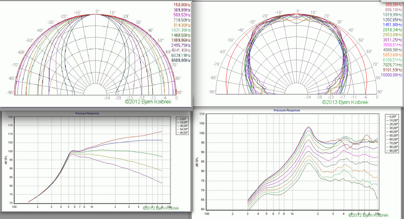

Here's the polar plot with log scale.
-Bjørn
Bjørn
Labeling the horn and test conditions of your polar plots would be helpful, but from previous posts we can gather the horns below are the AH425 on the left, and an OSWG (with or without the foam or crossover filter normally used is not stated).
The AH425 goes from an omnidirectional pattern at 500 Hz, (wider dispersion than a 15" speaker at 15") progressively narrowing to 40 degrees at 8000 Hz.
The on axis response at 8000 is around +11dB, around twice as loud (to our ears) as at 500 Hz. Over a fairly narrow beamwidth, (less than the width of a couch at a 2-3 meter distance) the sound character will change from rather dull to overly bright.
The beamwidth to stay within +/- 3 dB is less than 40 degrees.
The OSWG has a peak of 7.5 dB around 1600 Hz which will require equalization or crossover attenuation to eliminate. The response stays within a +/- 3dB beamwidth to just under 80 degrees, double that of the AH425.
If relegated to a single listening position, the smoothness of the AH425 response is appealing, and at one specific angle off axis provides flat response.
Given varied seating positions, the overall uniformity of the OSWG pattern would be my preference.
Different strokes for different folks.

Back to the OSWG data, the updated charts are more in-line. The comparison of a simulation (the LeCleach are simulated I believe) and measured data is still an advantage for the LeCleach, but at least it's closer. I'm betting the WG was smaller than the 15" model, and not necessarily mounted on a baffle. Gedlee's repeatedly made the point that a larger WG is smoother, and that the baffle is key, it's like the OSWG version of the huge lecleach roundover. My own OSWG-ish W/Gs are very smooth indeed, but are as big as the ones in the Summa, and have care at the mouth termination that a free-standing oswg wouldn't.

The on axis response at 8000 is around +11dB, around twice as loud (to our ears) as at 500 Hz. Over a fairly narrow beamwidth, (less than the width of a couch at a 2-3 meter distance) the sound character will change from rather dull to overly bright. The beamwidth to stay within +/- 3 dB is less than 40 degrees.
Hello Art
That is a pressure response curve. There is no way that the actual frequency response looks like that. That's why I asked Earl if the pressure response was related to the DI curve. Looks to me like the DI curve.
Not only that but those are SIM's where are the real measurements and polar measurements that are not normalized.

Thanks Bjorn. Gives a different impression in that form.
Yes, exactly. I have updated my web page with the figure as well. I have tried to do the comparisons at my site as fair as possible, but not having the exact dimensions of your wave guides (since you have not wanted to give them to me), the OS simulations cannot possibly be exact replicas of any of your speaker configurations. And, the axisymmetric BEM can of course not simulate your rectangular boxes.
I do not consider myself responsible for how others use the data I have made publicly available. And... it may come as a surprise, but if a simulation of an OSWG does not behave exactly like one of your models, it is not necessarily an attempt to make the OSWG look bad. They may simply lack your experience and knowledge on how to make the best out of the OSWG.

Art, you can find captioned figures, details and comments on my web site: Bem Simulations. There are also simulations of several other LeCléac'h horns and OSWGs, in addition to other horn types, all of them (IIRC) with full polar maps. Note that these are all simulations, without driver or crossover, intended to show what the horn does. The frequency response will of course depend on the driver, but the directivity will not change much.

I quite understand your position and I do not blame you for how other use your data.
I would say the simulations look reasonable given the pure sine nature. Most polars are shown 1/3 octave which washes away a lot of problems (most of them actually). I use critical band smoothing which is about 1/20th octave above 1 kHz. This is still going to smooth out things that you will see with a simulation at a fixed frequency. All in all I would say that your sims - when properly considered - show precisely what the issues are. When taken out of context they can show whatever the poster wants them to show. Its important that people see both sides.
By the way I tried your website but I could not load it. Do you show polar maps for the OSWG. Those are what I know best and could tell if the sims reflect reality or not.
I would have no issue with giving you the dimension of one of my waveguides. I don't remember you asking. I have a ton of very accurate data on them that could be used to validate a model.
I plan to take my measurements up one more notch to better quantify the performance. My hope is that with the next installment I can begin to sort out the HOMs. It's clear that something like that is occurring in your sims as the angular features are not at all constant - a key feature of HOMs. The question that is very hard to sort out is what are caused by the mouth and what are from down into the device. No far field measurement could ever sort that out.
Are you aware that I can reconstruct the velocity at the mouth by a reverse (ala holographic) technique from measured data. It works down to about a 1/2 wavelength now because the boundary conditions are not precise. My plan is to use a large flat baffle which should allow for about a 1/4 wavelength resolution and then possible a reconstruction of the waves inside the device from that. A lot of work but the only way to get to the nitty-gritty of these things.
