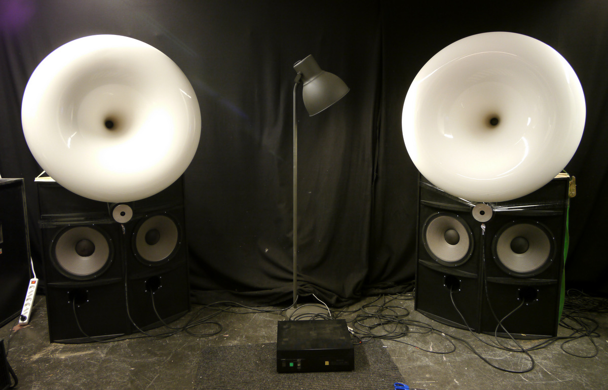

Horisontal dual 15" config
Made some sawdust recently. This is a report from transistor amp and PC-based crossover territory. A quick mockup to gain hands-on experience with 15"s in a horisontal layout. The enclousures for the JBL 2035s is actually 4 midbass/bass units that I have been building for at club which have a very specific music profile, only playing rock from the 60s (they will be loaded with 2226 upon delivery). Changing back and forth between 2226 and 2035 confirmed my preference for 2035 in the 300-600 region.
The horns are LeCleach 200T from Autotech Poland, with JBL 2446 and original titanium dias. Tweeters are Yamaha JA4281. Crossovers at 600 and 7000.
The supertweeter "opens up" the soundstage and counteract any beaming from the huge LeCleachs. This is fun! For quick and dirty mockups like this, Audiolense is a valuable tool if you use the right settings. Bill Callahans baritone voice survives surprisingly intact beeing churned through a crossover at 600Hz.
