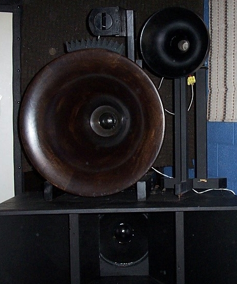

My own activities with the 120Hz tractrix horn -
audio-talk :: View topic - Something stirs in the Undergrowth
..have led me to conclude, so far, that the Fane Studio 8M may not be ideal for this application - it's quite a heavy-duty driver, and it doesn't sound as good, at normal playing level , in this horn , than the B&C 8PE21 that I tried before. I wonder if Martin was really on the right track with these bass or bass/mid horns in using the Lowther PM2A or Vitavox drivers, which are designed for lower-level signals ? As you say - the horn-loading can't help but show-up these problems, given the very low excursions.
I wonder also if Romy's use of the Tannoy 'injection' channel was a way of fixing this problem ?
Makes one think that the compression driver, with its aluminium flexures, is a very attractive technical approach to the low-level signal issue .

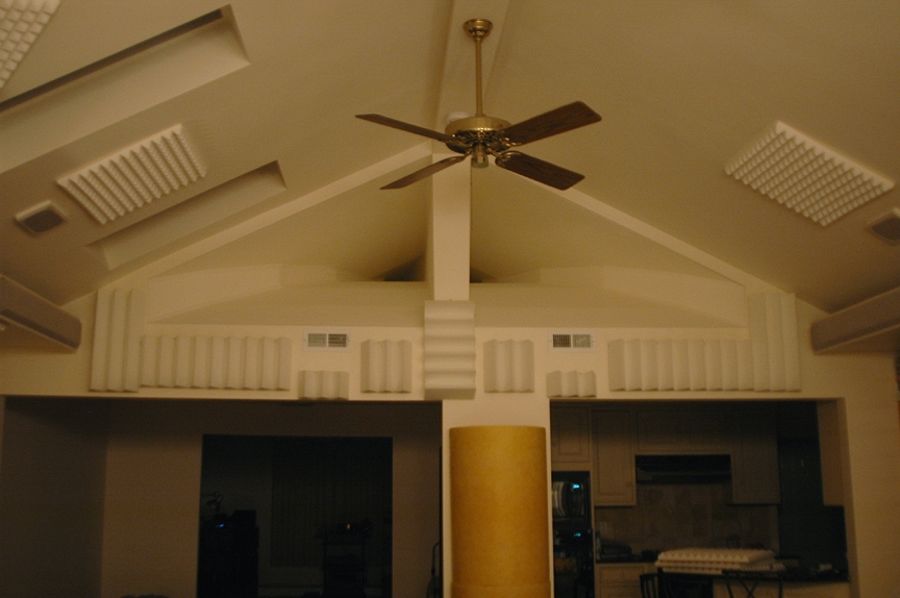

Here is a pic of Romy's 250Hz cut off mid bass horn mouths, they are a straight horn and built into the area above the kitchen. His seating position is time aligned between these and the round horn system at the other end of this room. His true bass is still provided by 4 or 5 stacked 10" bass drivers in individual sealed cabinets per channel, no ports.
