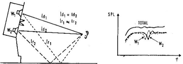

Another difference between horn and direct-radiator bass is the effect of the floor bounce, which creates a null that might fall at an unfortunate frequency (close to the crossover). The mouth of a bass horn is usually right next to the floor, which effectively creates a mouth with twice the area, since the floor image merges with the physical mouth above the floor.
This doesn't happen with an Onken or typical enclosures for 15" drivers. The bass driver is above the floor, which creates 2 apparent sources from the listening position ... the physical driver, and the reflected floor image. There are additional reflections from the back and side walls, but these have substantially more delay.
Part of the annoying jiggery-pokerey of moving a conventional stand-mounted 2-way so that it sounds smooth is really adjusting the timing of the 3 reflections (floor, rear wall, side wall) so the overall response is more or less smooth in the 200 Hz to 800 Hz region. Unfortunately, the smoothest-response location is probably not going to be the best-image location, so the result in most rooms is a compromise.
Here's a convenient little floor-bounce calculator. Keep in mind that there's a 3~6 dB peak at twice the null frequency, and another null at three times the null frequency.
In principle, a vertical array of woofers going from floor level to the desired listening height should sidestep the floor-bounce issue, but the commercial systems that take this approach don't sound right to me ... kind of blurred and bass-heavy, nothing like horn bass at all. The commercial systems with a single 15" bass driver close to the floor also sound murky and dark.
Possibly the trouble with a vertical bass array is too much output from the driver closest to the floor ... since the lower driver "sees" the floor reflection, it raises the effective efficiency (gain) of the driver. If a vertical array is used, perhaps it's better if the array has the response shaded so the upper drivers are more efficient ... in the example of this system, the upper driver would be a 515, while the lower driver would be a 416. The 2~3 dB difference in efficiency would just about compensate for the increased gain of the driver closest to the floor.
