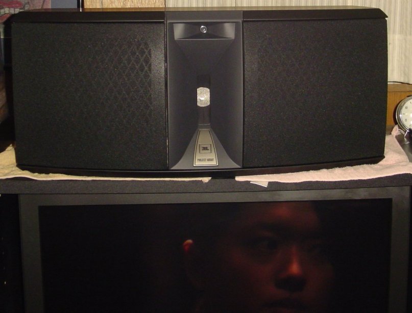

I think a lot of how people feel about the jump is where there past experience lies. I started with undamped titanium and the jump from damped vs undamped was significant. I then went to Be and again there was a jump. Later on I ended up with an Array center that uses a damped aluminum diaphragm. It sounds really good to me. I have it running side by side with Be drivers and I am not all that sure I could tell the difference. The blend across the front of my HT is quite good when things pan.
