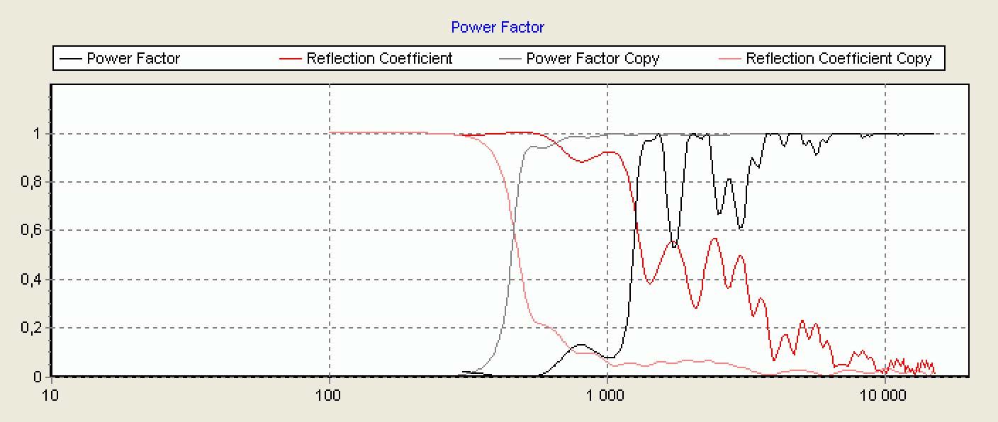

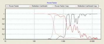

Here's one of Bjorn Kolbrek's simulations comparing the power factor of a T=0.707 LeCleac'h horn that is exit-angle-matched to the Altec 288 (8 degrees) compared to a conical horn. (Both horns are simulated in free air, not mounted in a cabinet.)
The thin black trace shows the resistance term seen by the 288 driver with the LeCleac'h horn, and the thin red trace shows the reactance (or reflection) of the LeCleac'h horn. Like an antenna at RF frequencies, the goal is to get signal out of the antenna and radiated into free space, not reflected back to the transmitter. For an RF system, the wasted power heats up the power tube and could potentially damage it, and for an audio system, the reflected power bounces off the diaphragm and phase plug and re-emerges 2 milliseconds or so later.
Reflections in horns are quite undesirable, since they result in significant reflections in the time domain. Since they are reflections and not resonances, conventional frequency-domain equalization does not improve the time-domain response - it makes it worse.
The heavy black trace shows the resistance term seen by the 288 driver with a conical horn, and the heavy red trace shows the reactance (or reflection) of a conical horn. (The simulated conical uses a smoothed Quadratic Throat transition region between the compression driver and the horn expansion.)
Note much poorer diaphragm loading in the critical 1 to 5 kHz region, despite the conical being the same size as the LeCleac'h horn. More significantly, the reflections are much stronger as well. The LeCleac'h has reflected energy down to 10% at 700 Hz, while the conical only drops into the 10~20% region at frequencies above 5 kHz. The "lower efficiency" of the conical in the 1 to 5 kHz region is actually energy bouncing around in the horn. Sure, you can solve the energy-loss problem with more input power, but what does that do for all that reflected energy bouncing around inside?
Why am I not a fan of conical and near-conical horns? This is why. The combination of Newell and Holland's direct measurements (shown in previous posts) combined with Bjorn's simulations, showed the problems with uniform diaphragm loading are quite severe, and not responsive to equalization. Yes, the gross FR aberrations can be corrected with notch filters, and/or active EQ. But that has no effect on a reflection series, and coloration in the 1 to 5 kHz range is the worst possible spectral place for problems to happen in a loudspeaker. If you've wondered why commercial constant-directivity loudspeakers used in PA systems and theaters have an unpleasant fatiguing quality in the midrange, this is the reason.

Sorry about that, guys. The referenced material in the deleted posts is on pages 108 through 113 of Newell and Holland's book, which describes the design criteria for the AX2 horn, which I used to guide the design for the AH425 horn, with Bjorn Kolbrek's substantial assistance. I very highly recommend buying the book if you are serious about horn design, or are curious about any aspect of high-efficiency loudspeaker design. The Newell and Holland book is not aimed at the Loudspeaker Design Cookbook level of reader, so if you're just getting started, stick to Vance Dickason's book. For rest of you, get it now; get the research data directly from the authors. It costs less than a single driver, and way less than a failed project.
The point made by the two authors is that horn length should be limited to 12 inches or less, so that any remaining reflections fell below perceptual thresholds, and that there is a design tradeoff between smoothness of diaphragm loading (a resistive load over the entire working range) and directivity control. In other words, directivity control by means of throat diffraction inevitably creates reflections, which then appear in several other domains - the ratio of resistance versus reactance over frequency (as shown above and in Holland and Newell's detailed measurements), impedance variations, loss of efficiency over part of the working range, and most importantly, time-domain reflections that are not correctable by standard methods of equalization.
All things I want to avoid. There are other ways to address directivity, but reflections, particularly in the critical 1 to 5 kHz range, are very undesirable and very hard to remove after-the-fact with electronics.

To explain a little more about the curves Lynn put up a few posts back: the black curves show the power factor of the horn, which is the cosine of the phase angle of the throat impedance. It directly tells you at what frequencies the horn will transmit power efficiently, as P = |p|*|U|*cos(theta), P being power, p pressure, U volume velocity, and cos(theta) the power factor. The red curves show the reflection coefficient, a reflection coefficient of one is a total reflection, zero is perfect transmission. It is calculated based on the impedance mismatch between a source with an impedance of rho*c/St (the asymptotic throat impedance) and the actual throat impedance of the horn.

A well designed waveguide has no internal resonances. In my designs there are no ripples in the Compression Drivers impednace curves and none in the pass band of the radiated response. Yes reflections are a very bad thing, but length of the horn has nothing to do with the problem. Its all about good design - the mouth being the critical part in this regard (assuming no internal diffraction).
"time-domain reflections" are correctable in both time, frequency and space by EQ as long as they are single mode reflections. The higher order modes that can result from reflections internal to the device are NOT correctable by electronic means however. This is a fundamental difference in the two types of modes.

I'd like to draw the reader's attention to the differences in throat impedances of the different types of horn. The conical is the worst by far, with throat diffraction, combined with mouth reflections, as the culprit. The AH425 is one of the smoother profiles, although it's entirely possible a smoother profile could be designed.
