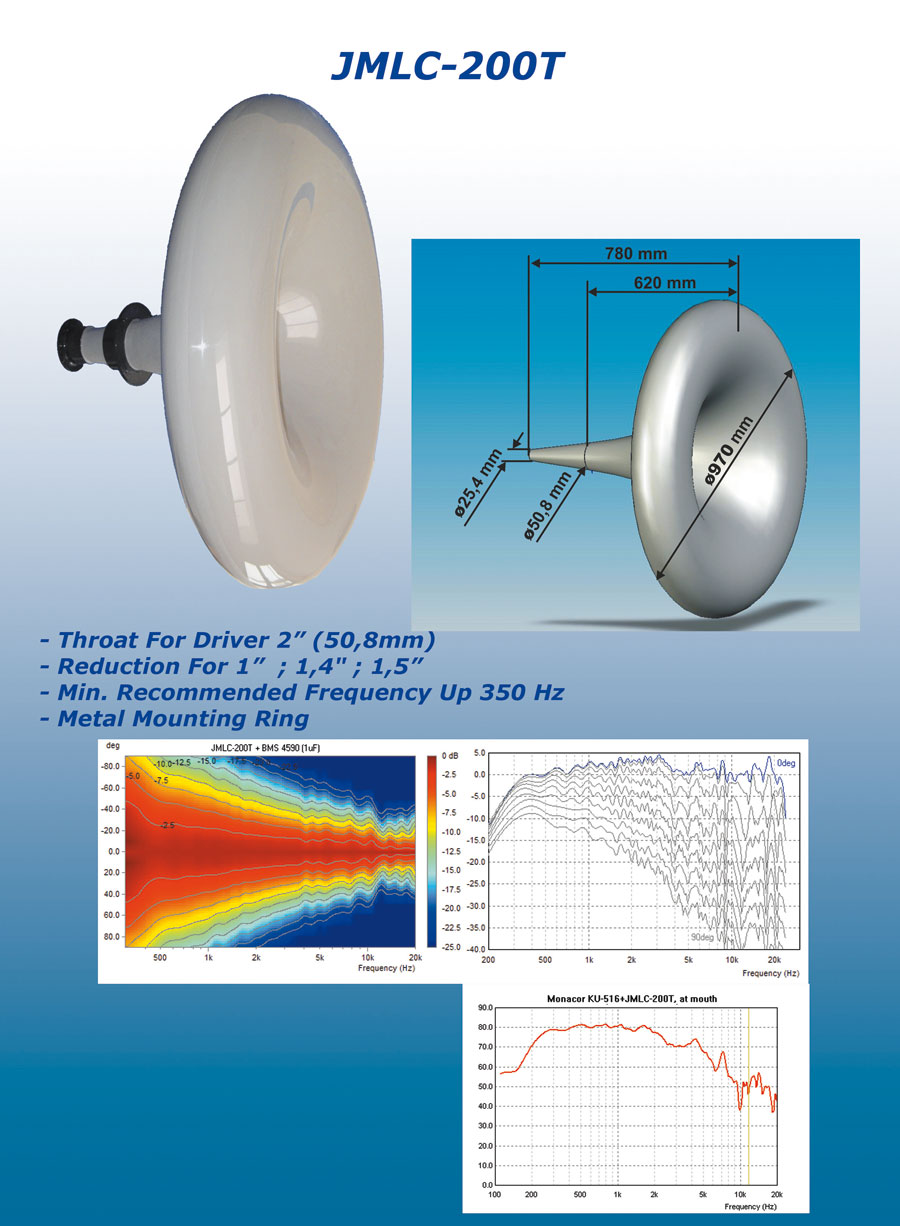

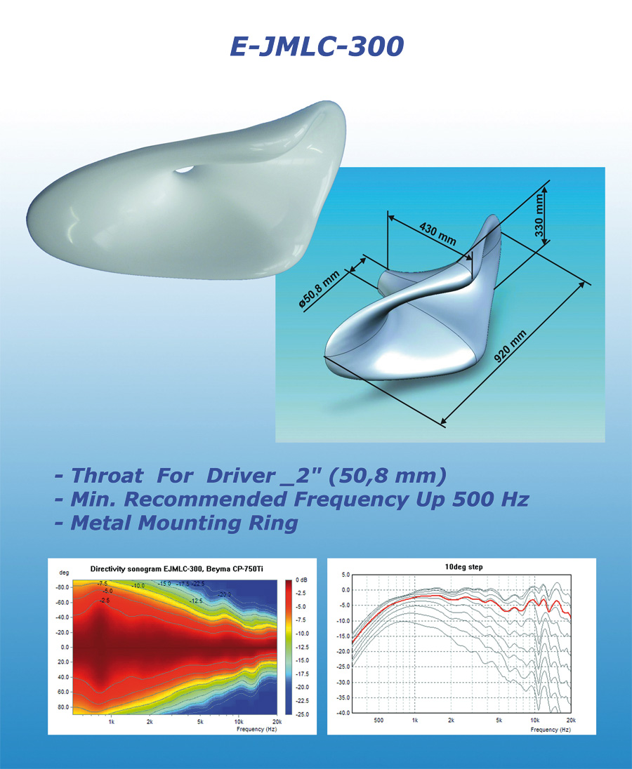

If the design plan is to add a small horn or ribbon super tweeter ~6KHz to 7KHz, (1)why not use a larger JMLC_200T horn with a 2" compression driver like the Radian 950-PB in order to get the best 700Hz lower Xover and greater dynamics? (2) Is it just the horn's physical size.... too big for living rooms? (3) OR does audio quality suffer on large horns? audio quality suffer on 2" CD over 1" or 1.4" CD?
Experts like Dr. Geddes measure excellent polar response data from a 15" woofer + large OS-waveguide 2-way Summa speaker that technically prove using a 1" mylar-suspension compression driver like the DE250 at low home SPLs can cover 740Hz to 20Khz with modest high frequency boost. It seems that Dr. Geddes believes the coherent polar response from just one horn all the way up to 20KHz is more important than the dynamics from a 3-way with a larger diameter compression driver mid-horn plus supertweeter. The JMLC400 supports a 1" CD mount. (4)Would using the JMLC400 with a 1" CD from 740Hz-20Khz with the DE250 lose too much midbass dynamics over a 1.4" compression driver like the Altec288?
