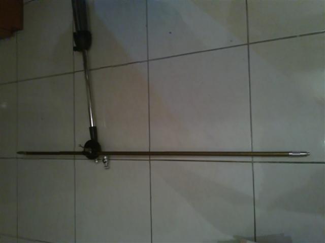

Inspired by Lynn's mic setup and Gary's mic installation mod; I finally found a way to put together a mod that will integrate existing mic and preamp with the mic stand. A brass tube relaces the original mic holding tube, on one end is the mic preamp, on the other end is the mic.
The next time I get to do some measurements, I'll post any differences I see.
