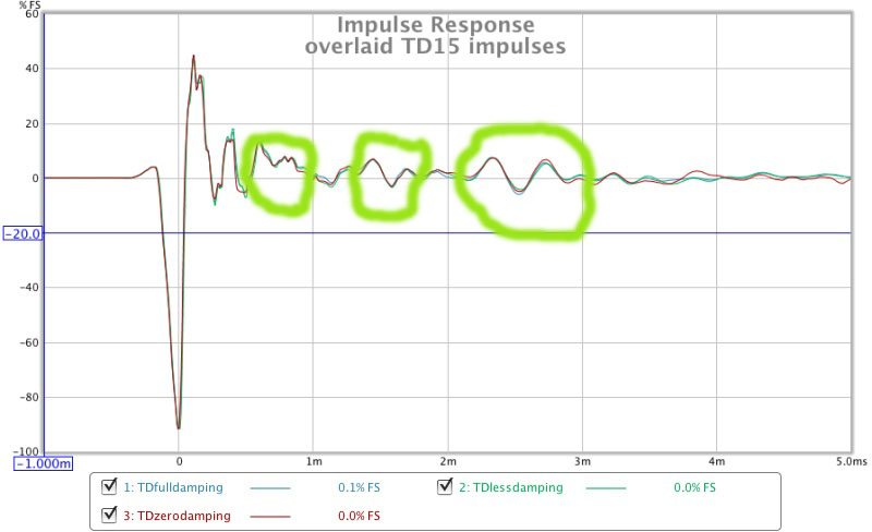

Here's the same FR Graph with a 15ms window. I changed the color of the heavily damped to black for a clearer picture.
Sure would like to see the impulse with a low pass filter, b/c according to what I'm seeing it sure looks like the damping is mostly effecting the midbass on down. The break up is always there as is the ripple in the impulse.
Here's another view of what I see as a possible issue.
A slightly damped Eminence Beta 12A polar:
its impulse response:
Further damped polar:
its impulse:
Am I the only one who sees this as a possibility?

I was wondering why there would be any response before "time 0" in the plots. This should not be possible in reality. The DUT should have no response before excited by the test signal, which is the reference "time 0".I don't see where I wrote "time zero."
Could you rephrase the question? I'm not sure what you mean. Maybe this will help.
Dan

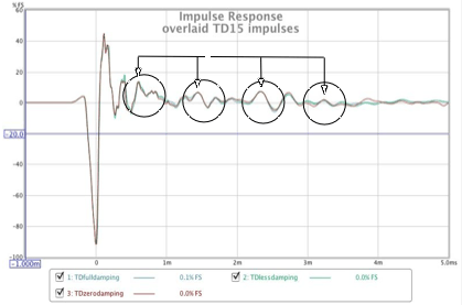

Tried a whole bunch of new experiments Sunday afternoon and evening.
1. Extended the cabinet walls rearward by setting plywood panels in place. No difference.
2. Stacked two TD15M cabinets on top of the bass unit in order to remove the top edge of the cabinet from the diffraction footprint. No difference.
3. Draped batts of Bonded Logic over and around the cabinet in order to suppress the sound wrapping around the cabinet. No difference.
4. Pulled the batts of Bonded Logic forward so the front edge protruded about six inches forward of the cabinet edges. No difference.
5. Removed the pillows and Bonded Logic from the floor in order to emphasize the floor reflection. No difference.
6. Messed with ARTA settings, returned IR parameters to default values. No difference.
7. Sat down and stared at everything till my brain hurt. No difference.
8. Replaced the DIY project speaker in the test setup with my Audio Note AN-E's. Okay, now there wasn't anything weird going on at 2.5 ms...in fact, it looked pretty clean. Set the gating and pulled up a FR curve. Looked just like the one on Stereophile's review...in other words, it sucked. Anybody wanna buy a pair of AN-E's?
9. Okay, this is where it gets really interesting. I put the TD15M back in the hot seat, set the mic right up next to the cone, turned down the level, and ran more tests. The same wrinkle appeared in the same place. So much for cabinet diffraction or floor bounce being the cause. Could it be the driver itself?
10. Lynn said that the only way to eliminate the enclosure as a potential culprit would be to remove the TD15 from the cabinet and do a nearfield measurement (~ 1 cm) in free air. I set up and ran the test this afternoon and guess what -- still there! Guess there's nothing I can do; I'm sure not going to modify the driver.
So, dantheman, I think a LP filter is in order. Seems to be relevant anyway, since the driver will be used with one in the completed speaker system.

Up until this one, I was going to say "reflection off the enclosure wall through the driver cone, try it on an open baffle". But #10 negates that.10. Lynn said that the only way to eliminate the enclosure as a potential culprit would be to remove the TD15 from the cabinet and do a nearfield measurement (~ 1 cm) in free air. I set up and ran the test this afternoon and guess what -- still there! Guess there's nothing I can do; I'm sure not going to modify the driver.
Interesting search. The fact that the delay went from 2.5ms to 1.3ms when measured from the side, makes one wonder if it's not a wave travelling out fron the center of the cone to the edge. It would be interesting to see if you see the same artifact with the foam surrounds in your bass speakers (do they have a heavier cone - better damped - too?).
Of course if you don't make the frequencies where you see it, it's not functionally important, but is fun to learn.
Sheldon
Well, if it's still there in free air - with the driver suspended from a wire - it's in the driver, end of story.
It's an odd artifact, and not what I expected. I thought there'd be lot of cone-breakup clutter gradually decaying to zero, not a discrete and clearly visible echo at 2.2~2.5 mSec (with inverted polarity, no less). Maybe a reflection off the circular frame on the front of the driver really is the cause, although the timing seems too long by a factor of two or more. Same for a reflection off the extended pole-piece, sure, I wouldn't be surprised to see a reflection, but nothing like 2.2~2.5 mSec later. A two-part reflection off the extended pole-piece, followed by another bounce off the circular edge of the frame, seems like a real stretch - besides, where's that polarity inversion coming from?
What could possibly be 15.1~17.1 inches away from the voice coil - or the microphone capsule?

Looking at the size of the driver is could be related to some circumferential mode.
Why don't you try a low pass filter on it to see if it's still an issue with your crossover in place.

After all the work I've done during the past several days, maybe I should get paid! 😉
I'm not too worried about the IR wrinkle now, because with my previous experiences with Altec 416's and 515's I already know I like the sound of a good 15" woofer, and I believe the TD15 qualifies.
I'm now turning my attention to working out a mounting scheme for the Azurahorn and Radian driver. That is, when I'm not riding the Kawasaki!
And yes, I'll get a low pass filter worked out for the TD15M.

Looked at it a bit closer, from the shape of it, it's in the driver.Well, just when we thought we had it all figured out...

Probably want to look and the CSD as well
Dare I mention BudP's EnABL?? It's ok - I'm brave - and have thick skin - and a short memory. All good qualities for a quarterback - but not necessarily a speaker designer.....
