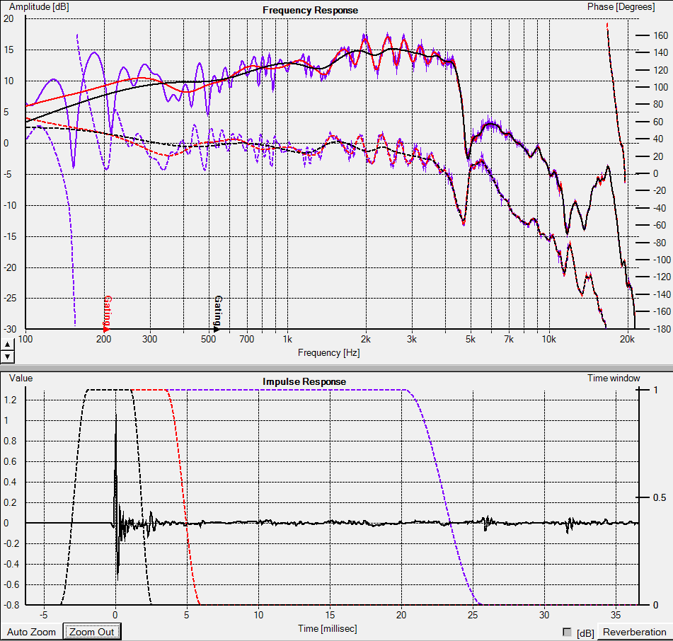

TD15M unsmoothed frequency response looks like this in HolmImpulse, with different gating before the wiggle, after it, and finally just before the first reflections. Pretty amazing, too! Note I tilted the phase up to higher frequencies in the graph to compensate the shift of acoustic centers with frequency which makes the driver non minimum-phase. HolmImpulse adjusts to the highest peak (among other options) to determine the phase, upon import.

Gary called today, and I asked him to compare the magnitudes of the first arrival to the 2.5 mSec or so reflection. The reflection is about 22 dB down, not too bad, but it would be nice to remove it, if possible.
Interestingly, the reflection is inverted relative to the first arrival. In my experience, floor bounces and wall reflections are the same polarity as the first arrival wave, which begs the question of where it is coming from. It could be from the rear wall; the timing is about right, and the wave from the back of the woofer is of course inverted. Gary mentioned the magnitudes of the 2.5 mSec reflection are about the same with or without the Bonded Logic damping pads, which is odd, since most of the energy of the impulse is at high frequencies, and that's also where damping fill is also most effective.
Time to change approaches. There is a possibility the "reflection" is actually diffraction off the rear of the cabinet - the timing would be about right. So, while we talked on the phone, I suggested that Gary do another set of measurements - keep the microphone right where it is, but make another two measurements, rotating the cabinets first to 90 degrees, and then 45 degrees. If it really is diffraction, the timing between the first arrival and the "reflection" should be substantially altered - for the 90 degree rotation, the time delay should be cut in half. I told Gary to look not at the main group of clutter, but compare the rise time portions of the first arrival and the "reflection", and work out the delays between the two. If the delay significantly changes with measurement angle, it is on the outside of the cabinet, not the inside.
Guess what - that's what happened. With the speaker rotated 90 degrees, the "reflection" now arrived about 1.3 to 1.4 mSec after the first arrival, although both are significantly low-passed by the 90 degree off-axis measurement. The 45 degree measurement is essentially buried by clutter, making estimation of the delay difficult.
My best guess is the artifact is indeed a diffraction from the rear edge of the cabinet, which is a much sharper edge than the front radiused corners. I suggested two approaches to Gary: half-pipes to round off the rear edges, and/or covering the sides and rear with thick felt. The effectiveness of these approaches can be compared by looking at the magnitude (and timing) of the 2.5 mSec artifact. I am doubtful it has anything to do with the driver, which would have to have a very large frame in order to produce a reflection that much later than the first arrival.

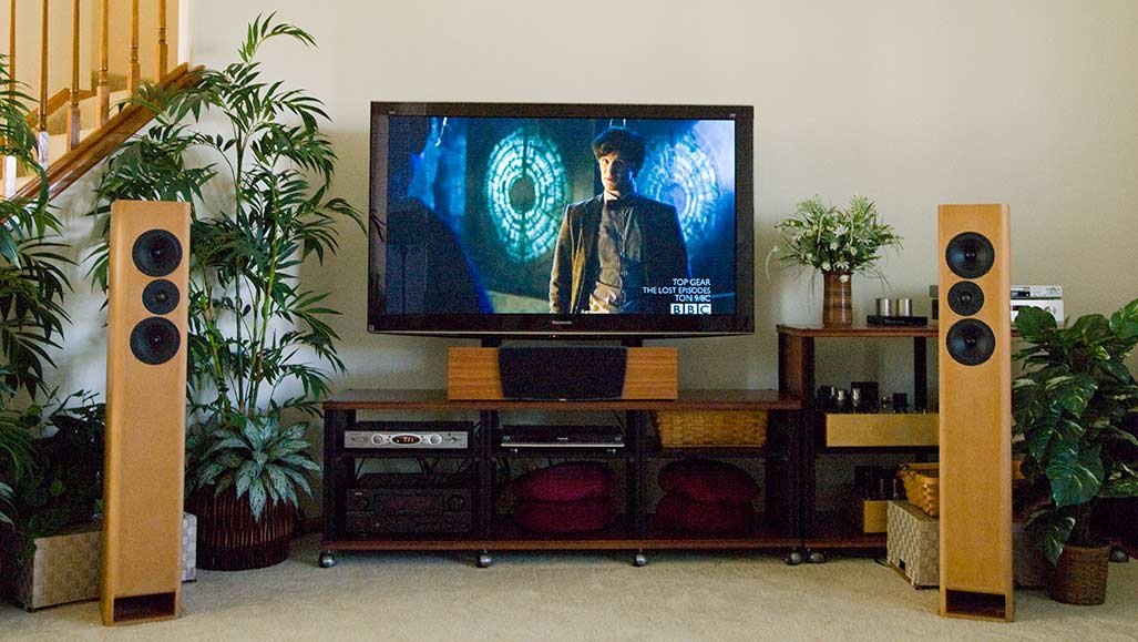

My postings have a been a little quiet recently - for the last week, I've been very busy with re-doing the HT system, which entailed a complete tear-down and re-building of both audio and video systems. In North America, we don't use SCART video connections, so the old system was a maze of composite (NTSC), S-Video, Component (480i & 1080i), digital audio, and analog audio connections. Now there's just one set of Component connections from the Comcast DVR, while the new items use Atlona HDMI 1.4 cabling. I'm already getting acquainted with the little handshake quirks of HDMI - it's a little too smart for its own good, like the player refusing to accept a disk if the TV is turned off.
New stuff: Panasonic TC-P58VT25 1080P 3D TV, Panasonic DMP-BDT300 Blu-Ray player, Dynaudio SC X center speaker, and assorted Salamander rack systems. The now-antique Denon 2805 is pre-HDMI, only has optical and coax digital inputs, and as a result, does not support SACD, DVD-A, and the new lossless Blu-Ray audio formats, which exceed the bandwidth of the old S/PDIF transmission format. So it is next in line for replacement, along with an OPPO player to supplement the Panasonic BDT-300, which annoyingly does not play SACD or DVD-A audio discs. The OPPO will probably end up being the transport and disk-spinner for the all-triode side of things, along with the capability to play 1080/24P Blu-Ray and scale-up legacy DVD's.
Projectors? Not until I build a dedicated video room in the basement - a project many years away, if ever. In the meantime I can enjoy 3D Blu-Ray discs - the German disc has a very good 3D effect, by the way, more natural and realistic than Avatar. The next immediate task is finish the changeover switches for the Ariels so they can switched between the HT amplifier and 300B triode system - the crossovers are lurking under the wicker baskets, and need a rebuilding so they look better, are more robust, and have the four-pole, double-throw changeover switches installed. (Grounds need to be switched as well as signal, so the two sets of amplifiers are never cross-connected.)
Here's the Before and After pictures:
