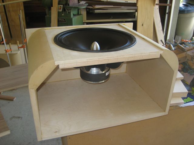

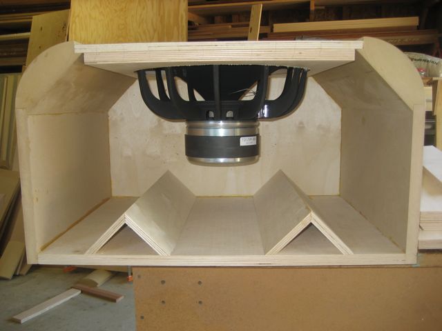

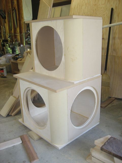

Changing gears, here's some photos from Gary Dahl. The slight inset on the front panel is room for the grille frame (something I won't be doing). The lower cabinet for the TD15H shows the left and right-side placement of the paired PR-700 passive radiators, along with the possible degree of offset for the TD15H required to keep an in-phase relationship on the 0.5 overlap portion of the crossover (the 200~300 Hz lowpass introduces a delay with respect to the TD15H wideband driver, and the exact amount of delay is not yet known).

Hello Lynn and all, good to see this thread got back to life!
I was looking at the pictures posted and I see that there is a significant edge rising just before the rollovers. I guess the purpose is to have some kind of grills fixed on that edge.
Now, won't that edge effectively minimize the advantages of those nice, big roundovers? I mean, I almost can imagine diffraction occuring on that sharp termination 🙂
By the way, I like the project a lor, even if it's more conventional. I look forward to the outcome and to V2. 🙂
Hi SunRa,
Not sure exactly which edge you are referring to, so I will explain a bit more about the design.
The notches in the MDF corners are 3/4" deep. A front panel of 12 mm Baltic birch is set into these notches, leaving about 1/4" of remaining depth. The grill frames will be made from 1/4" fiberboard. When these are in place, their front surface will be flush with both the driver and the MDF corners. Neat, huh?
The panel has a 15.625" hole, about 1/16" larger than the woofer's frame. A second panel of 19 mm Baltic birch is glued behind the front panel, with a 14.125" hole. The woofer gets mounted to the inner panel.
You might have been referring to the corners of the top and bottom panels, which currently protrude beyond the rounded MDF corners. After they are all glued in place, I will trim them flush with the MDF corners with a router.
The side-mounted passive radiators won't have grill frames. They will be mounted to inner panels as well, set behind the 3/4" MDF side walls. This will leave the passive radiators approximately flush with the cabinet sides.
Next steps in construction will include installation of the remaining inner mounting panels for the drivers and more internal bracing. Then the tops will be glued on, and the corners of the tops and bottoms will be trimmed. After surface preparation is complete, the cabinets will be finished with black Duratex.

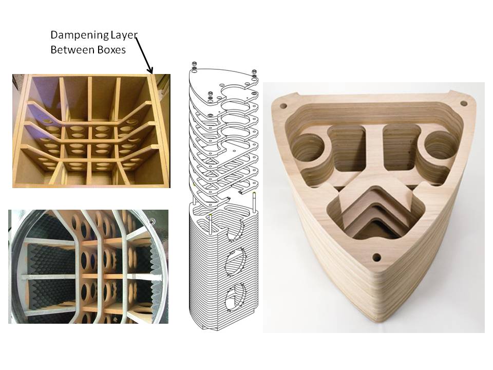

To simplify, there are 3 things that can potentially be issues with cabinets. Physical panel resonances, standing waves, and the direct reflection off the back of the cabinet back through the driver cone. The first thing is to properly brace the cabinet putting any physical resonance well above the intended range the cabinet will be used over. The closer the braces, the higher you push this resonance point in frequency. Secondly you want nonparallel surfaces and unequal distances to help avoid standing waves from developing. This can be as crazy as fully irregular walls to as simple as a brace at an angle behind the driver. The more irregular the better, however absorption inside the cabinet also helps to eliminate these issues. Finally you will want to redirect and or absorb any sound that may be coming from the back wave of the driver. Heavily packed insulation can do ok, but a soft polyurethane foam often works best for this.
Actually I have a thread on this..
http://www.diyaudio.com/forums/multi-way/80899-voodoo-vibration-loudspeakers.html
I'd also note that standing waves (or modes) in a cabinet requires that both the cabinet volume is relatively large AND that the driver is being used higher in freq. (..midrange). Though of course the 12M is being used in precisely this manner.

Stuffing density distribution also makes a significant impact.To simplify, there are 3 things that can potentially be issues with cabinets. Physical panel resonances, standing waves, and the direct reflection off the back of the cabinet back through the driver cone. The first thing is to properly brace the cabinet putting any physical resonance well above the intended range the cabinet will be used over. The closer the braces, the higher you push this resonance point in frequency. Secondly you want nonparallel surfaces and unequal distances to help avoid standing waves from developing. This can be as crazy as fully irregular walls to as simple as a brace at an angle behind the driver. The more irregular the better, however absorption inside the cabinet also helps to eliminate these issues. Finally you will want to redirect and or absorb any sound that may be coming from the back wave of the driver. Heavily packed insulation can do ok, but a soft polyurethane foam often works best for this.
John
I agree. I will be using Bonded Logic UltraTouch R-13. Some experimentation will most definitely be in order.

One of the challenges is how far you can go with the top/bottom mode, which is the toughest to deal with in most constructions. With vented constructions the difficulty increases more because you can't overdamp the box volume and still have usable vent output (though I'd say that damped box tuning is an underused technique). I'm using a half-cylendar with those same "L" edge rounds (4" dia), and will have a stuffing chamber- about 4" of Ultratouch at the bottom, constrained between two shelf braces (with windows, roundovers on all exposed edges. I also used some layered materials to break up the surface of the top panel (as well as stiffen it) so I'm hopeful that I can leave the rest of the cab fairly minimally damped and keep that one significant mode suppressed. The rest of the cab is a 3/4" shell, with ribs of 3/4 stock, which are coupled to the shelf braces.
