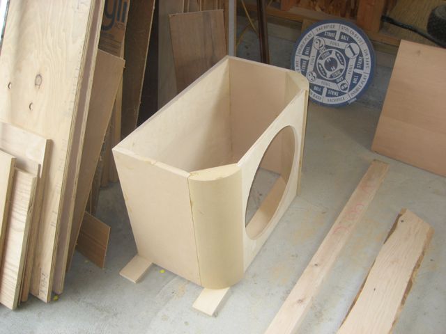

Here's a pix of the upper TD15M enclosure:

What isn't shown in the picture are the methods Gary and I are discussing to break up the front-to-back mode and stiffen the enclosure at the same time (basically, large V-shaped corrugations made with sections of 1/2" plywood). The big reflection off the back wall is by far the most objectionable, and we are taking steps to attenuate and diffuse it (spread out in time). MLSSA and ARTA will come in handy for looking for these 1~2 mSec reflections and seeing how successful we are in attenuating them. They will not be swept under the rug.
Looks familiar😉 Those corners are great to work with.

Lynn, did you hear Gary Pimm's new version with the single 8 and the new woofer box, or the older with dual 8s? He had just finished the new version when I left Portland.

looks like products offered from that place in Los Angeles
Yes here's a link to where I purchased mine.
Rob🙂
Curved Plywood, Dieboards, Drumshells Aitwood Home
Rob🙂
I think Rockler used to carry them, but the last time I went looking for them there I couldn't find them.
