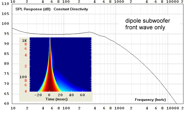

Hello Panomaniac,
Here is the frequency response of the simulated subwoofer (actually this is an Infraplanar as the one used by Marco Henry in the to complement the 2010 version of La Grande castine) just using the front wave.
See attached file.
Best regards from Paris, France
Jean-Michel Le Cléac'h

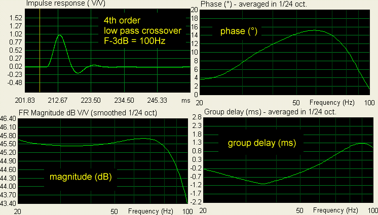

Hello Earl,
Your explanation is OK for me as long as we don't ask the woofer to reproduce frequency at which the wavelength becomes short.
In order to see what happens at low frequency, I filtered the simulated Impuse response of the dipole (front + rear wave with a difference of path of 1 meter) using a 4th order low pass filter of the 4th order with F-3dB = 100Hz.
You'll see in attached file both, the shape of the pulse, the frequency response, the phase curve and the group delay curve (from ARTA).
Wish that measured real system could behave the same in the low frequency! (group delay variation lesser than time equiavalent to the difference of path between the rear and the front wave, very few phase variation, excellent frequency response.)
At very low frequency the wave drag along the baffle and turn around the baffle edge but from which frequency can we say that the rear wave of a dipole needs a reflection on a wall to interfer with the front wave...(if we consider the directivity of the piston, it should depend on the size of the OB I guess).
P.S.: that dipole subwoofer is Claude Lacroix's Infraplanar.

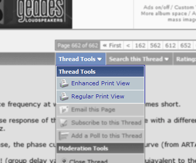

So how would you do that? I mean, can you download the entire thread at one time without going page by page using a screen capture program?
Hi John! All members with donation benefits (such as yourself) have access to the "Enhanced Thread Print" function. The details are on the donations page (diyAudio - Donations).
The Enhanced Print View was developed to meet the needs of diyAudio members who require more functionality than the standard vBulletin thread print offers, specifically the ability to easily print (long) threads, easily print threads with all images (such as schematics) and to save all the images in a thread to your computer.
It looks similar to the regular print view with the following differences:
* The number of posts on each page defaults to 100
* You have the option to view ALL posts on one page. This gives you the flexibility to use your browsers "print preview" and "print range" options to print a whole thread in one go, or any range of pages therein. It also lets you easily save all the images from a thread (see below).
* Attachments are resized to an 800 pixel wide "facade" by your browser so they look pleasant and are of manageable size while you browse, but print in full detail (as the original files are actually being linked/used)
* External images appear on the page instead of appearing as links
* Because all images appear on the one page, you can easily use DTA or Firefox (just go to [Tools]->[Page Info]->[Media] and use shift-click to "select all") to save all the images from a thread in one go.
