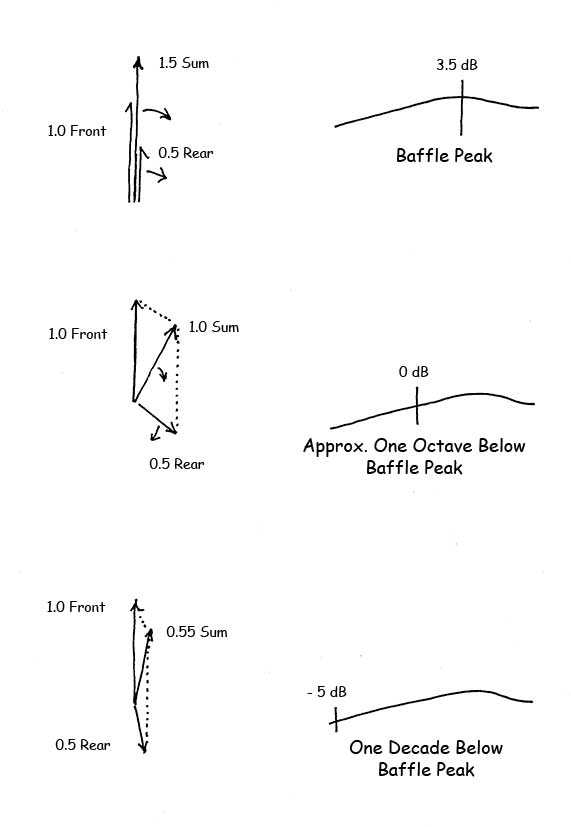

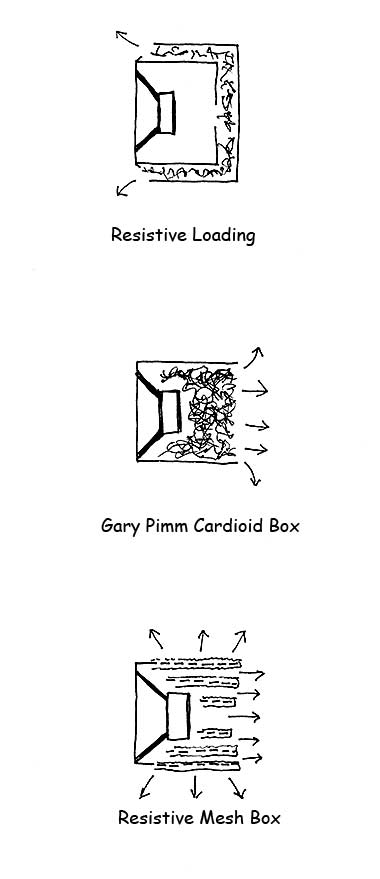

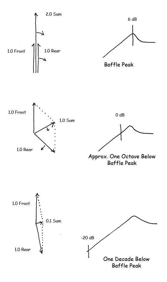

Would an increase of the front radiation have the same effect?
Yes. The problem is the magnitude of the front and rear phasors are equal, leading to deep nulls at zero frequency and at a number of comb frequencies above the dipole peak. I've made some crude sketches that show the vector relationships of an open baffle compared to a 6 dB resistive-mesh absorber.
The first (left) diagram shows the vector magnitudes as voltage relationships between the front and rear waves at a large distance (several meters) directly in front of the baffle. Notice the magnitudes are equal; the only thing that changes is the phase relationship. As the frequency moves downwards, the fixed transit delay from the center of the driver to the edge of the baffle becomes a smaller and smaller portion of the emitted wavelength. At very low frequencies, say, 1 decade below baffle peak, the front and rear waves are almost completely out of phase with each other, requiring substantial equalization if flat response is desired. In practice, diffraction attenuates the rear wave, but this is only significant at higher frequencies, primarily above baffle peak.

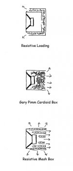

The second (center) diagram shows the vector magnitudes of a resistive mesh behind the driver, and for simplicity it is assumed that it has a frequency-independent loss of 6 dB. With practical acoustic absorbers, absorption is greatest at mid and high frequencies, and decreases at lower frequencies. Note that the deep nulls no longer occur, because the front and rear magnitudes are unequal, thus preventing total cancellation. The baffle peak is smaller as well, due to the decreased magnitude of the rear wave. In practice the baffle peak would be quite a bit smaller, possibly as small as 1 dB, because real-world absorbers have much better than 6 dB absorption from 500 Hz on up.
There is a continuum of possible ways to attenuate the rear wave, ranging from:
1) a totally absorbent infinite baffle (the classic mount-the-driver-in-a-door-to-another-room approach)
2) various types of resistive-vent boxes, such as the Dynaco A25 and the Planet10 Fonken
3) the Gary Pimm open-ended cardioid box
4) the proposed resistive mesh, a series of concentric mesh cylinders that are open at both ends and covered with thick felt
5) flat open baffles with no attenuation for the rear wave, ranging in size from large, door-sized panels to hanging the bare driver from strings
Sorry about the crudeness of the drawings and the math - I'm sure the figures are off, but the trends are there, and at the limit, this is how the systems behave with ideal drivers. Above the baffle peak the phasor for the rear wave spins around in the other direction, creating multiple 180-degree nulls and the comb filtering shown in Michael's simulations and measurements.
