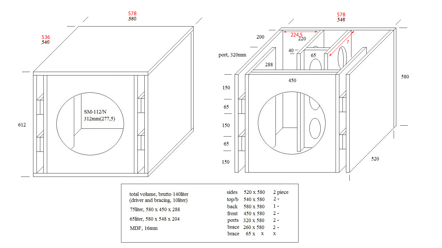

I think this is it
coming cutting plan will show if there minor errors
but I say this is the one
finished
do you like it ?
one last small correction is still possible( if needed due to space or whatever)

cutting list added
feel free to play 'find an error' 😀
I will try to come up with assembling plan
feel free to ask, any time

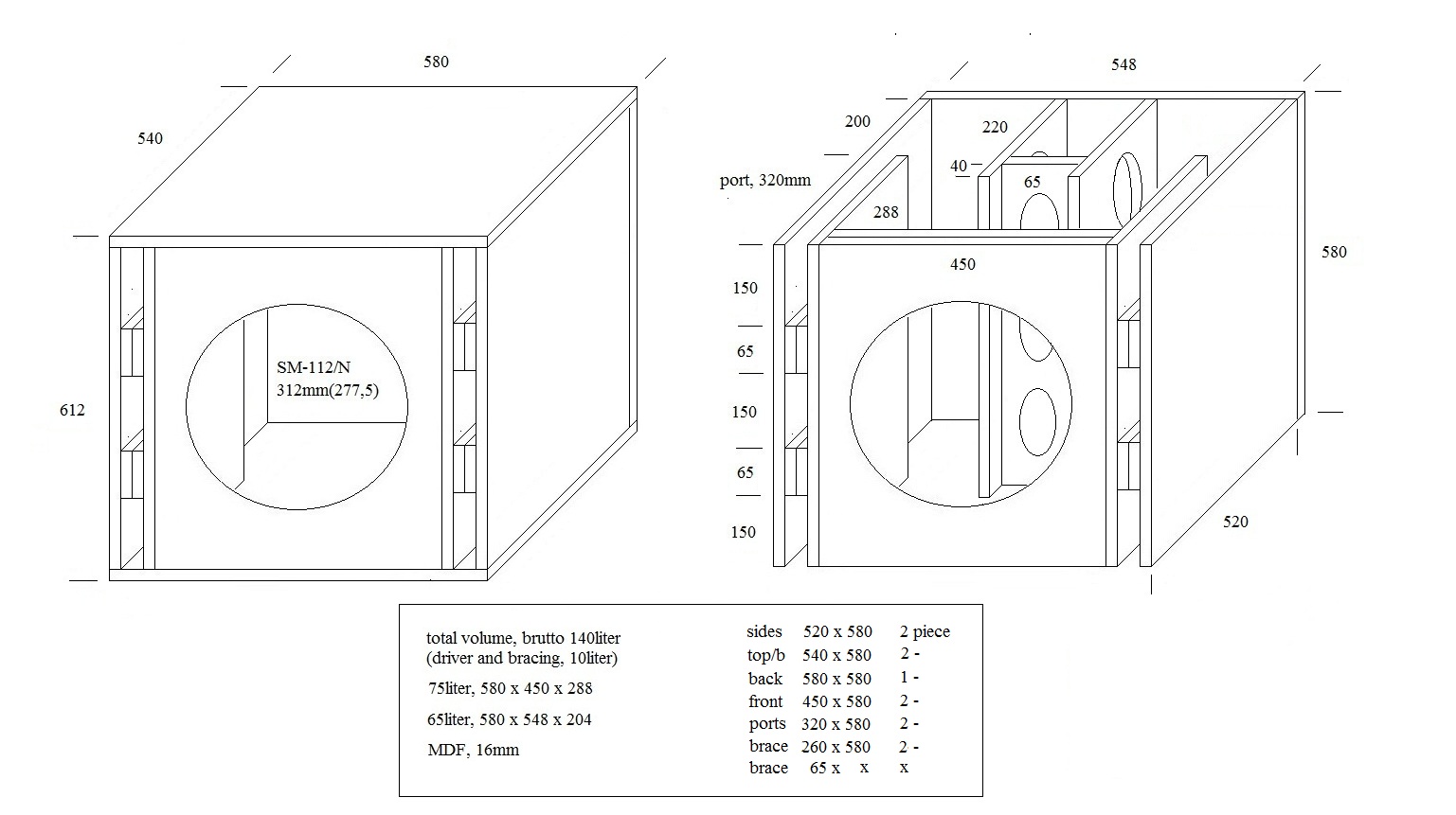

I've got a couple of questions,
Please check if I corrected the dimentions correctly
Other question is where should I place the breakout to speaker connector ?,
and should I add a passive x-over, I don't have one ?
I'm glad to see you checked carefully 😀
I left those slightly bigger intentionally
might be less once assembled
for one, the number 'depend' the summ of several other
and adding glue etc etc 😉
anyway, its really bad if too small
better to a milllimeter to shave off when finishing
and, you may notice the number 580 is mutual for almost all cuts
means they are all equal and fits each other, because the saw havent been changed(maybe)
anywhere on the back is the usual place
why passive ?
are building one or two ?
and what are your other speakers ?
sorry, some of the numbers and measurements are inside measurements
hould have been removed, or replaced
they were for myself only, to make the calculations easier
I fully understand if the right drawing have been confusing you 😀
left one should be correct
and match the cutting list
but please just ask
better than making mistakes

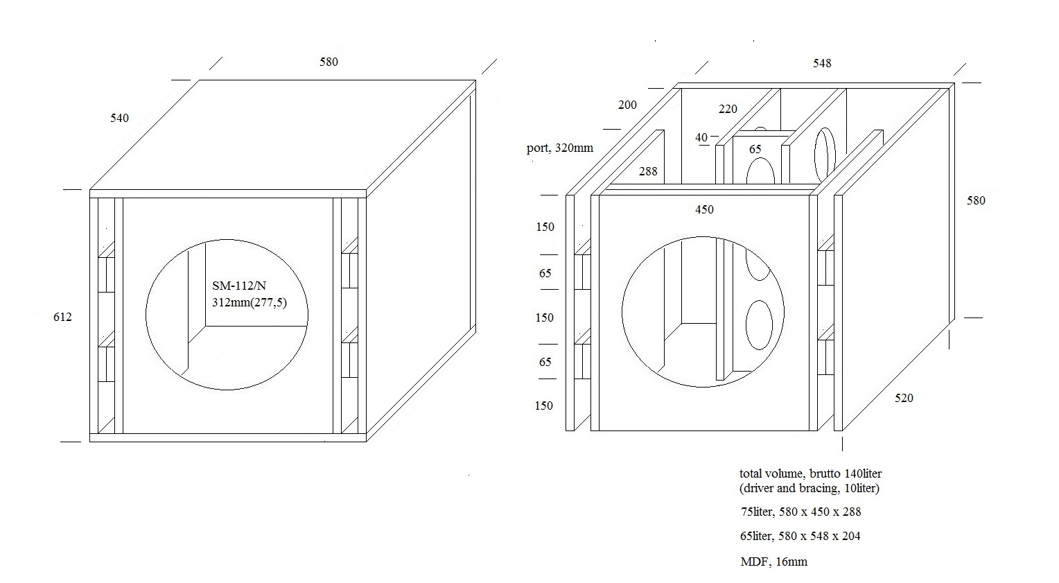

regarding the numbers you corrected
if you want them to match 100%, you may have to cut them after assembling the other ones
starting with front, ports and sides, with the bottom
then the back panel, and its bracing
finishing with the topplate
but just one tenth of a millimeter too small will look really bad
always make it two tenth bigger
for you it have been 2 millimeter instead of 2 tenths 😀
