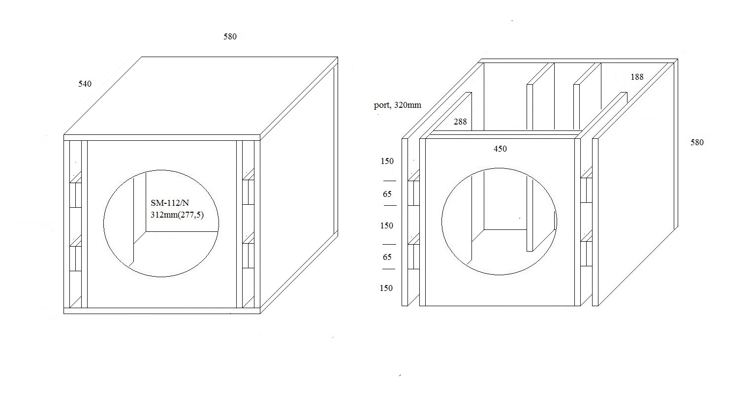

you do understand the drawing ?
and know how to do it, so far ?

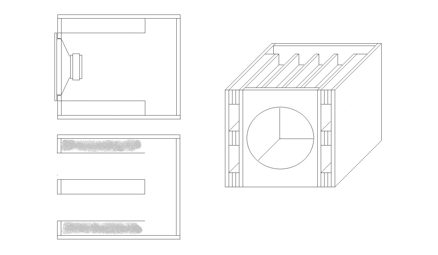

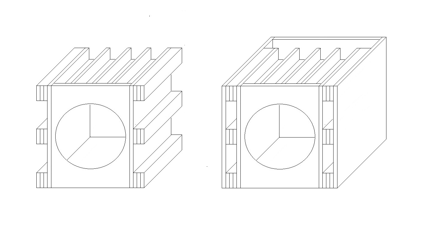

Interesting bracing scheme
Interesting idea of using external bracing, and the bracing being used to form ports.
Are the spaces between the top and bottom braces included in the internal volume of the box?
It is hard to tell from the drawing.
Just wondering if the passages that would exist, if they are included in internal volume, have a resonance that could be excited to create higher harmonic resonances.
The resonance would probably be very high compared to the passband of a sub, but I wonder if they could create single note "ting".😱
If they are included in internal volume, or even if not included, maybe some stuffing would benefit the performance in several ways.

If they are included in internal volume....(edit)...... maybe some stuffing would benefit the performance in several ways.
yes, stuffing also 😉
might consider them like volume buffers, when it gets tough
or since they are between the ports(left to right), maybe they could even do some form of symmetric port balancing
but its probably rubbish, I dont know 😀

side view of ports, and 'air-traps' with stuffing

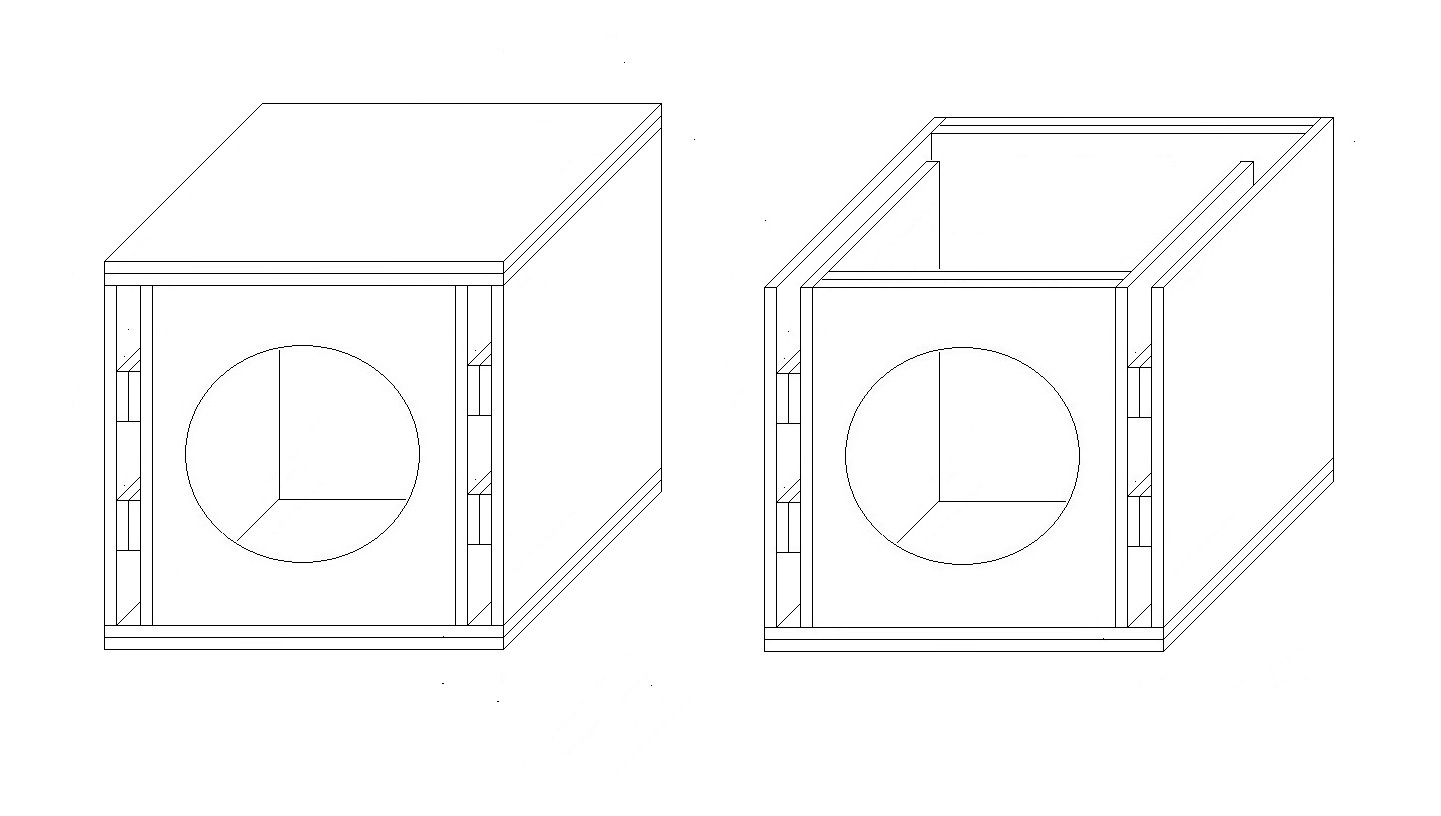

changed to 6 ports instead of 4
results in more available volume
also makes it easier to assemble

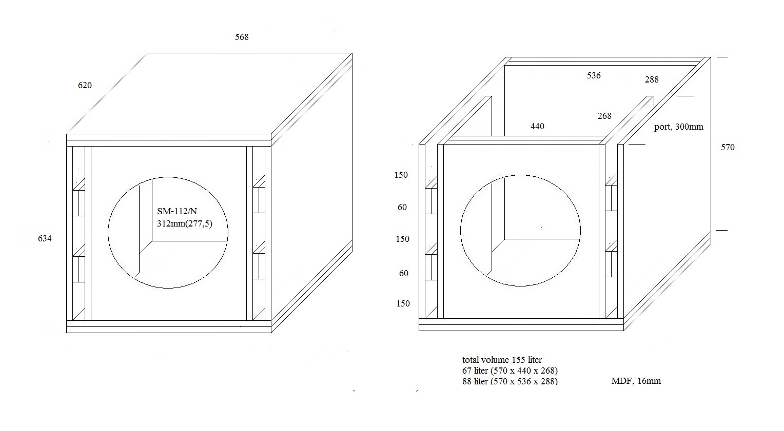

now measurements and cutting plan

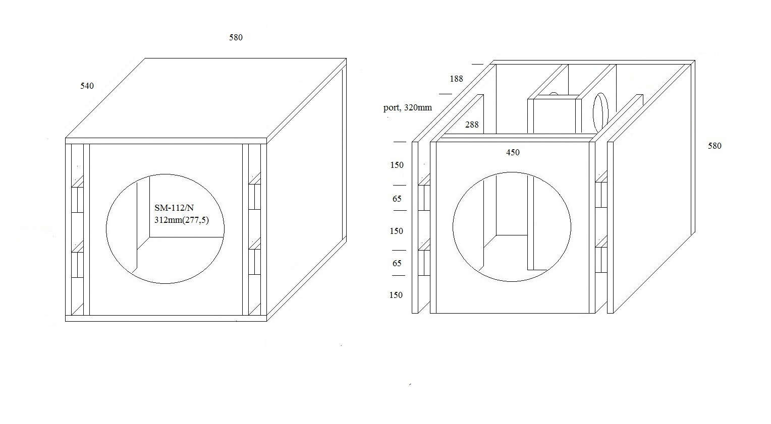

shoot, forgot bracing on back panel
if you want to have the woofer countersunk, it could be done by adding another front baffle ?

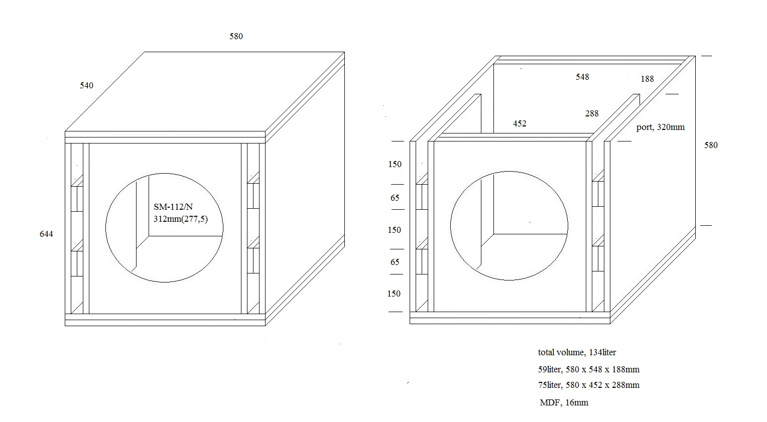

.......could be abit higher or wider.
can be about 500mm deep, with present hight and width
but could be about 450mm deep, if you like
if so, would you prefer wider or higher
no problem at all, your choice 😉
