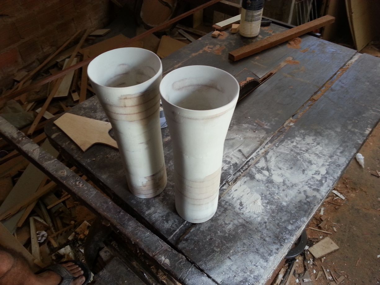

Beyma 12P80ND + TPL-150

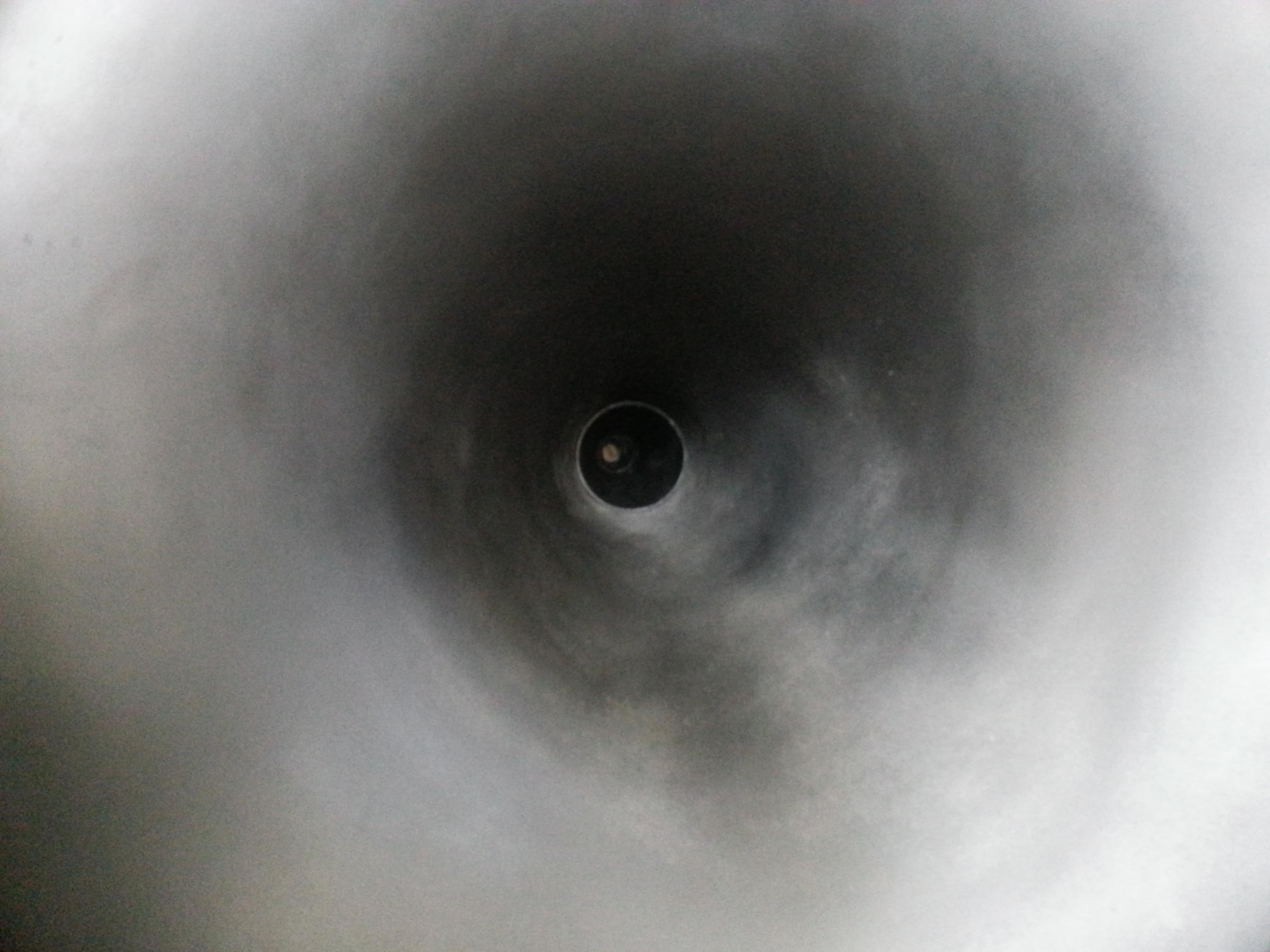

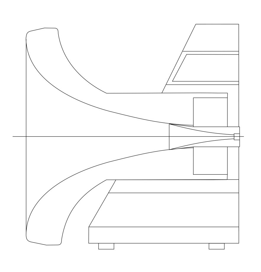

The horn has a overall length with the adapter, 'till the throat, of 96cm , and 90cm mouth diameter.
I listened music yesterday just for a short while. First impressions are good, it seems to sound natural, very precise and controlled. Will tell more later.
the dip at ~ 150hz is a mistery to me......

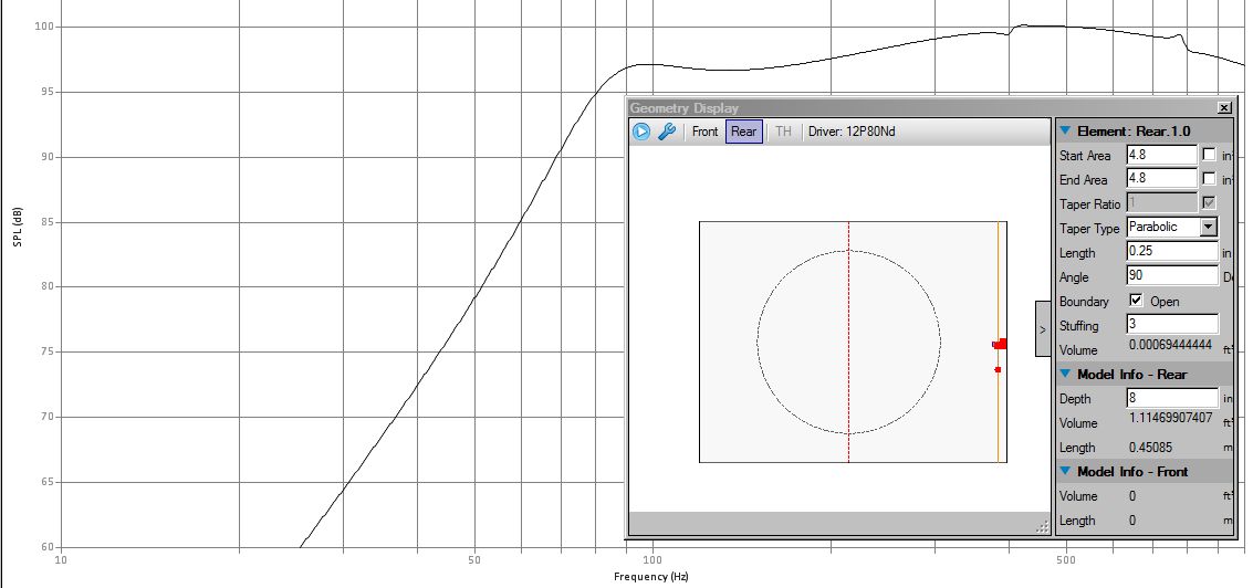

So, how do we reach 80Hz with the Qtc=0.15 Beyma 12P80ND while delivering excellent transient response?
1) Reasonable volume (2+ cu ft) well stuffed sealed cabinet with electronic equalization and electronic Xover. Probably best. Simply beat the 12P80ND to the desired SPL shape.
2) Small volume (1.2 cu ft) with on-wall absorption material plus a small aperodic vent. Allows passive Xover option.
3) Some type of transmission line or tapered tube?

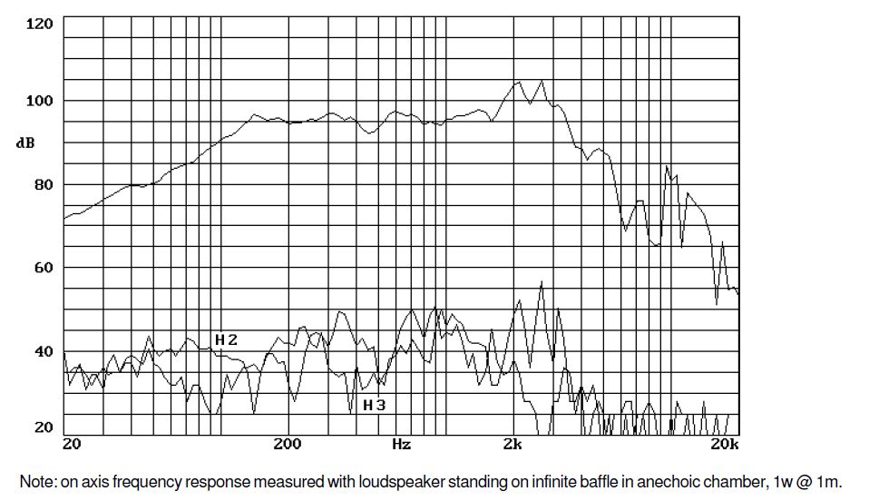

The Beyma factory SPL plot shows a break-up type bump-up above 1.6kHz.
Alternative 3 is probably the better one, especially for transient response. A MLTL or TQWT.
With that motor strength, probably 1 cu ft sealed would do, and then beat it into submission with EQ.

Wondering about the cabinet used: any drawings ?

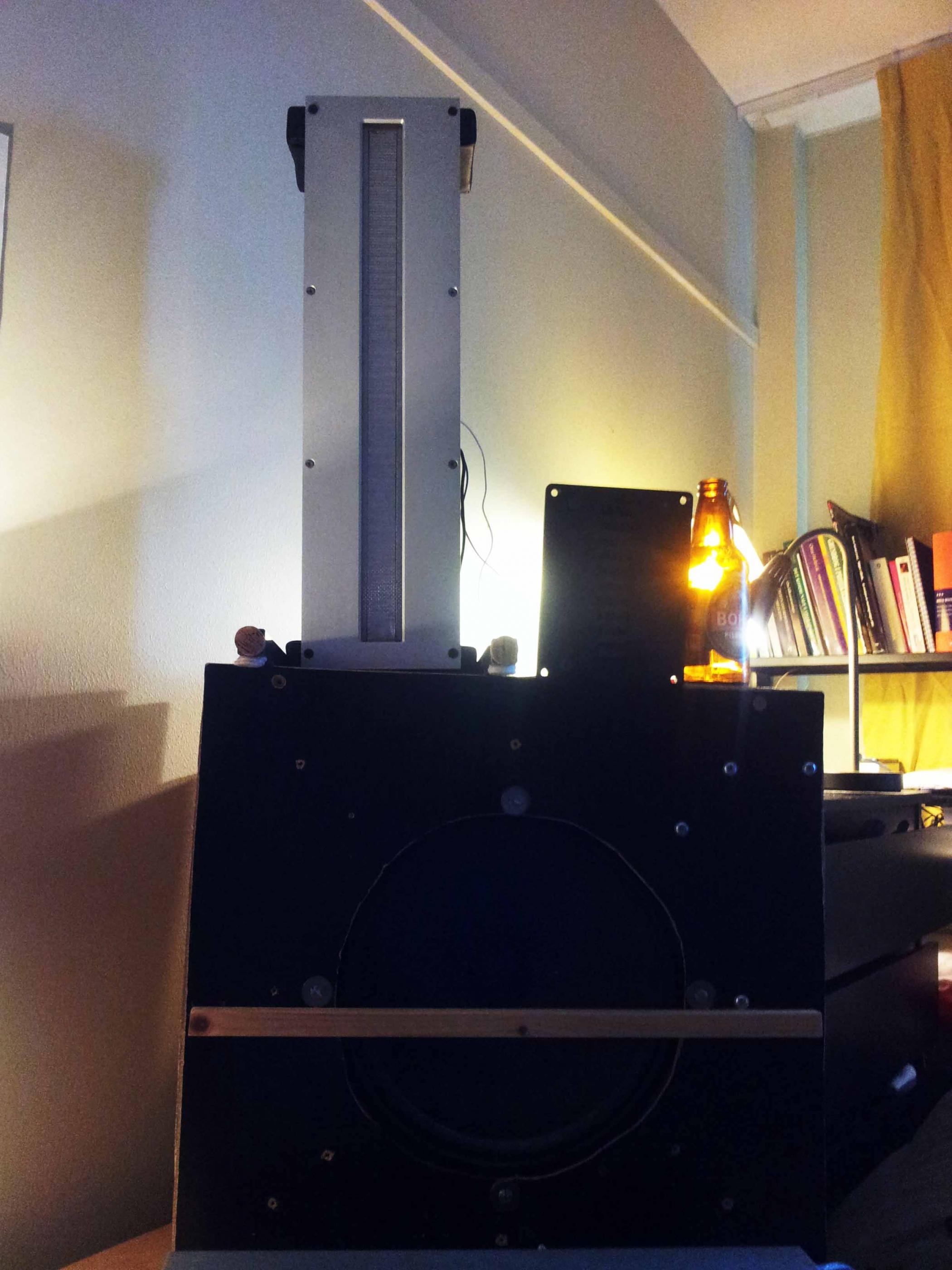

I am testing out the Beyma TPL-150 with 17uf Jantzen, 1st order + 12" Celestion Vintage 30 (favoured by guitarists) with line level low pass FMOD by Harrison laboratories. They are equal in sensitivity, which is practical.
After 5 minutes.
First impression - like ******* in the wind.
It is getting warmer now, and so is the tone, but still not close to the new Beyma 1" CD's on the emotionally intense slow songs. Guess this will be a six way, and not a 5 way. But a lot of badly recorded songs with too much noise just became listenable. And a violin solo does not cut in my ear anymore. Nor when females sing about stuff that ends with -s.
Examples:
"Eric Clapton - Preludin Fugue": First half just became listenable with the TPL-150. Second half og guitar licks lack the intensity I am used to with my 1 " CD's. It is difficult to describe. Slightly less involving, but it sounds good.
"Gerald Albright - Say Yes": Cheezy sax music that ofc involved me more with a Beyma 1" CD.
After 45 minutes...
"Gary Burton - Blue in Green": This is such a gentle song that I can't hear a difference almost. The song lacked intensity since before, so no need of a CD.
After 1 hour.
"Hugh Masekela - Abangoma The Healer": This is the trumpet song where I expected the CD to win. I have heard this song so many times with numerous CD's, yet the TPL-150 has something new to show me in the level of detail it produces. And intensity/dynamics is not to bad either.
The TPL is in need a of seriously dynamic and detailed midrange speaker. Not sure a 12" will cut it. My 12" did not, but that was expected.
After 2 hours.
Negative surprise. TPL-150 is bad at playing cymbals. *bringing out the 50 cm true ribbon supertweeter*
After 5 minutes.
Examples:
After 45 minutes...
After 1 hour.
After 2 hours.
After 3 hours.
Been hearing a lot of old tunes now. I keep expecting my ears to hurt at certain parts of a song, but they don't. It is excellent. Just clean and nice music.

Example simulation of 12P80Nd in an aperodic ported cabinet showing the modest bass shelf to extend a Fs=45Hz, Qts=0.15 speaker down to ~80Hz.
Room gain which can complement a bass shelf sometimes plays a role in getting a flat response at these midbass frequencies.

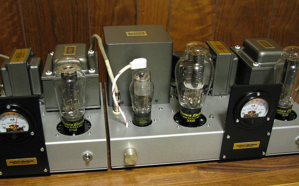

A question to the TPL users. What amp is best to drive it?
I have drived it with 3 different amps.
Viva Solista Tube amp : shy treble.
Hiraga Le Monstre : the best amp to drive tpl. Unfortunately , too little power ( thats why i sold it )
Classé Audio DR3b : too much treble, and harsh.
Next amp, i will try, is a 300b based tube amp.
amps that might combine well : Satri Bakoon, and First Watt.
What i like of the 12p80nd over the LM555/38", is the low frequency extension. It sounds more integrated. But is also more natural. And wider disperson / matching with TPL. The LM555 sounds more precise, more defined, detailled. I will keep both, but work in the next few months to optimize LM555, and try to get out the best of it.
