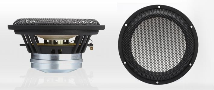

The new ceramic cone Accuton NdFeB midbass and small bass speaker have an interesting motor. There are inductance reducing shorting rings on the pole piece. Titanium is used for the voice coil former. A paper cone version would be interesting. Probably what I would build.
Attached a few T/S parameters for 8" speakers. I have the Tang Band W8-1808 in a 50" tall MLTL in our bedroom. I have a few dream T/S specs for an 8" midbass that can cover 80-1400Hz... probably with a phase plug... never with a whizzer. The polar response for an 8" above ~1400 does not fit "my plan" for smooth controlled directivity functions.

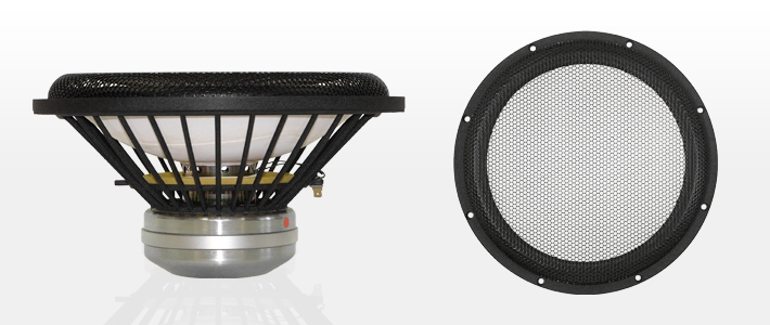

Other nice 8 inch drivers
Hi LineSource,
Nice table of dream team there!
The 80Hz to 1,600Hz / 1,800Hz band is soooo tough to get right. With the Beyma TPL covering the top you need something specialto match it below crossover. I agree, 8 inch drivers are the best all round compromise to cover this frequency band.
http://www.phlaudio.com/datasheets/20_pdf/2520_2530.pdf
and
http://www.phlaudio.com/datasheets/20_pdf/2460.pdf
are all great sounding drivers, expensive but really worth the money, they sound so alive and natural and all PHL are bullet proof build quality.
Check out the Mms to Bl ratio....Wow, the 8 inch dedicated mids are unique pieces of engineering.

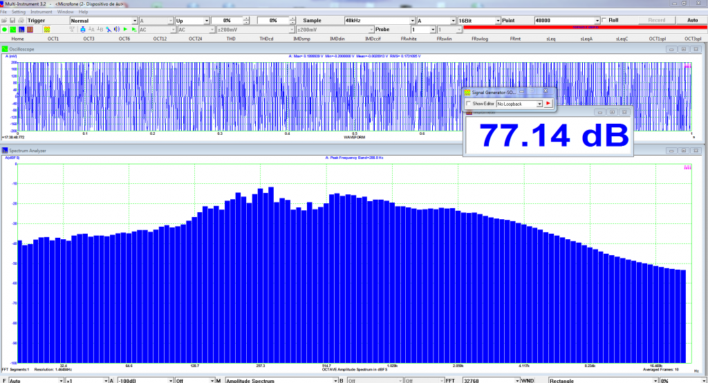

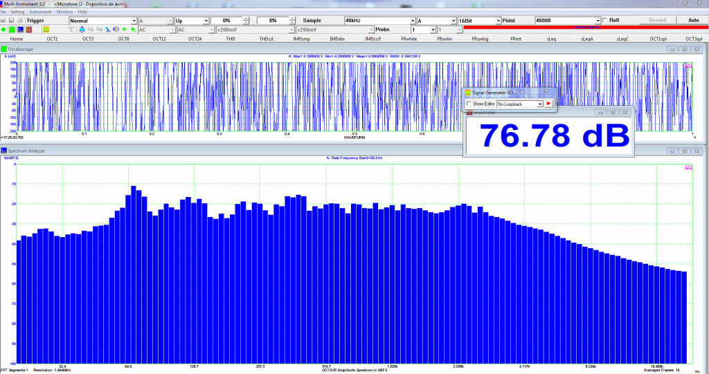

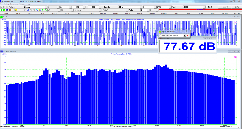

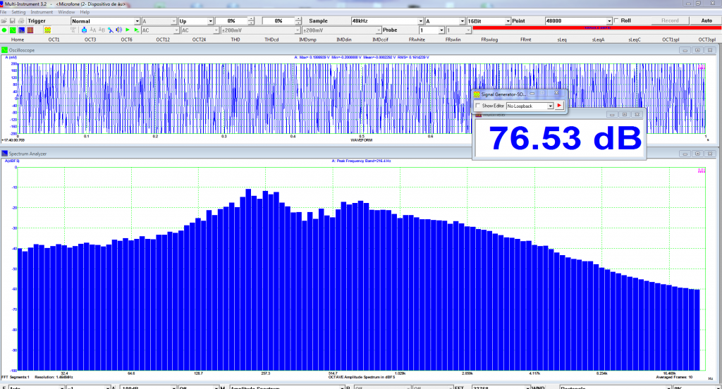

Today i hooked up for the first time the Line Magnetic 555 drivers.
I did not listen music, first, but made a few measurements.
of the 12p80nd, without crossover, at 0, 45, and 90 degrees, at 1m mic distance, and the LM555, crossed at 150hz, and 1,2khz first order, also at 0, 45, and 90 degrees, also at 1m distance.
here it goes:
12p80nd 0 degrees, 1m distance :
12p80nd 45 degrees, 1m distance :
12p80nd 90 degrees, 1m distance :
Line Magnetic 555, 0 degrees, 1m distance :
what is remarkable, that it goes down to 130hz.....
Line Magnetic 555, 45 degrees, 1m distance :
Line Magnetic 555, 90 degrees, 1m distance :
