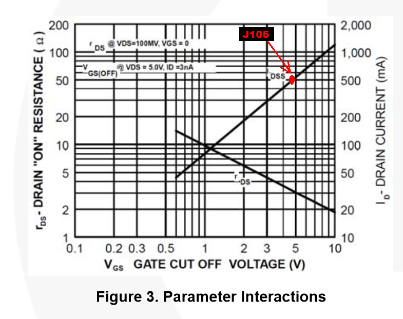

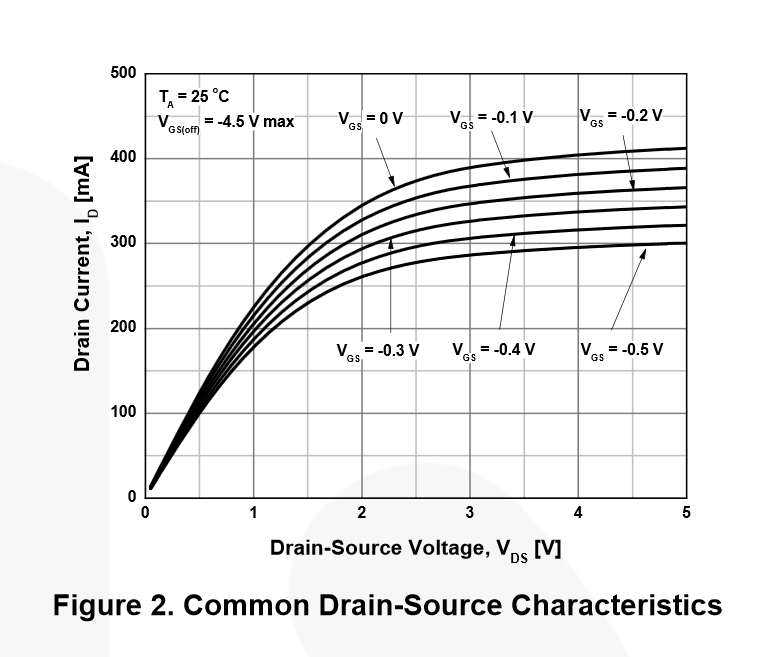

I wonder how they measured the data shown in Fig.2 and Fig.3 of the J105 datasheet; it is a TO-92 device with 625mW max dissipation. Grab a couple I-V points from the pentode (near-horizontal IDS) region of Fig.2, and multiply IDS times VDS. Cowabunga!
Since IDSS must be measured in the pentode region of the I-V curve (where VDS > |VGSoff|), the J105 requires VDS >= 4.5V to measure its IDSS, according to the data in Fig.3. So, when you're measuring IDSS, the part burns 4.5V*0.5A = 2.25 watts. Biggger than 625mW. I have placed a red dot at the J105 point on Fig.3.
Fig.2 looks to me like the J106 (the middle device in the J105 J106 J107 family that this datasheet represents). The Fig.2 device's IDSS appears to be about 400mA, which is within spec for a J106 but not quite within spec for a J105. Here's the datasheet itself.
