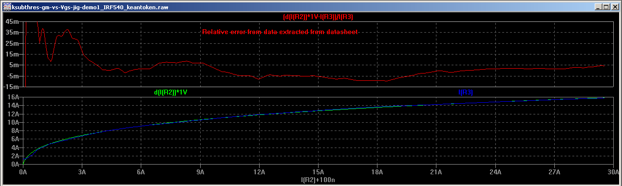

Okay guys, it would help if you could post links or attach datasheets or measurements with clear, precise plots of Gm and Id vs. Vgs. I got the IRF540 to model Gm within 1% above 3A, but below that the graph just doesn't have enough data and the digitizer can't extract it without significant errors.
Also, ST datasheet has different curves than the Fairchild datasheet which has different curves than the IR datasheet, etc etc. How do I choose which one to model? I guess it just depends on which datasheet gives the best data...

The Phillips datasheet for the IRF540 gives lots of detailed information, even a plot of the subthreshold region. The Phillips IRF540 is very similar to the Fairchild and most of other makers, so I think it will respresent most of the available devices. The ST IRF540 is something else with clearly different characteristics. I will try digitizing the Phillips datasheet later and using it for the model instead.

In general I've depended on measurements of actual power MOSFET devices to get models with decent performance at low current, especially for the subthreshold region. It doesn't take many datapoints in the subthreshold region to get what you need, because the exponential behavior there is fairly well understood. The subthreshold slope just needs to be inferred with some confidence. Vgs measurements at 10uA, 100uA, 1mA and 10mA is probably plenty. Vgs will usually change about 200-500mV per decade. I have found that a conventional VDMOS model that does a decent job of modeling above subthreshold can be made pretty accurate by just adding a value of ksubthres that just brings up the low-end current up to the proper subthreshold slope.
