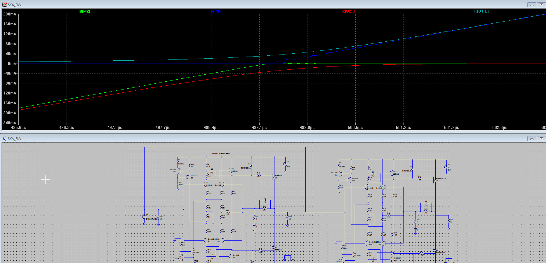

I tried the SKA amplifier simulation with the EKV models and the crossover looks much more progressive (and realistic) than using the Cordell models. A strange side effect is that when injecting an ac current source into the output, the Cordell models cause a low level oscillation, while this is gone after a few us using the ksubthreshold version

The SKA has a very low quiescent for a mosfet design and shows off the abrupt knee of the old simple model.
This plot shows the output device currents at crossover.
When I drive the output with an ac current source the simple model goes unstable
When the old model turns off it shoots straight to zero rather than falling naturally into the subthreshold region. This abrupt change creates a spray of harmonics that tends to stimulate any resonances in the circuit. This is always present if you use the old model, even if it is attenuated by high bias, and causes high frequency impulses that can cause strange behavior.
It's easily possible that the model itself isn't causing circuit instability, but that it is simply stimulating a resonance already present in the amplifier. If however you have both MOSFETs biased low enough that both of them fall in the "dead zone" where there should have been subthreshold conduction, the open-loop gain of your amp can fall dramatically and start doing things that are hard to predict. This is a flaw in the old MOSFET model, not in the circuit.
Exactly, class AB amplifiers operate output devices in the region where the simplistic model fails, which is why the improved model is so important for simulating analog use of power mosfets.
