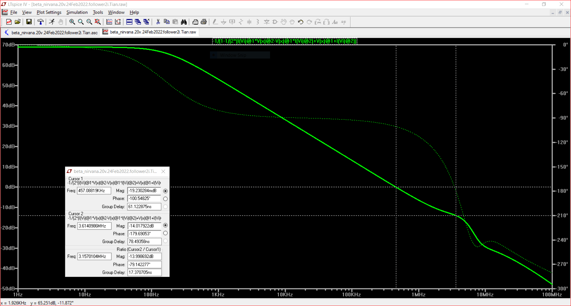

Yeah, this plot looks perfect. One thing I noticed - much lower levels of gain (Y axis). This tells me that this plot was done for an amp
with traditional LTP input. No high gain op-amp.
Within audio bandwidth this plot ranges from 42dB to 28dB only (14dB difference).
Typical op-amp will start from over 100 dB.
The problem with Tian simulations applies only to bootstraps used for increasing collector loads in common emitter amplifier stages. The circuit responsible for the images I posted includes one for a purpose other than for "global feedback" - a point I had overlooked in earlier comments. The first stage in this circuit is a single transistor with a constant current collector load, so as you correctly conclude not an op-amp.

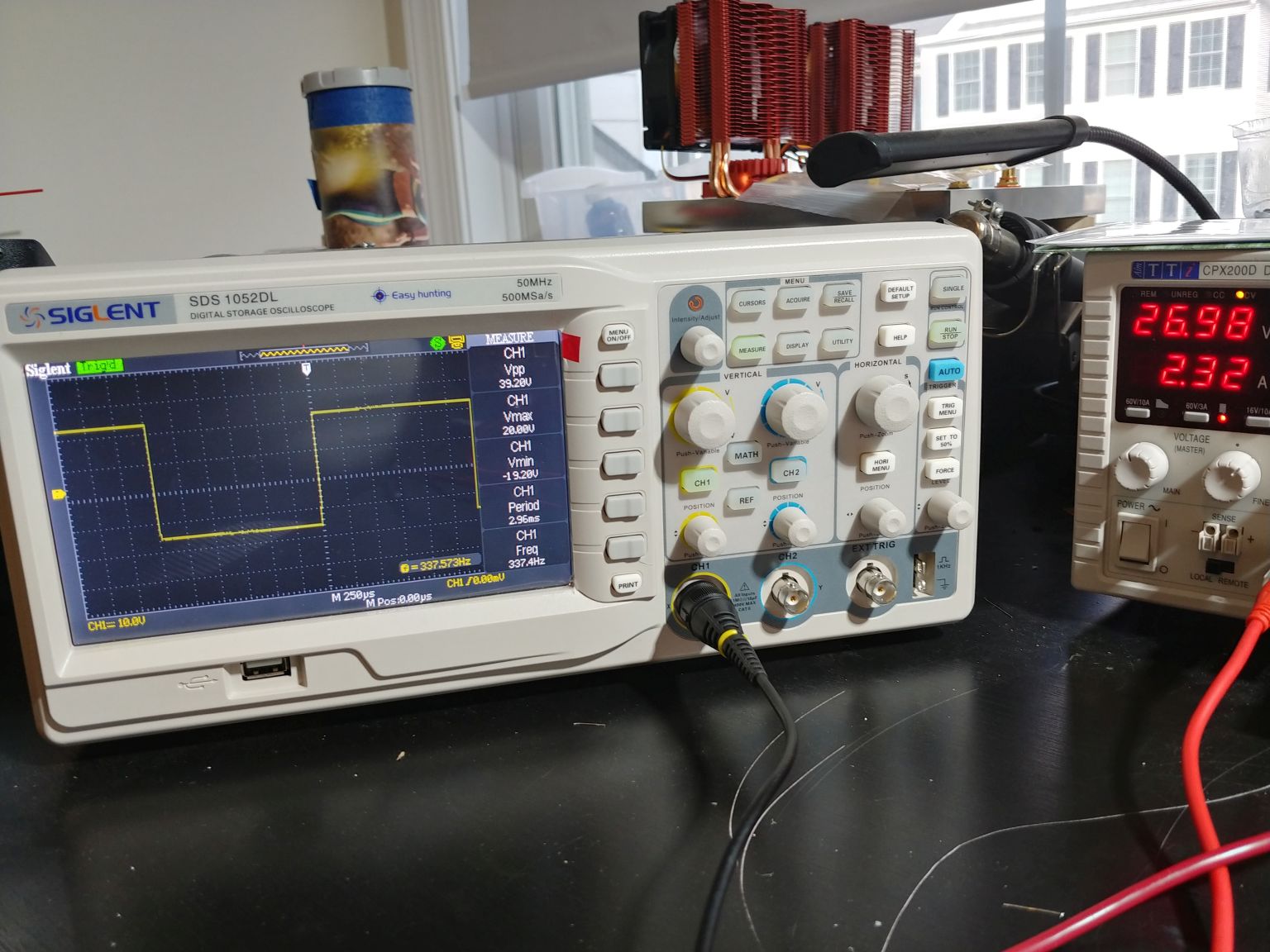

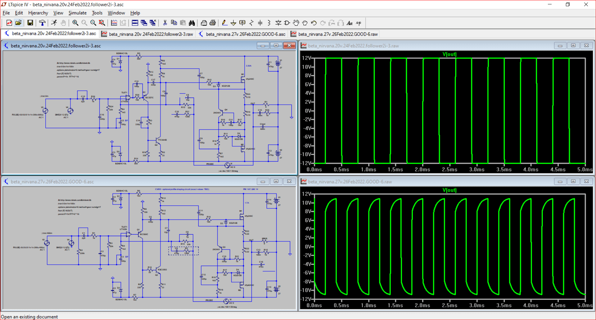

I looked at the 27V version several times to look at the square wave response and to compare the results with the modified version I attached to post 31. I don't like to see phase response not trending downward with gain as shown in the example previously discussed. In the attached image the version as above gives a decent square wave with a 680nF test capacitor in parallel with the output load.
That in your latest simulation, even without any test capacitor loading the output is distorted, and remains so if the square wave test is done at 20kHz.
It is unusual to see square waves so straight as in the attachment in post 31, I think that is attributable to the op.amp and some elements nested feedback loops are incompatible with poles in the discrete component section. So should we take a more direct approach or adhere to an approach needing a problem that appears not to be there.
You need to disconnect optional RC circuit (C9/R5) for "profile" shaping.
It seems that these rounded square waves are side-effect of it.
This could be the reason why you've never seen simulated square waves plot in the original AN thread 🙂
In you upper schematic this RC is disconnected, and the lower one has it connected.
In real life it is not that bad, I think simulation is making it look worse than it is.
My AN was showing fine squares on the oscilloscope:
I got the wrong end of the stick here, I left these components unconnected in my simulation and put them back when I saw them in a box on your later simulations. Anyway I had not finished with a Tian plot as indications were there was a peak at high frequency. I had your C7 at 100pF and changed that to 15pF you have arrived at and bingo.
You have to be happy with the square waves on your scope and to add to your joy the simulation supports this.

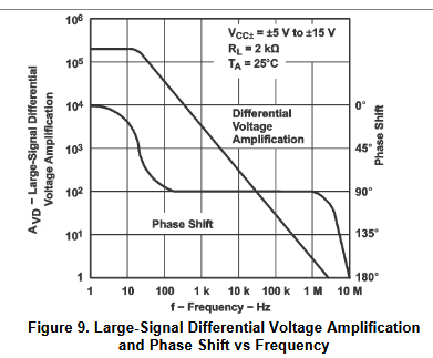

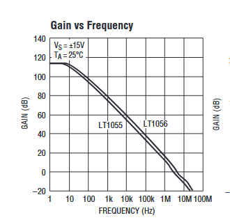

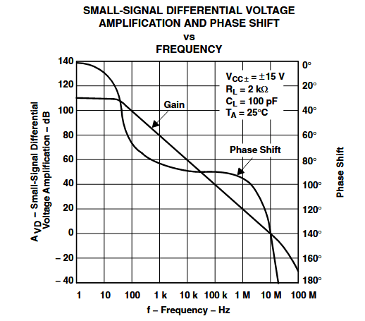

In these OLG plots I see that:
a) you flattened the 1st part of it (0 .. 200 Hz). Before it was sloping from 120dB to 65db, now it's flat from 75dB to 65dB.
After 200Hz it's pretty much the same plot as before.
b) phase margin was flat before at approx 90 degrees from 0Hz to 100kHz (which is good),
in the new plot, PM starts at 0, and reaches 90 degrees only after 1kHz, so we see here little bit more variation..
I suspect you applied too much feedback, hence the flattening of the gain plot below 200Hz
So basically the gain plot is flatter, because gain of the input stage has been tamed (perhaps too much ?).

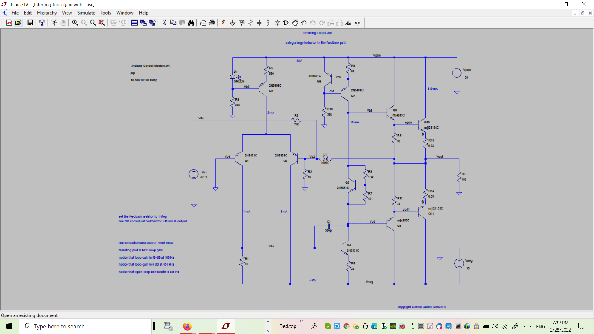

Assessment of OLG is covered in SPICE tutorials on Bob Cordell's website where he has a zip file covering a battery of tests in the main field. One method is shown in the image attached.

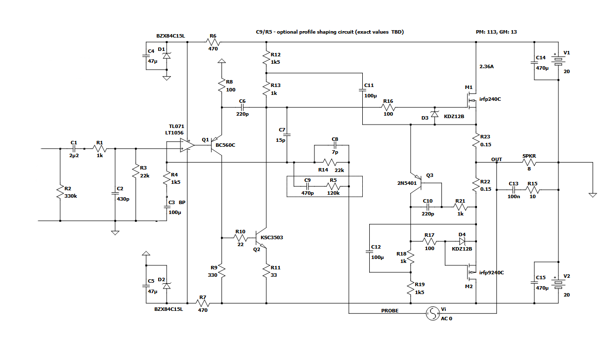

To continue I was not able to reduce the phase margins very much by the means I use with Bode plots such as increasing closed loop gain by reducing R4 which decouples the feedback to earth to 470R, and reducing the current passing through the VAS transistor and hence the trans-conductance of this stage.
Otherwise C7 can be reduced in value however this is pretty skinny and the path from between the collector load on the VAS transistor and the IC inverting input could be layout critical. I made that 12pF which resulted in a gain margin of 12 dB and a phase margin of 68 degrees.
If you can live with this then you will have enough closed loop gain such that input controls could be passive - for volume and switching.
C7 (along with C9/R5) is also a part of profile shaping circuit, and as such is not really needed, if someone is interested in 'pure' and 'organic'
fft profile. Without C7, H3 will be slightly higher than H2, which Hugh wanted to avoid.
It is possible to compensate this amp without C7 at all, but the harmonics profile won't be what it is.

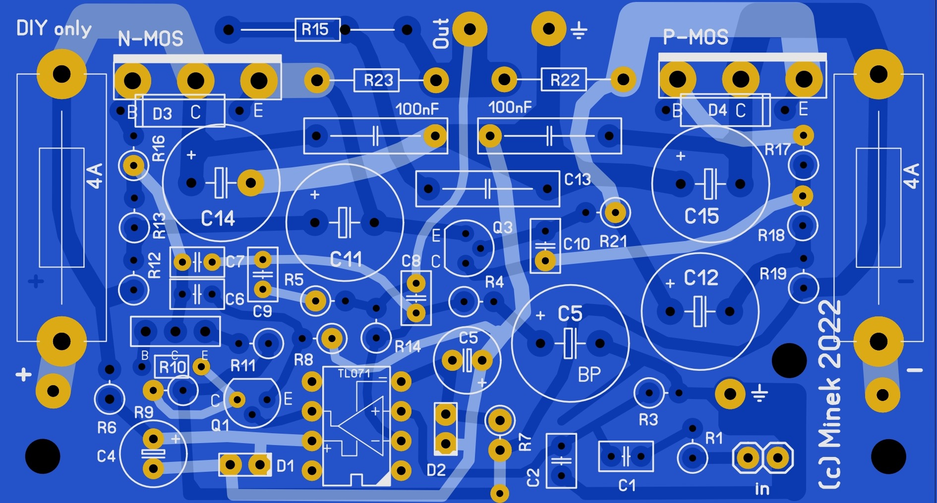

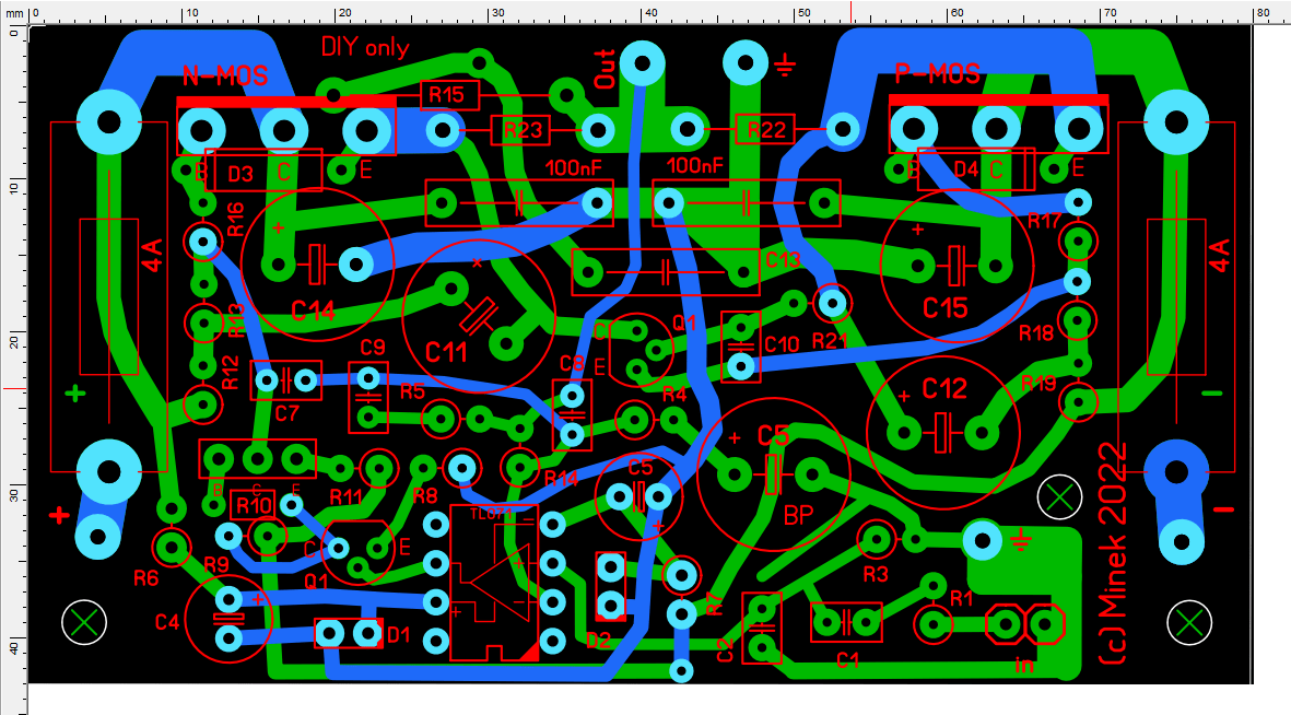

Nice work on the pcb.
The but ... statement would be a bummer for prospective builders who see the profile of the harmonics as the key attraction of the design. You mentioned how stability margins affect sound in an earlier post where the phase margin is in the vicinity of 65 degrees where the transient response would tend to being more agile. This can be achieved by reducing both values of the feedback divider network resistors, while increasing the closed loop gain, plus a small change in the value of C6.
Also in post 43 Hugh mentions what I see as a red flag over the choice of transistor used for Q3 - he used a BD140 rather than 2N5401 as he wanted a slow transistor to avoid oscillation. I have tried an MJE350 in a simulation - slower than a BD139 could be another option.
Anyway I see you have an ebc pin layout for Q3 on your pcb to take a 2N5401. 2N series transistors used to be available from over the counter outlets like Jaycar and Altronics or online from warehouses like RS Components. These seem to be disappearing from stock lists and 2N5401s are no longer sold by these places.
For future proofing and with new builds substitutes from the BC556, 557, and 560 range available from over the counter stockists could be tried. These have a cbe pin layout and they will still need your added in components to slow them down.
These are not needed with BD140 and MJE350 which are available from such stockists - at least here in New Zealand and in Australia. Should you change the pcb to match whatever pin layout for cbe or bce?
Hugh has a large following and those who want to keep faith with his thinking. If the layout was able to accommodate both pin layout options that could have some influence over decisions in going ahead to build the amplifier.
If the layout was able to accommodate both pin layout options that could have more influence over decisions in going ahead to build the amplifier.
You are right; so perhaps in the bigger, DIY friendly PCB layout we can accommodate different pinouts.
My PCB is really small, and I don't want to squeeze big BD140 in there, if MPSA92 will work just fine.
If Prasi can design bigger PCB, more DIY friendly, that would be great. If he can't - I can do it. Or anybody else.
Michael, if you want, I can give you sprint layout PCB file, and you can play with it. Perhaps fuses can be removed, and that would
release a lot of space for BD140.

That's why C7 is retained as is. It's not optional, and the current sim and PM/GM numbers are good with it.
If you remove C7, and leave everything else 'as is' - will do no good; C7 is an integral part of the sim, and can't just go away without making
major changes to the overall amp compensation.
We are not removing it. H2 will be higher than H3 - that's the signature characteristic of AKSA amps we definitely want to keep.
C9/R5 does not affect PM/GM numbers almost at all (when connected from OUT instead of VAS, and with reasonabale values),
so anybody who wants harmonics to be elevated and audible (above 90dB), can use them.
The values Hugh was using were 330k and 4n7 (or 3n3).

I also suspect that with the 220pF from base to collector of the sensing transistor any pnp would be fine, and I can confirm that the speed of the BD140 is VERY hard to find in the datasheets and could be anything...... I'd assumed with a heavy 1.5A collector curent the die was much larger than most and this could reflects a lower ft.
Much of the FFT of this amplifier is created in the output stage, that is where the magic is. It is a pseudo-single ended FFT. It would be good engineering to use a good IC front end if only for the offset control, very low distortion and low parts count.
