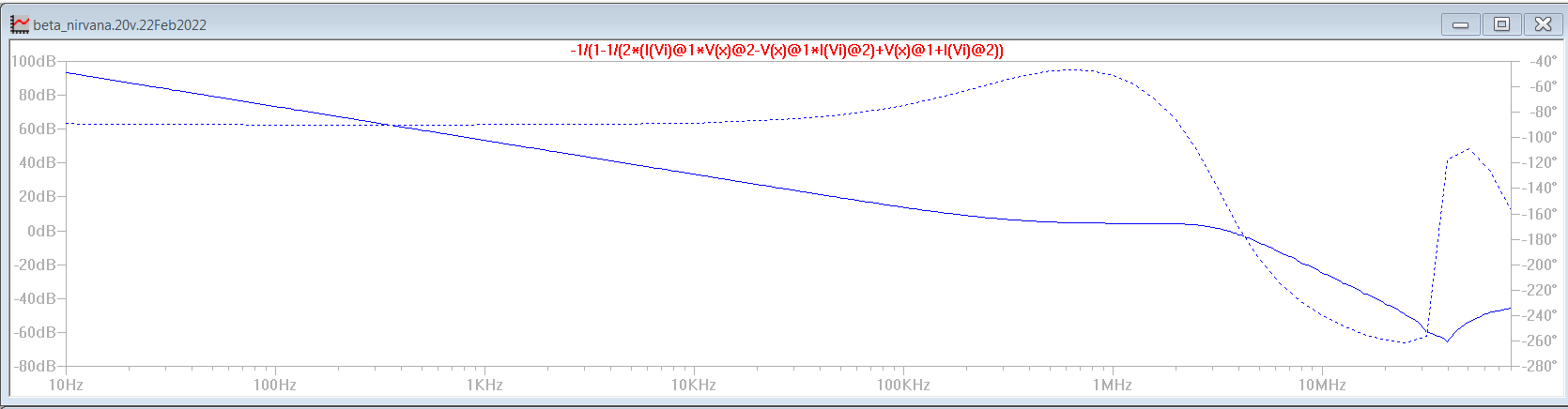

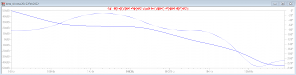

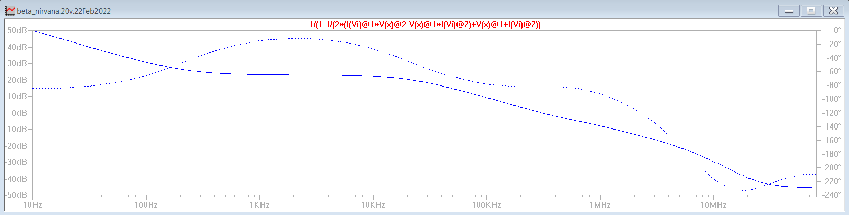

Here is the Bode plot:
I have slightly changed the IC output circuit, so it takes power from the +15V rail and thereby uses a much larger emitter resistor. Current is unchanged at 3mA, so VAS is unchanged. C9 can be reduced ten times, and this profoundly changes the Bode plot and now GM is 25dB and PM 98 degrees. The 20KHz distortion is not as good (THD is 0.071%) but the profile is unchanged and H2 is easily dominant (-65dB, still much less than a SE tube at -45dB) so this should sound particularly sweet, with very punchy bass below 100Hz.

The Tian plot in post 17 was not pretty so what does in look like now.
Re stability compensation the dominant pole is usually arranged around the VAS which has the greatest voltage gain. Other poles can compete with this and diminish the effect of the dominant pole so if you add capacitors to make progress be prepared to remove them if Tian plot doesn't look right.
Thank you mjona, that does clean out the curves nicely..... this is very stable at it looks.
I will look again at the miller capacitor on the VAS; it could simplify things further.
I'm not sure that beyond about 10MHz the Tian probe is particularly accurate; any comment there?

Bode plot from previous post looks like "closed loop gain", not like "open loop gain" plot.

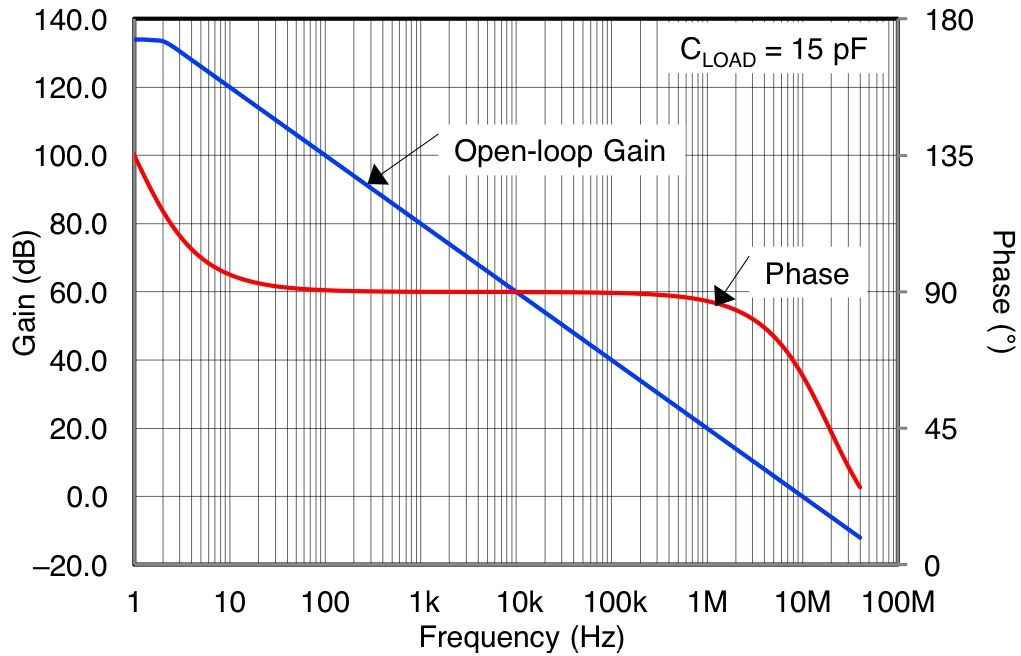

Here is what expected "open loop gain" plot is supposed to look - in almost perfect amp (OPA192):
Please note - on the left hand side, that gain (in audio bandwidth) ranges from 120dB to 55dB, while phase (in the same bandwidth) stays
flat around 90 degrees. Open loop gain plot is not horizontally flat, but sloping at approx 45 degrees.
Now, here is an example of what actual (measured by Anand on class A amp) "closed loop gain" plot looks like:
As opposed to the "open loop gain", in this case we should see horizontally flat gain plot, at much lower levels (say 20dB) - result of applied feedback.
Now, why bode plot in post #25 looks more like "open loop gain" plot?
I believe this is because so called "local" feedback loop (shaping so called "fft profile") is not that local after all.
This extra loop connects VAS output (which is rail-to-rail swing signal) to one of the inputs of the op-amp.
The impact of this loop is pretty much as significant as the impact of the "global" NFB (same rail-to-rail signal levels).
Tian probe doesn't even see that "local" loop, and that's why the bode plot looks like "closed loop gain".

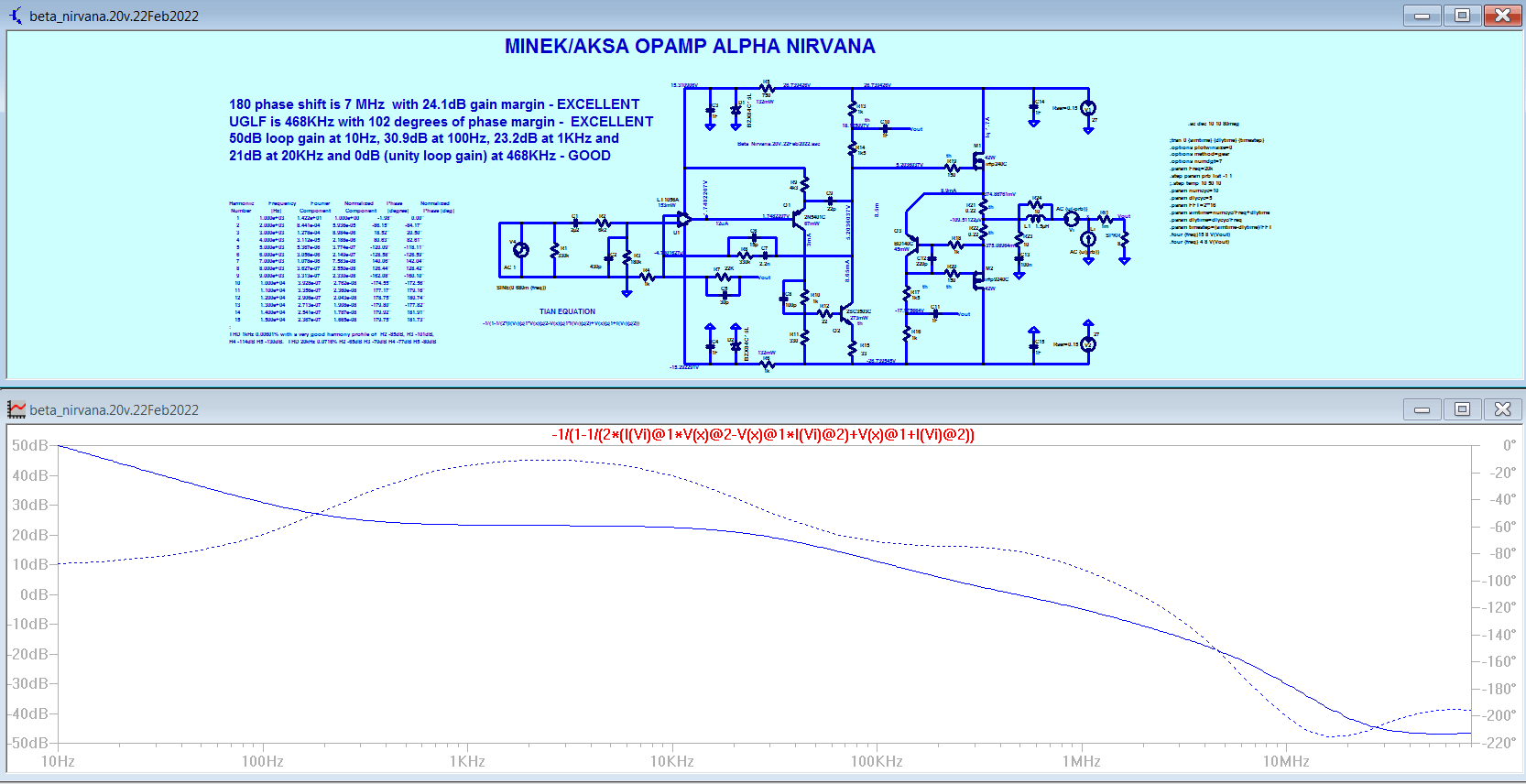

If you look at bode plot from post #13 - how does it look like?
It looks almost like our "perfect" bode plot (from top of this post).
High levels of gain on the Y axis, phase around 90 degrees, nicely sloped descending line.
And this I what I would expect to see, since we are dealing with an op-amp here.
The same rule should apply to any LTP based amp, just gain levels might be different (slightly lower).
I'm afraid that this "local" feedback taken from VAS output (like in post #25) is skewing the results beyond any usefulness.
It's not Open loop plot, it's not Closed loop plot, it's something in between.

Hugh, can you attach the .asc file with your simulation?
Numbers, and shape of the plot, as you can easily see in the image in post #26 differ widely from yours.
In my sim (post #13) PM is over 100 degrees, while GM is 9 dB. These are totally workable numbers, actually this OLG plot
is one of the best I've seen so far, which shows the potential of this amp.
I don't believe this is only due to each of us using different kind of probes; the numbers should not differ that much.
I don't have any reasons to doubt my methodology, it worked for me perfectly for many amp builds, and since my sim file and models
are always attached to my posts, anybody can try to reproduce it. This way we can test the same thing and compare results.
You don't have to use it of course; most prefer to use only global feedback and that's cool.

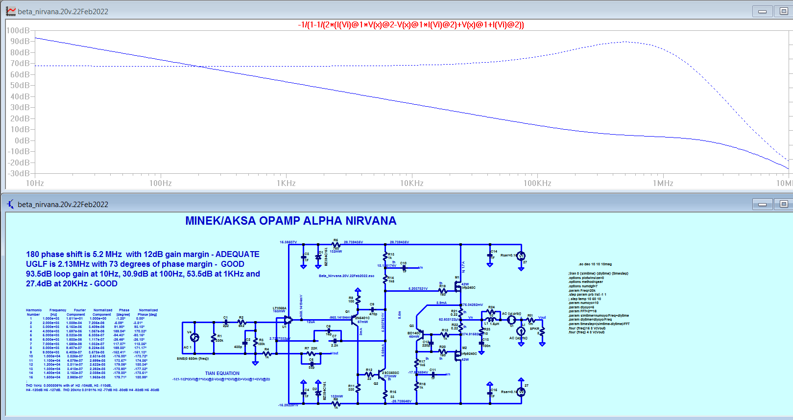

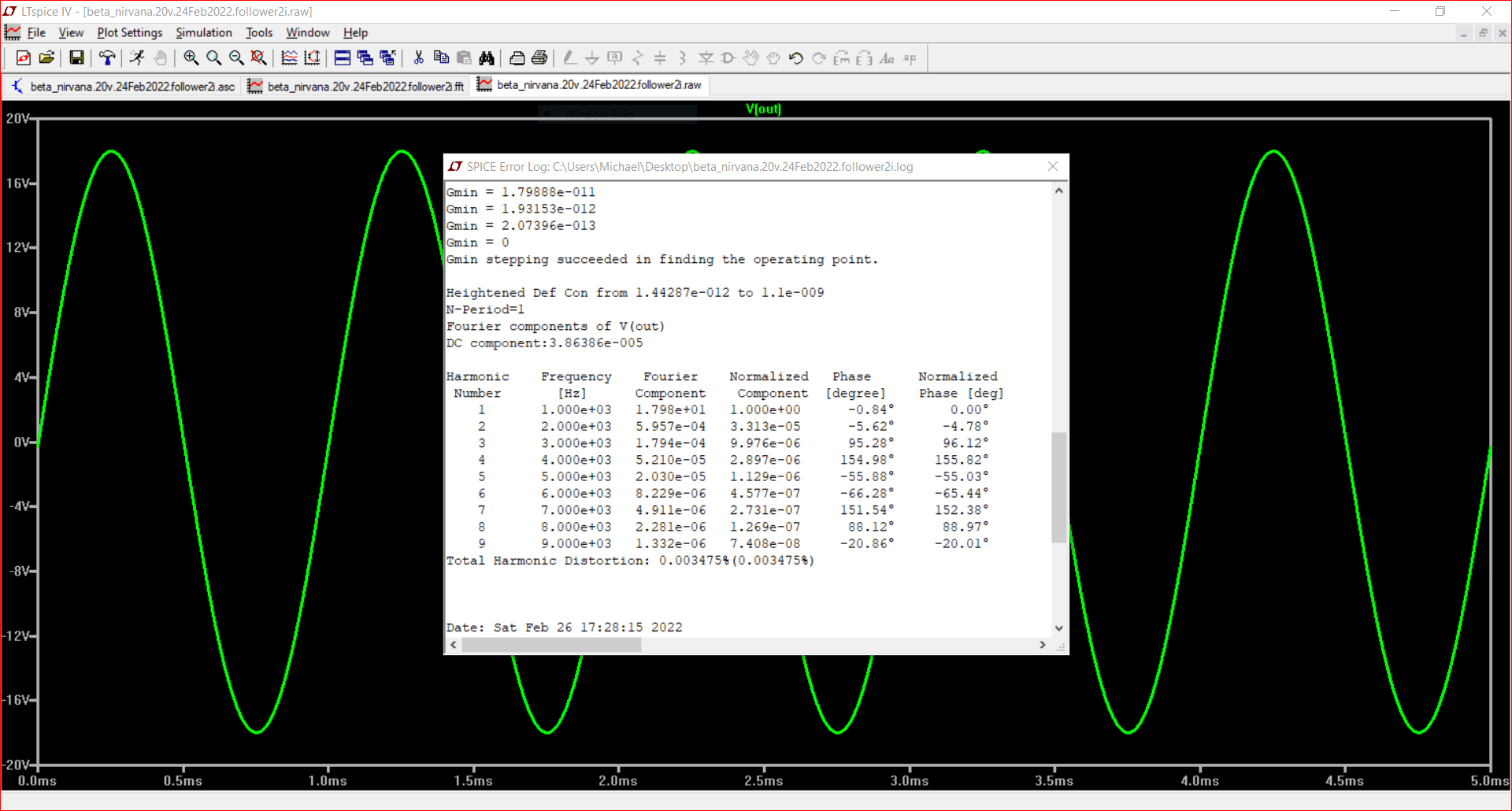

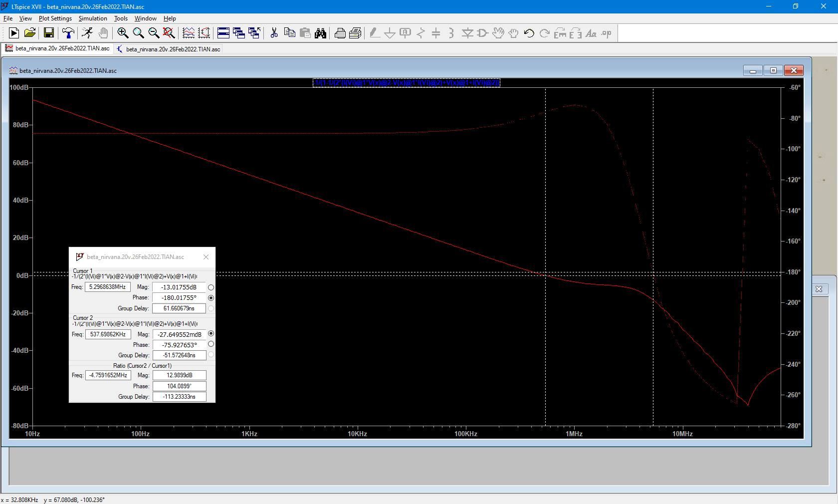

Thanks to Minek for posting the .asc file I have looked at the non-inverting input IC arrangement and due to some minor changes here are some results which may be useful.
At some point I changed the load from 6 Ohms to 8 Ohms and added a 470n test resistor in parallel with the load. The thing that made at lot of difference was increasing the supply rails from +/-20 volts to +/-27 volts. This is so as the collector to base capacitance in a common emitter amplifier depends on the voltage applied at the collector. This capacitance has an inverse relationship in proportion the square root of the applied voltage. That will vary under a.c. signal inputs according to the current passed through the collector load.
Better results moving the bootstrap points, and Vn is inside the loop now.
Nfb turned off; series resistor deleted.
Max loop gain rises to 93.5dB at 10Hz, and a little more at 27.4dB at 20KHz, compared to the previous 21dB.
This is the new Bode plot, you can see it's much simpler but the figures are not as good; GM 12dB and PM 73 degrees at 2.13MHz:

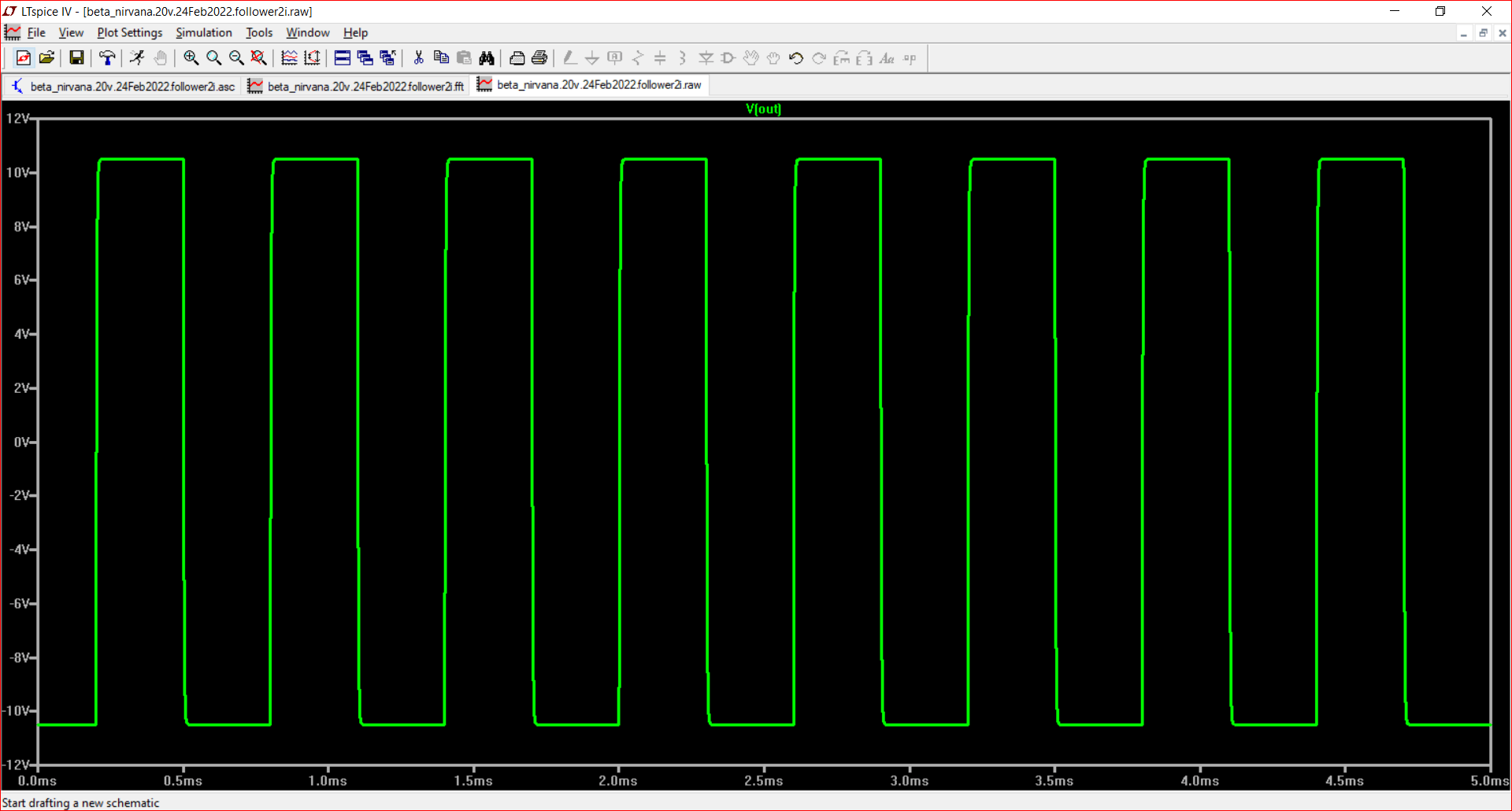

And this is the 20dBU output at 20KHz into 8R:
Very solid results so far.

3) Beta Niravana amp turned out to be difficult one to get nice handling of square waves.
So all the RC values in my sims are a compromise between Thd level, FFT Profile, PM/GM, square waves shape, and OS power consumption

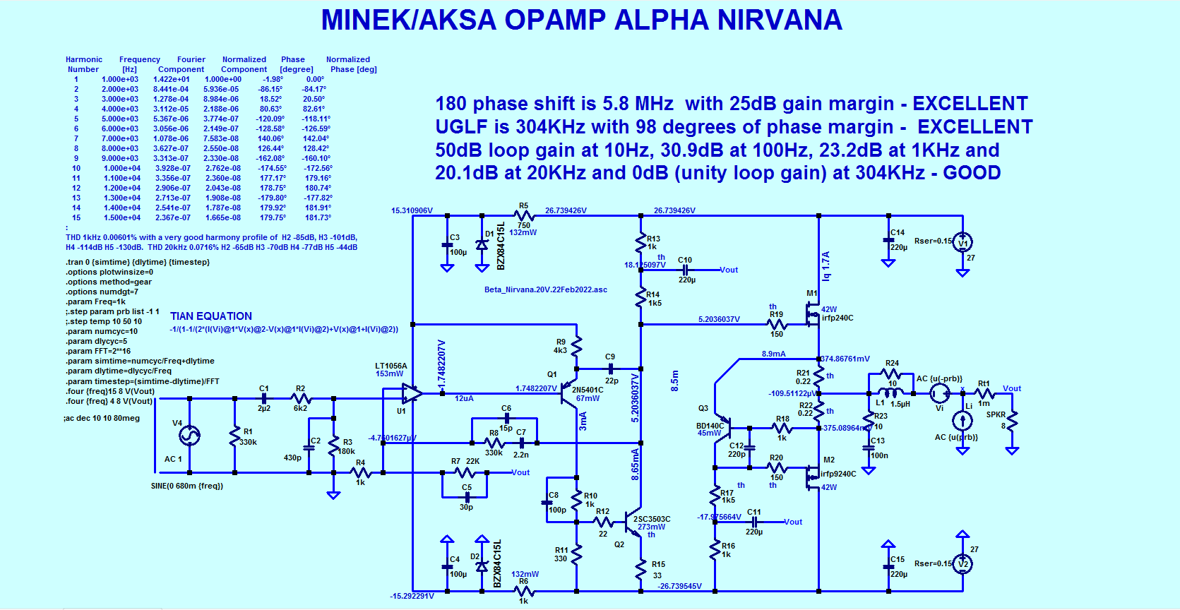

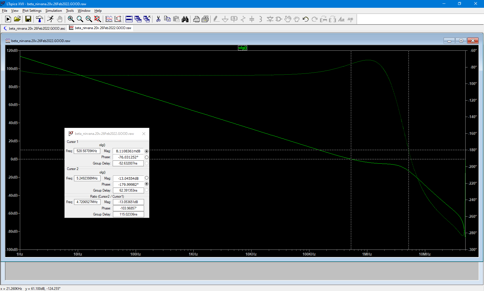

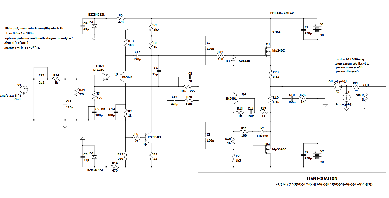

I was verifying two different methods of simulating open loop gain: simpler method used by me,
and Tian method used by Hugh.
Attached two .asc files for both methods. Schematic of the amp is identical in both cases.
Also attached OLG results. They are identical. Almost exactly the same numbers.
So it looks like both methods are working just fine, and results are reproducible (with all other things being equal).
In both cases:
Phase Margin: 113 degrees
Gain Margin: 13 dB
Thd at 1kHz (full power): 0.00035 %
Thd at 20kHz (full power): 0.0869 %
Square waves: very good
Idle current: 2.36A
Dissipation per Mosfet: 46W

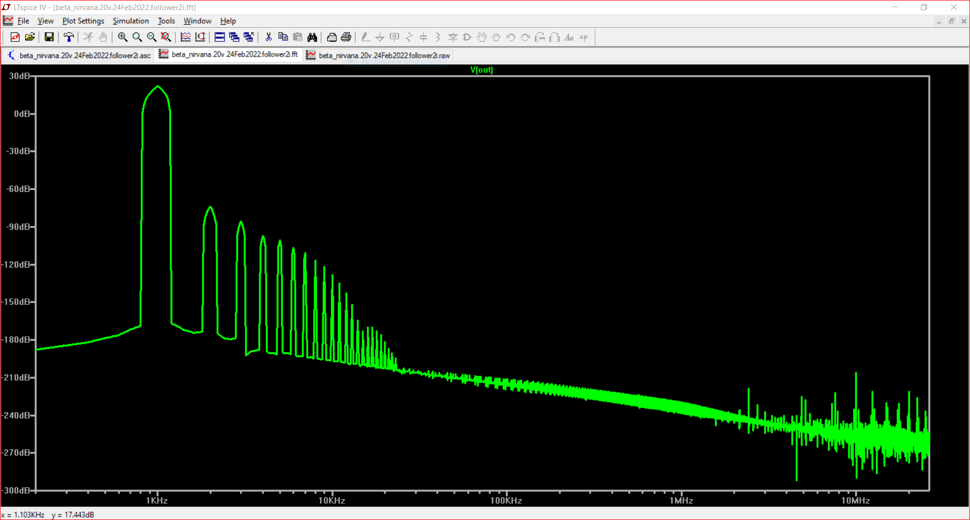

FFT profile - ignored for now, since we can shape it whichever way we want using Hugh's RC feedback method
I'm simulating amp with 20V rails (that's my PSU, and that's what I'm planning to build).
Hugh is simulating amp with 27V rails.
This amp is sensitive in terms of idle current applied to OS. By increasing rails voltage you might have affected
the idle current. My guess is that source resistors may need to be adjusted if rails voltage is changed...
I agree with that. Re the simulation Tian plot looks strange and I think the bootstrap capacitors pass feedback in positive phase these should somehow be connected somehow to the probe and the feedback connection rather than the output.
Some years ago I had a problem simulating an amplifier with a bootstrap collector load on the VAS and another contributor, Bimo, I think found a work around method to deal with this. You might like to look him up and see if he can help.
It took a little longer than normal for my simulations to run - for me usually a sign of a need for more work.

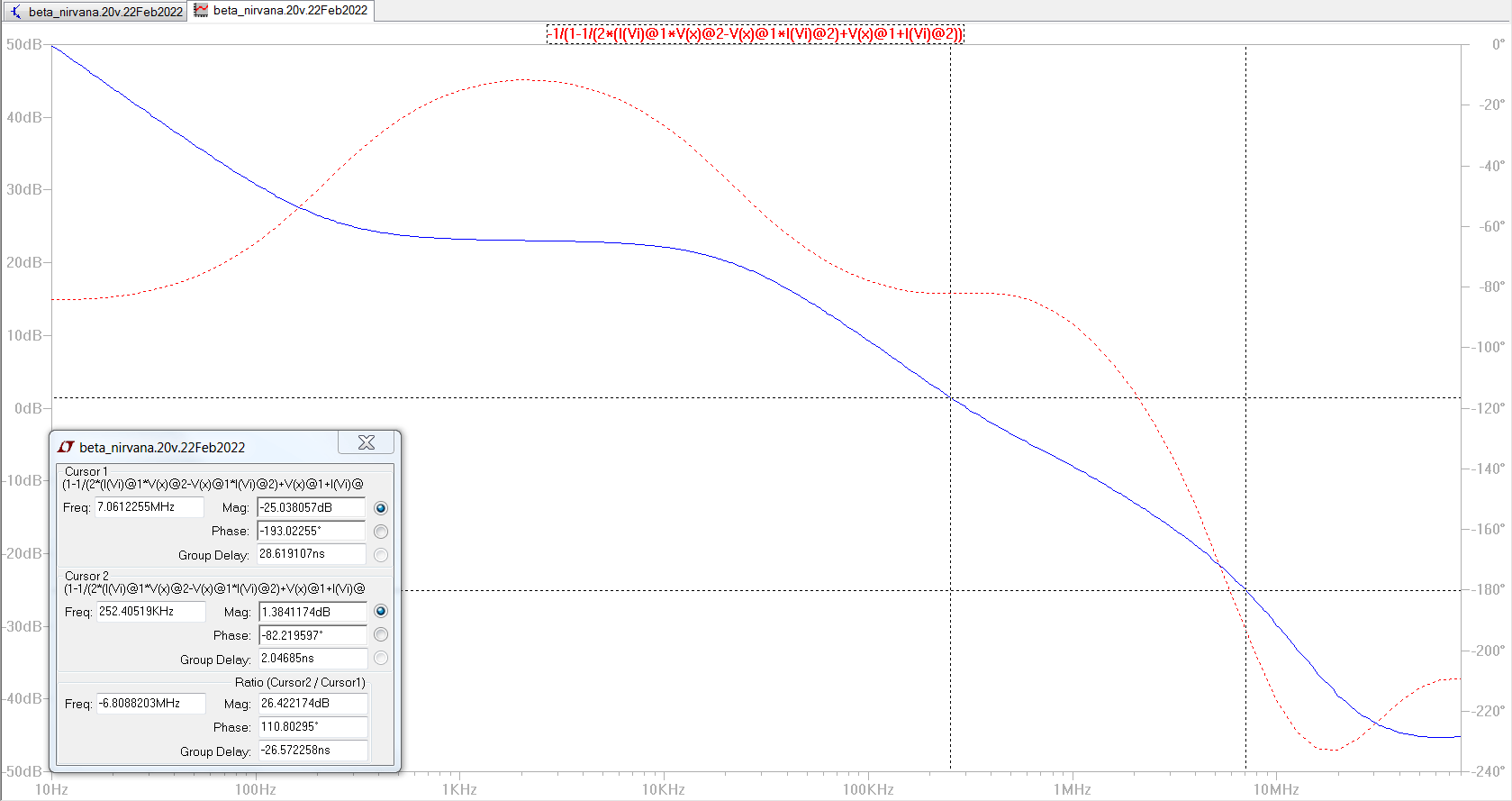

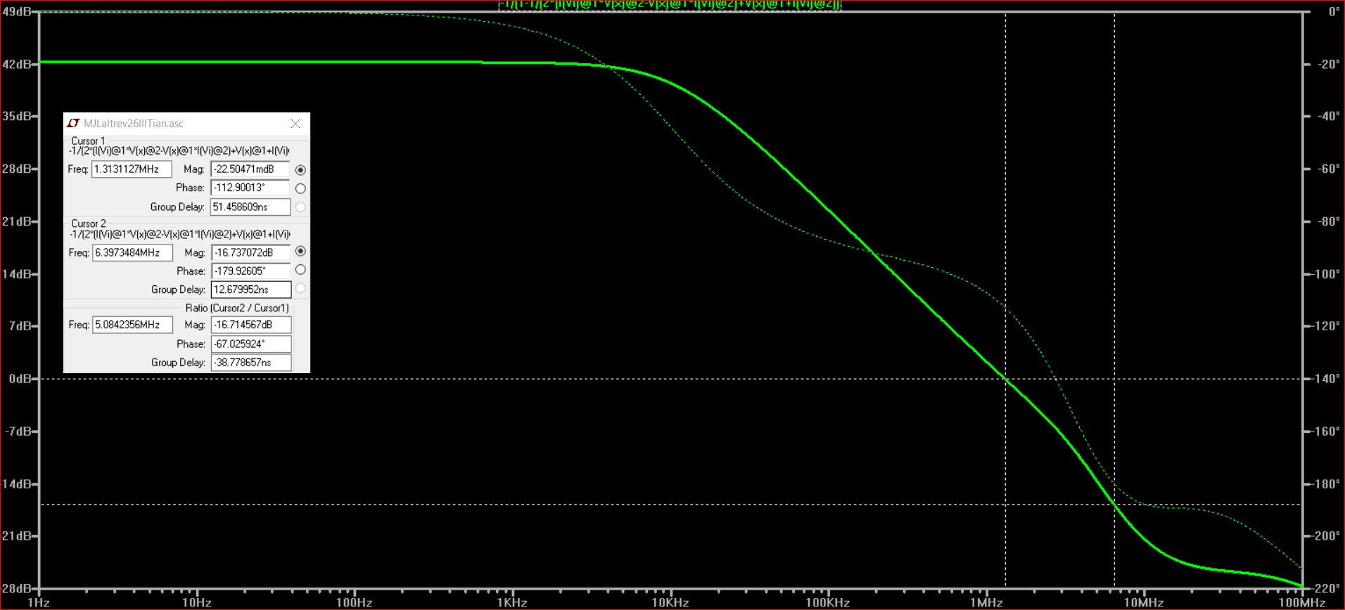

Attached is a Tian plot for a circuit giving close to the ideal phase margin you mention - there are no humps or notches in gain line.
Yeah, this plot looks perfect. One thing I noticed - much lower levels of gain (Y axis). This tells me that this plot was done for an amp
with traditional LTP input. No high gain op-amp.
Within audio bandwidth this plot ranges from 42dB to 28dB only (14dB difference).
Typical op-amp will start from over 100 dB.
With op-amp here, we are getting much higher levels of gains in the open loop, which makes humps and bumps more likely.
It's not easy to handle this levels of gain for all frequencies.
But our plot doesn't have to be perfect. It needs to be good enough.
It should roughly correspond to the bode plot of the op-amp used in the amp.

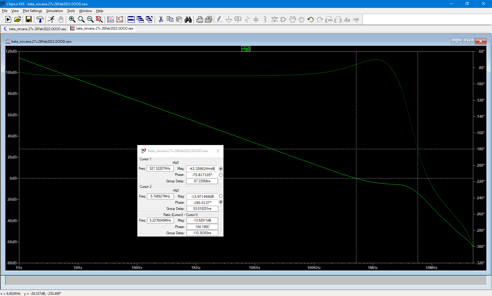

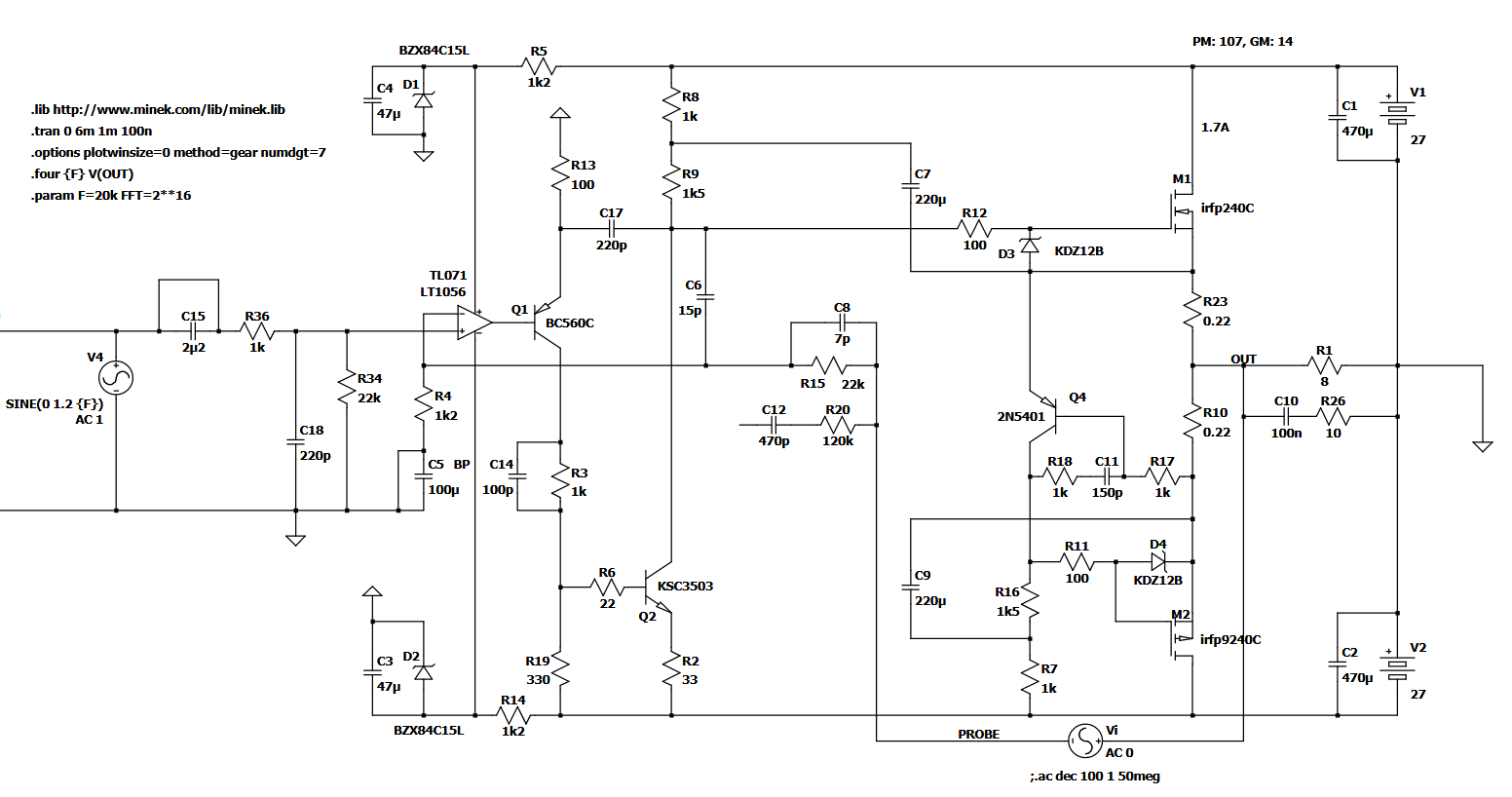

Here is 27V version.
The only components that were changed:
a) source resistors (0.22 Ohm now)
b) bootstrap resistors swapped (1k5 <-> 1k)
c) bootstrap caps (100uF -> 220uF)
d) gain increased (R4=1k2)
e) Zener resistors (R5=R14=1k2)

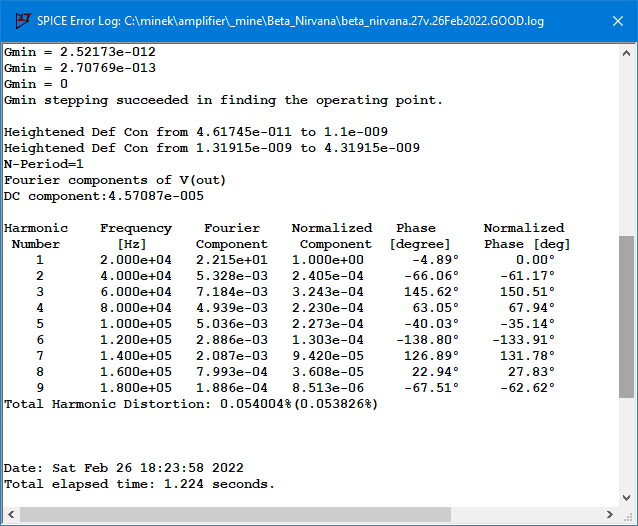

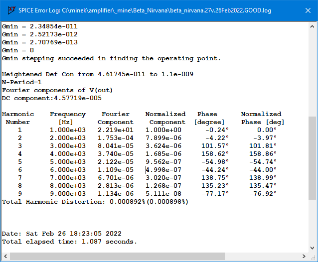

Phase Margin: 107 degrees
Gain Margin: 14 dB
Thd at 1kHz (full power): 0.00892 %
Thd at 20kHz (full power): 0.0540 %
Idle current: 1.7A
Dissipation per Mosfet: 45W

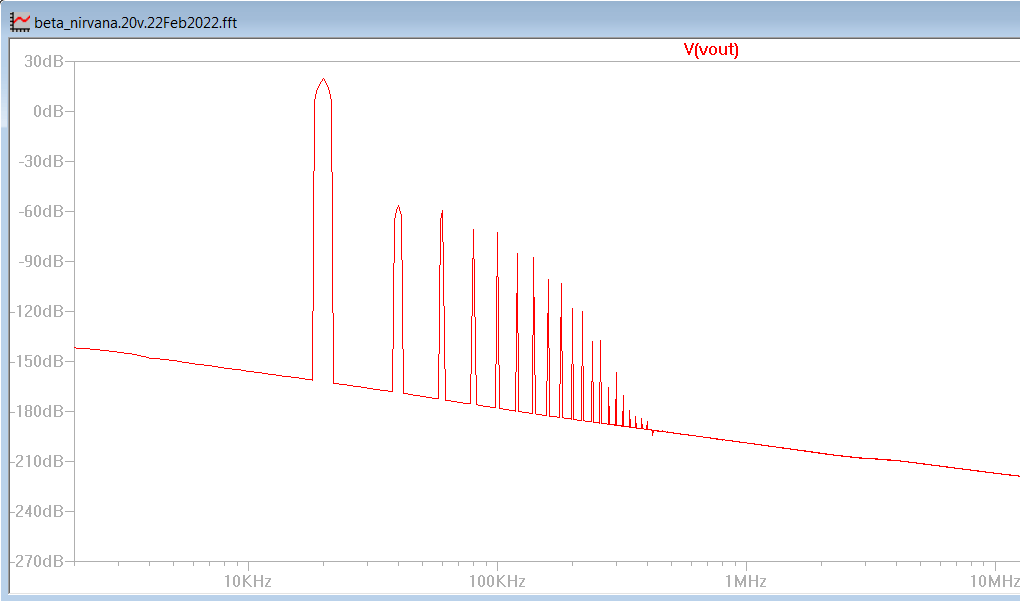

Thanks Minek,
Good results!
Two bootstraps ensure that driving the mosfets gates will dominate because the loading will be very high.
They also tend to load up at very high frequencies which can make the amp easier to stabilise.
In my later .asc I took the bootstrap inside the Tian probe, so I assume it included them in the feedback loop.
I had the impression that R3/C14 is not needed.
I was very surprised that the Middlebrook method was almost identical to the Tian.
Perhaps this is the time to lay out the pcb.......
HD
Thanks Hugh! I think it works very well with 2 bootstraps.
Not sure what is giving hard time with square waves tests, I suspect the CCS/current limiter.
But now square waves are behaving fine.
About 2 years ago, when I tried Tian method, it didn't work out for me, so I settled for the Middlebrook,
and never tried Tian again... I guess I was doing something wrong. Thanks for us your working example!
Will look into them. To be honest this circuit (follower + VAS) is already simplified from the original amp I borrowed it from 🙂
I'm sure some DIY members will recognize where it came from..
This configuration was used in a few HiFi amps in the late 70s (op-amp, 100R to the ground, follower, RC, VAS transistor),
and R3/C14 was always used. But let's try to see what happens without them.
As for the PCB - I already have one design almost ready. But this design may not be very DIY friendly.
I have specific requirements for my build/chassis...
What do you think about designing backward compatible (with old AN) PCB?
I'm not a big fan of these molex connectors (and connecting mosfets on long wires), so I wouldn't use it for myself,
but it would be convenient for other builders.
