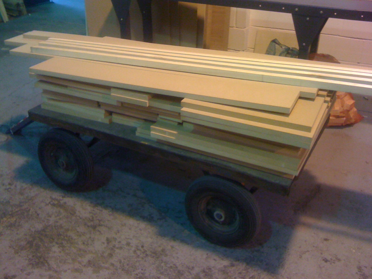

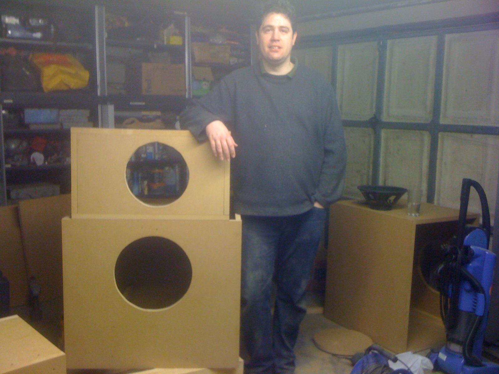

Just popped home for dinner. I'm assembling them at a friends who has a huge garage. Going back after to complete the first build. They will come home unpainted.
Bass units are 55 deep, 70 wide and 85 tall. These will be put together for fit and then dismantled for final fix at home to make transporting them easier.
I got some 10 thick x 25 wide pine for the tweeters. Should make them nice and snug

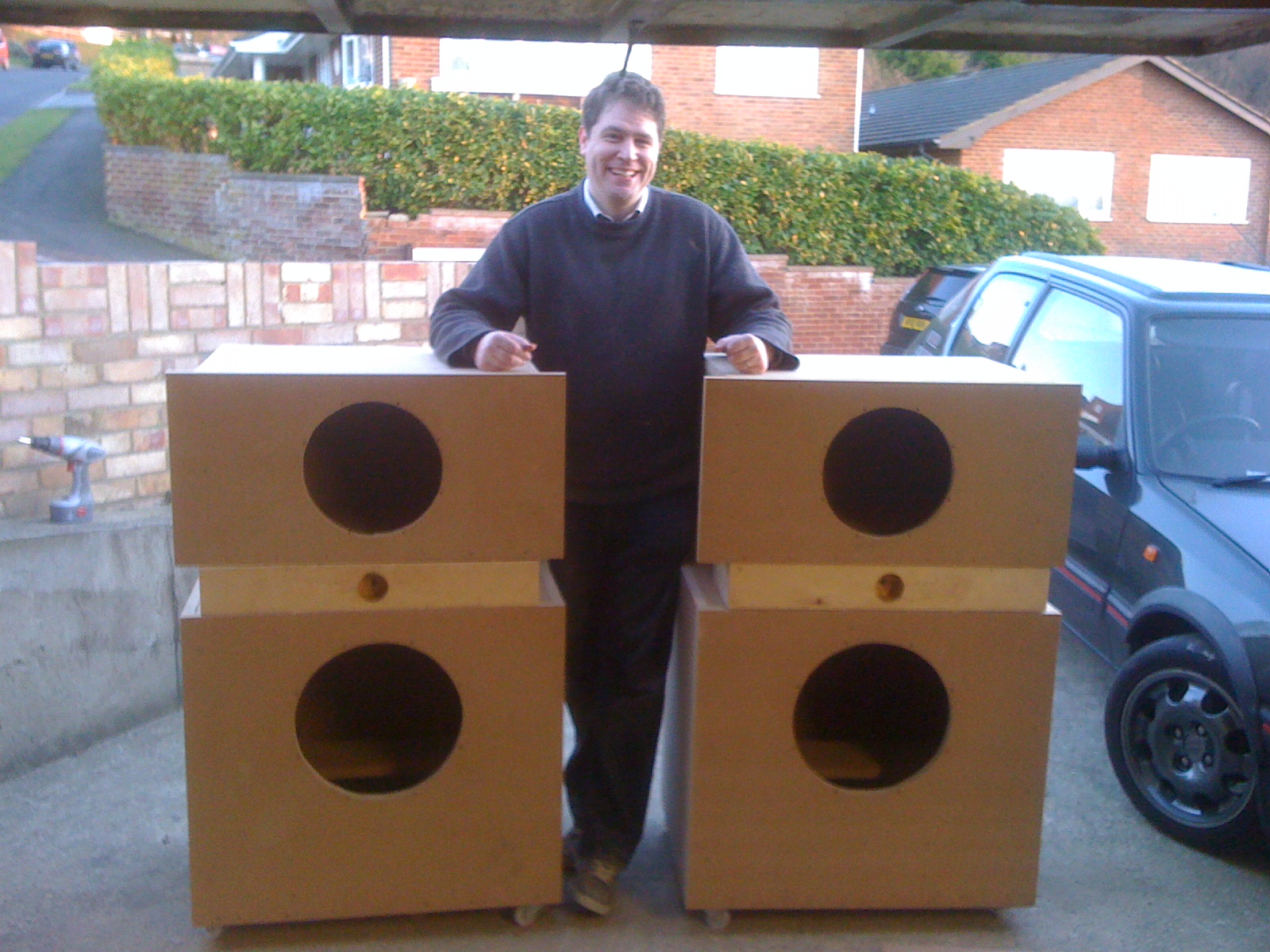

You went smaller than 11cf. Still plenty big!
To give you an idea of the size I'm 6ft 4 and the cabinets are on some 22cm high blocks.
Spot the deliberate mistake. I cut the hole for the 12lt way off centre 🙄 - another sheet tomorrow will sort that out 😱

Eminence 12LT full rangers in the 'smaller' top cabinet. Fostex FT17H in the middle solid block of Pine and Eminence Beta 15 inchers in the bottom
I'm wiring them up tomorrow - cant wait 😀😀😀😀😀😀😀
