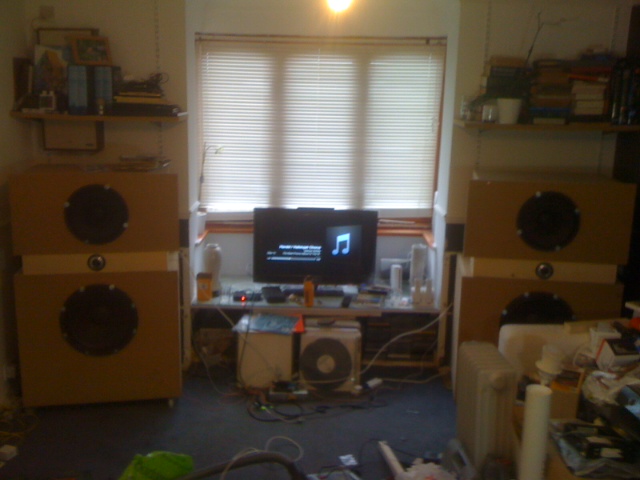

Nearly there! brought them home tonight

JRKO, i think you have a beautiful pair of music makers that will easily fill a room with sound. Looking at the photo i wonder how you will finish the project? You said the wife wanted you to paint the cabs a certain color... but i would encourage you to stain the middle tweeter section and leave it as a 'belt' breaking up the top from the bottom.

Thanks 'zilla! I was thinking of keeping that middle section a different color as you suggest. I.m going to seal the end 'grain' of the MDF with PVA & water mix before painting.

Dust cap is coming out (tired of being shouted at ) and a phase plug just to finish the look. I'm gonna stuff the 12LT cabs with Ikea cushions!!! £0.70 ($1.12) each is WAY cheaper than anything else

Just wired them up and am sitting with a stupid grin on my face whilst playing random choons from my selection. Damn these are good. The 15's can produce prodigious amounts of low solid bass. Solid as a wall and yet very spritely. Really really pleased

A friend came over and said' 'James, those aren't speakers, they are a way of life.' That pretty much sums it up for me. A little over zealous maybe but when it sounds totally real at any volume level I cant really complain - especially as they were sanctioned by the present Mrs O.
I've yet to caulk the frames, cut the dust cap, stuff the 12lt cabinets, PVA the end 'grain' and paint.
As for the subs I am going to have to employ Mrs O to help dial them in for home as its a lot of backwards & forwards otherwise. At the moment its a bit heavy with the amps running 50% volume and crossing over at about 120hz. I do have a low level hum though and think it may be because I'm using the speaker connections rather than the phono inputs but its easy to try both.

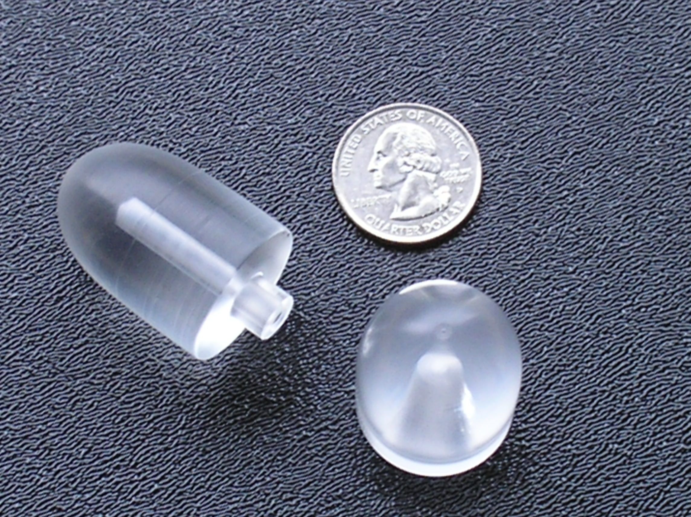

Can anybody point us to a visual tutorial on making phase plugs? I have a pair of these guys that I started a thread for a while ago, but I have not done any of the driver mods beyond using Duct Seal to damp the baskets.
Do you have access to a lathe, have you ever used a lathe? There are phase plugs out there that you can buy, Planet10-HiFi sells them.
I've also had reasonable luck simply spinning a wooden dowel in my hand while putting it to a belt sander. It'll take a couple to get the hang of it, but it's easy to do once you get the hang of it. Cut the phase plug off the end of the dowel when you are happy with the shape. Then you can start the next one.
