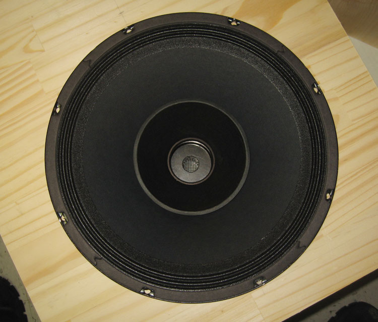

12lta sounds smoother and less resonant without the dustcap. I took it off just one and compared them carefully. Diana Krall sounds more natural. Without dustcap is better. Next i will add acousta stuff around whizzer (98 cent tweak) and when i get to home depot i will buy a dowel to make a phase plug. Also, FWIW, i think the speaker sounds better when it's more heavily stuffed. Sounds great!

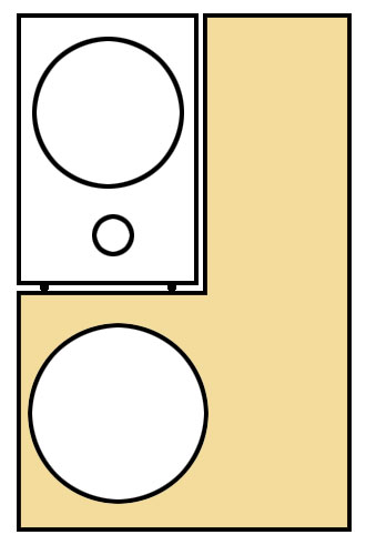

JRKO, i had an idea (a sketch) for your speaker but can't share until i get in front of a scanner. Would you rather go wider or deeper? The Focal design is very cool too. Would you angle the boxes in the same way? I think it would be great to put the 12lta on top and angle it down like that.
A tip to cut dustcap off is to sit the driver on a table that you can smoothly spin it. Have a sharp Xacto knife ready and spin the driver as you carefully score the dustcap. Figure about 50 to 100 spins and the dustcap will eventually come off in a near perfect circle.
I found the same with the Goodmans Axiom 201 I used.
Dustcap's are there for obvious reason (if I was a driver maker I'd put them on) but they mostly seem to be a "bad thing" that cannot avoided. Well, that's what they invented small stanley knifes for.
I'm going for wider that deep as this will better suit our lounge.
If I went the focal route then I would have the 12LTA angled down. I need to get spousal approval for that. If not then the tweeter will end up on one of those stands made of dowel that fostex show their more expensive horn tweets on
I'm very interested in your idea Zilla

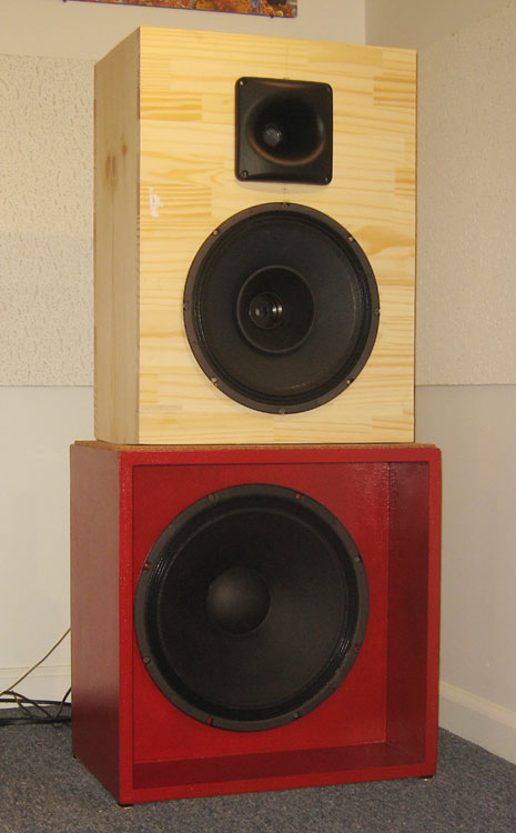

Here's my sketch. I am not able to build complicated cabinets so i always think simple. Basically the sub acts as a shelf for the 'monitor' that is the 12lta + tweeter. This way you can angle the monitor to suit your listening tastes, have the internal volume needed for the sub and the whole thing looks integrated. If you have good wood working skills maybe something more interesting can be done. Feel free to accept, reject or modify.
My speakers are functionally complete. Both dustcaps were removed and i will eventually get around to the 98 cent tweak as well as adding phase plugs. The boxes are sanded but not yet stained. I will post pics tomorrow.
Listened to music until past midnight. The overall presentation is large, dynamic, detailed and simply awesome! If the above tweaks improve things then it will be a bit more awesome. I really enjoy the result.

Some more pics. Removing dustcap is easy and even makes the driver a bit more interesting to look at. I will fashion a phase plug in the coming days but don't really feel there is anything more to do to the driver since the sound is already very good. Additional tweaks will only make minor differences. It sounds the way it sounds and i enjoy it. The overall sound is big and bold. The last few days i've been enjoying all sorts of live recordings by Fleetwood Mac, Simon and Garfunkel, Bee Gees, Eric Clapton and James Taylor. For fun i've also been listening to Rocky Horror Picture Show and Wicked.
The 12lta may not be perfect but it does things other (smaller) drivers just can't. It gets very loud and remains clear. It's very detailed, dynamic, efficient and bristles with life. It's easy to match with a tweeter and woofer. I enjoyed it even before cutting the dustcap off but it sounds better (less rough and less reverberant) when it's gone. It has an easy, effortless presentation that's forward. It doesn't do pinpoint imaging but after listening to it i have some questions on that topic for future discussion. It really is like a V8 muscle car of the past. And even with their limitations those types of cars are still fun to drive and have their loyal fans.
As i tried larger drivers i continued to like the sound i was getting. I think one can argue that larger radiating surfaces present music with a more lifelike presentation than smaller ones. Don't try larger drivers unless you have the space. I love mine.
This project has me curious about other 12" full rangers... maybe one day i will even try a 15". When the weather gets nicer i will add four rubber feet and finish these off with some nice stain and poly.
