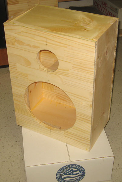

I like them so much i've decided to build new cabinets. One is finished as of this weekend... a pine cabinet lightly braced that's approx 1.75 cubic foot. This way i can get rid of my larger 2.5cf boxes (anyone want them?) and get down to about 80hz with ease. Sealed and appropriately sized, it will sit on top of the H-frames like they were made for each other. Only DIY offers this freedom of flexibility!

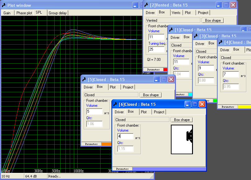

Godzilla, are you at ur PC at work? Can you ISD me a couple of cabinet sizes up to the 11.8cft vas (all sealed) for me? Amps are enroute

Here you go, Beta 15 in closed cabinets. Looks like 7 - 9 cubic feet closed is the sweet spot. I simmed an 11cf vented box and it goes deeper but it's bigger, it's vented and it may sound boomy in a home environment. If you look at Eminence's suggested projects you will see they modeled a 6cf vented cabinet that's -3 @ 45hz. The slightly larger closed boxes also reach 45hz but measure flatter. Closed appears to be a good idea. Choose your size and dimensions and build away. They should provide visceral bass you will feel as well as hear.

Thanks for that Godzilla - Bigger looks flatter so :smash::smash: let the build commence!

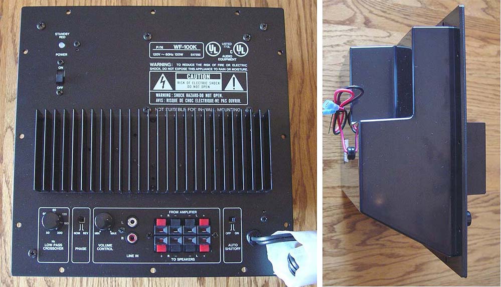

The Foster amp has a "4th order (24dB/octave) low pass adjustable from 50-200Hz. 0-180 degree phase switch, RCA and speaker level inputs, volume control. Unit has a 3rd order (18dB/octave) high pass filter at 29Hz with a Q of 0.707 built into the subwoofer section. Can easily be modified for any Q and cutoff frequency that you want by changing R615, R617, R618, C607, C608 and C609. The amplifier also has a spectral tilt control that is adjusted to give about 10dB of shelving. It can be manually adjusted with a pot on the PCB" according to the blurb
One thing I'm not sure on though is where to put the sub amps. I may build them into the mid cabinet and have that as a sort of control unit for the entire system. What do you think?

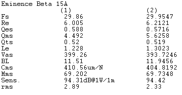

I'm curious which specs did you use, published or some measured ones posted recently or........?
FWIW, for a 0.707 Qtc max flat alignment using the decades old, well proven Margolis/Small HP calculator program:
published specs:
~464.36 L/16.4 ft^3 lightly damped with fiberglass insulation.
~274.56 L/9.7 ft^3 stuffed at 1.5 lbs/ft^3 fiberglass insulation, so would theoretically need somewhat more for polyfil.
average measured:
~347.21 L/12.26 ft^3
~218.9 L/7.73 ft^3
Pretty big difference, though at least going in the right direction, a rarity.........
WinISD Pro:
~763.4 L/26.96 ft^3 lightly damped with ?
Couldn't find any Ql, Qa adjustment to come close to the fiberglass calc'd Vb WRT F3, Fb.
average measured:
~470.00 L/16.6 ft^3
Sealed is very tolerant of Vb errors, but this disparity between programs for a basic max flat alignment is a bit much!
