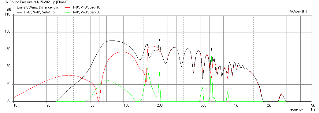

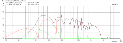

Can work in K15 cabinet
I think the 12LTA can work well in a Karlson K15 cabinet (1954 with 30.5 sq in vent). This is a simulation in AkAbak at 3 meters away with 1 watt input power. Super efficient driver - too loud for most listening applications inside a house.

12LTA has a weak motor & 0.08" overhang so imo not as subjectively dynamic in a K12 as 80 and 109oz magnet Eminence coax but would be appropriate for K15 to maximize its potential. 12LTA in the 6-slit vent K12 did do well on Danley's Harley bike track vs AN10 in a reflex where the Nirvana lost all cone control. A Karlson between K15 and k12 size should work. A K-tube helper or something like Selenium's ST324 would work. 1 Maybe I'll add a Nuke 6000 to my amplifier collection :^) 1KW if decent quality on the low watts would allow for pretty good drum transients. Would a K with rear chamber = (qts*fs*vas)/50 be about right for 12LTA?
