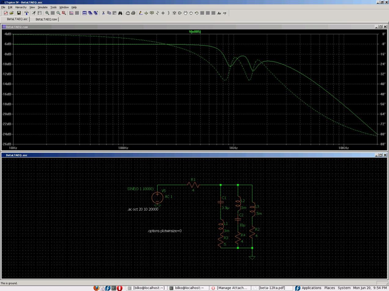

OK so here's what I did so far
Cut out the dust caps. Some improvement, but the shout that was still being produced actually hurt my ears.
I crossed the tweeter lower. 2uF
I made the notch filter do more. 1mh. 2uF, 15R. This made the biggest difference. Now I can actualy listen. This isn't the sollution I want. Seems wasteful of my limited power.
Any way at this point they sound OK. But my Ariels aren't moving to the basement yet.........

Evanc, I find it interesting someone wants to electrically tailor the response of this driver somewhat, cause it Ain't flat, but I'm not clear on what you're hoping for with a single notch.
These filter values you post, are they for a 16ohm load? (drivers series?)

When I first plugged these speakers in the midrange was overwhelming. And was super annoying at what seemed like one particular frequency. A notch filter seemed like a good idea to get them listenable. I had the inductor so that value is fixed. The drivers are parallel...4ohm.
I know my set up is crude and my knowledge little, but these seem like inexpensive, yet capable enough drivers for me to play with and learn. Reading is great, but I need to have an example in front of me to work with for the info to get in. Anyway critiques and peoples ideas on what "their" right way is to improve things is what I want.
Thanks, Evan

At the risk of sounding like a broken record (scratched CD, corrupted MP3, whatever) the small investment in a MiniDSP will reward you many times over.
You can set any active EQ curve you like, croosover to a tweeter (or helper woofer), listen, change and listen again.
If the sound quality is acceptable, you can leave it there and the job's right.
If the sound quality is not good enough for you, at least you will know what curve you need from an active EQ. Build one, make it's curve match the one you decided on with the MiniDSP and put the MiniDSP in the cupboard until your next build.
Like a soldering iron, a CRO, or a calibrated mic, a MiniDSP can be a vital aid to the design and optimisation process.

blakkshepeaudio, can I ask you a question? It's something I've not been able to understand. If you're going to make a 4-way system with minidsp, doesn't that mean you need 4 independent amps for each set of drivers? Or is this totally mistaken? Looking at the inputs and outputs, I can't understand how it works any other way.
You understand. Signal level crossover requires amp per band.

I like the idea of adding a 15" woofer to supplement the bottom end. I could keep the 2 LTAs as they are and let the extra woofer fire out the side of the baffle. I have an ss amp and active cross over I could dedicate to the purpose. In my limited experience I have not liked using multiple amps except for woofer duty. Although the sound has improved somewhat as these drivers run in, I don't think that they will be useable without some attenuation of the upper midrange. Probably time for me to invest in some measuring tools and software....
As Andrew said, your understanding is correct.
However, there are lots of ways to skin the cat.
If you were planning on making an active four way, then you need 4 amp channels per side and either multiple MinDSPs or the new 8 channel beastie.
If you were planning a passive four way, you could design a passive crossover for maximum transition smoothness, and then use a single MiniDSP to flatten out the bumps. This would save you amplifier power which is at a premium in your system I guess.
You could also go half way and use your existing amp for the top 3 drivers, and cross over to an active sub using the MiniDSP.
Lots of possibilities. You CAN just use the MiniDSP as a DSP EQ, without any crossover at all, if you want.
