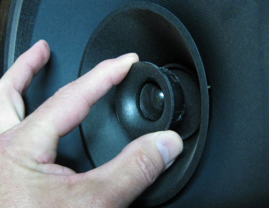

Hey guys, I just read over all 23 pages of this thread with great interest. I have a question: is 44mm the maximum diameter of a potential phase plug? I've seen mentioned a few times how great it would be to make the Beta 12LTA coaxial, and the nearest solution I could find is this. It's got 96db sensitivity and the cutout diameter is a little under 1 3/4", which means that if you were to saw off the flange then maybe, just maybe, it could fit into a tube in the center. Just how feasible would this be?
That tweeter works quite well with the LTA. One of my many unfinished projects is to mount it as a coax. I tried using it Hammer style but it didnt quite sound right.
I ripped the heat sink off and pressed it into a 1.25" PVC slip coupler. The couplers ID is just slight too small so removing a bit of material is needed. The coupler makes a nice guide so that you can grind or cut the flair off. I used a bandsaw and then a belt sander to clean it up. It does lose some efficiency after removing the "horn". You can check out a review of it on Zaph Audio.

44mm is the figure Dave (Planet10) gave me and I'm not gonna argue with that!
However there is about 48-49mm total but you don't want the voice coil former (tube) rubbing.
The Afterbutner project (google) used a tweeter positioned centrally but held with an arm from the side of the 12LTA. Problems as far as I can see are going to be phase/time alignment. The 15 inch Tannoy Dual Concentric which I owned had a fiendishly complex crossover/time alignment/phase thingamajig so cover these problems.
To be honest though you really dont need a tweeter in the normal sense with the 12LTA. I just use a helper tweeter. My Fostex FT17H just has a Jantzen Silver Oil 1 uF cap to remove the lowest of the low. It comes in around 5-8khz and does the high airy stuff.
The 12LT really is a true 'full range' driver. It needs a little help at the top and a little at the bottom. That's where it's at its not inconsiderable best
Figures i gave out were from my (uninstalled) 12LTA phase plugs. A client ordered a custom pair (when we could still do that) and we made 2 pair. Client was very pleased with his. I am just now considering doing up a "miniOnken" style box for the 12LTA, likely not mini at all.

After removing the whizzers, I added these tweeters several months ago. I attached mine by using a steel-based epoxy to glue a T-nut to the back of the heat sink. I then used some threaded rod and an assortment of washers to bolt the tweeter in place. (I also epoxied the heat sink to the tweeter.)
The dark ring on the cone around the tweeter is a shadow from my camera's flash.

btw - a fun helper tweeter was to fire an APT80 knockoff upwards into a slotted styrofoam cup as a poor/lazy man's B&O lens
(another Karlson derivative imo) - the "Kup" could be rotated to toe in the HF
B&O
B&O
