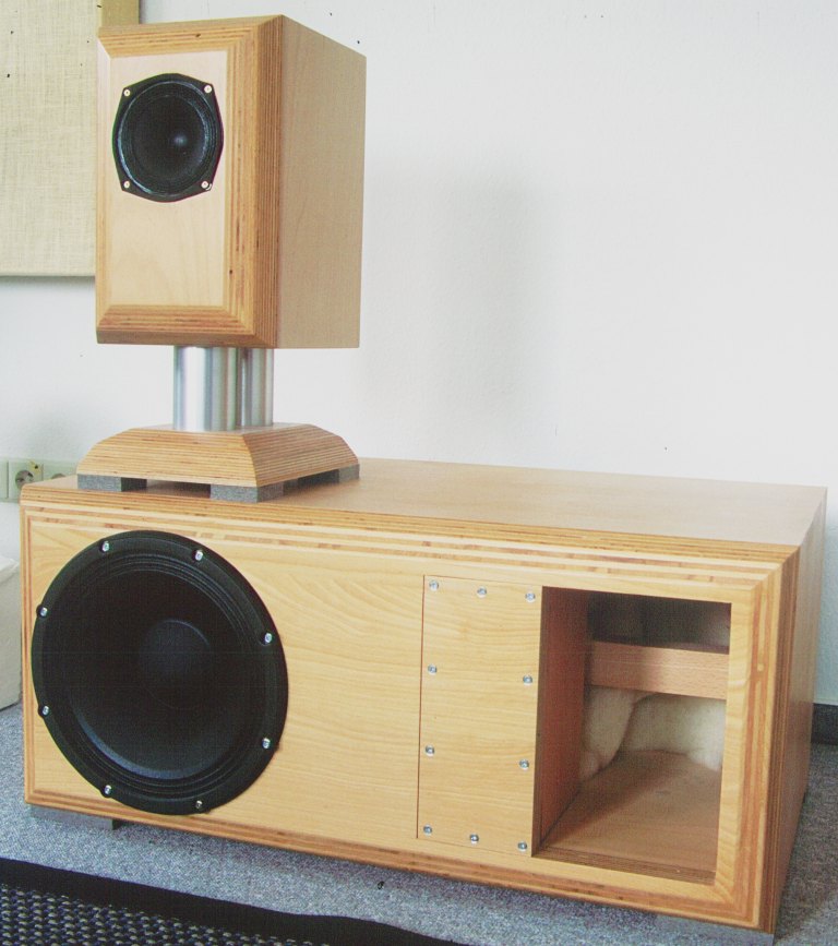

Opinions please:
Regardless of box size, flatness of response counts, tonal quality counts, high sensitivity counts.
The goal is to be VERY FLAT and 99db/1w/1m - but I'll take tone, fidelity and flat response with a lower sensitivity and use a more powerful amp, assuming the driver takes power...
Looking to fill between a sub system that actually covers from 65Hz down up to a horn that actually covers from 250Hz up - so the required passband is ~65Hz to ~300Hz. Don't worry about the xovers needed or the cabinet size or type! I'll handle that part. Mention it though.
Opinions and input appreciated.
In such cases a horn based approach is too large for most cases. My favorite approach here is a so called "BOOM-BOX" - one of the BB4/SBB4 (super-) boom-box alignment. The SPL aera arround the tuning frequency is enhanced very strongly - thus an appropriate passive high pass network is necessary (two resistors, one cap and one inductor for an acoustical slope of 36db/oct).
By a tuning freqency arround 60-90Hz the vented aera has an larger surface than the diaphragm of the transducer, if the chamber volume is above 70 liters by one transducer and 140 liters by the use of two transducers with diameter between 30 and 38 cm ('12-'15).
This ensures very low distortion by the sonic radiation of the vented port.
By vented port surface lower than 75% of the cone aera avoid vented boxes (in all cases, where only a low chamber volume is possible).
Very important is also the use of drivers with very low mechanical losses inside of surround and spider.
There are very few rubber surround devices in real "low-loss" version by low influence through present ambient temperature at the same time. Thus a cloth material is to prefer.
Some years ago I prefer Fostex 12W360 - now US-Magnetics - go to
12W360-8 US-magnetics 12" Woofer - BELL AUDIO STORE
There are additional other good quality chassis available like FANE Colossus series, Precision Devices, '18-sound (eighteen-sound) and McCauley.
The attached example (sandwich box, 100db/1W/1m, 80-500Hz, equipped with Fostex 12W360, approximately 100 kg) has a tuning frequency arround 70 Hz and an internal chamber volume of 80 liters.
The associated subwoofer you will find by post #12 (image 2) about
http://www.diyaudio.com/forums/subw...ld-milano-full-power-down-10hz-galerie-2.html

Hi bear,
I understand what you want. A best eff with the best sound of bass ( no sub bass ) is possible with the better 12" or probaly 10", 8" of the market. For me, closed cabinet or OB ( two speakers ) with ALTEC 414-8C / EMSPEAKER B12 or B12 EX or B8 / TAD 12" is good way.
Hi Tom,
Sorry, i'm not according with you. Had you read " the speaker " and " les carnets de l'audiophile tome 2 " of Jean HIRIGA or please go to this web site :
It's the best web side of the ONKEN cabinets and speakers philo :
www.planet-inc.co.jp/onken-hp/tab-a1
Jean HIRAGA explane clearly what's " the trainage " in this books. It's evident if you have a speaker with small MMS, this speaker have a better sound. I verified that with differents 15 " in my ONKEN 360.
Best regards.
Eric BALLET

- "Best" Woofer 50Hz - 300Hz & Hi eff, maybe 15" ??
