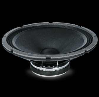

not really sure if this fits the bill
but it might hold possibilites
FaitalPRO - Professional Loudspeakers Made in Italy
