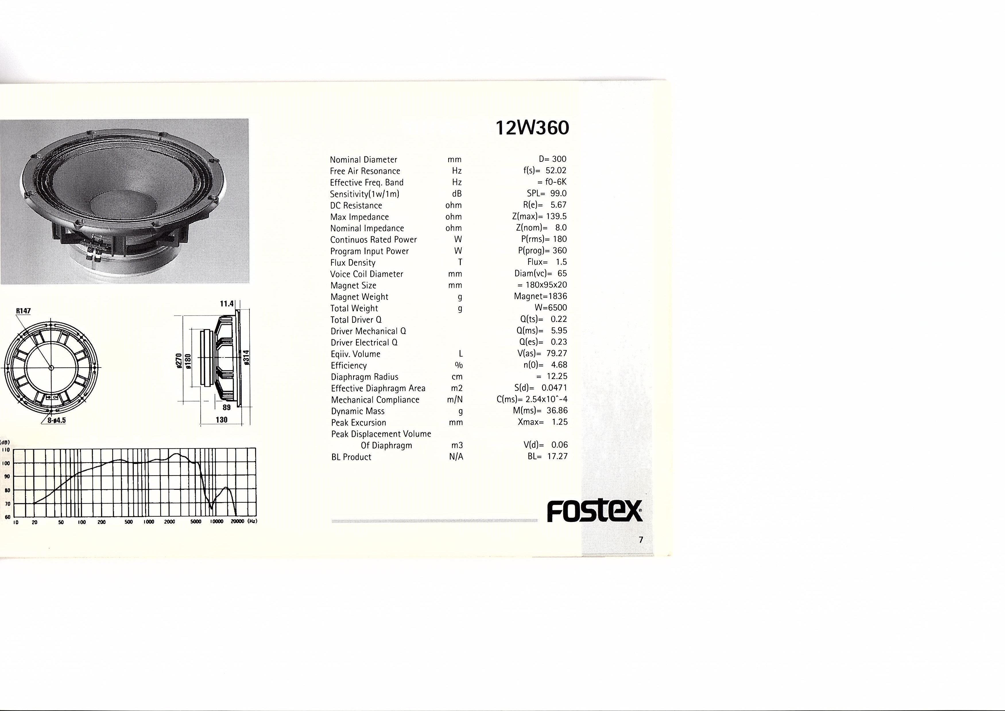

Additional supplement: detailed datasheet from Fostex brochure:P.S. - supplement to my last post #129:
here an URL from Japan with the Fostex 12W360:
ƒE�[ƒn�[�ì�íŠJŽn�@ŽR�…‚Ì‚r‚o‚T‚O‚Tƒ{ƒbƒNƒX‚É�@ƒtƒHƒXƒeƒNƒX‚Ì‚o‚`—pƒE�[ƒn�[�@12W360‚ð“ü‚ê‚Ă݂é
^^ 1.5mm excursion gives a fraction over 98dBSPL at 1m at 50Hz. Not adequate for most people.
Edit: I didn't look close enough and now see it's only a 12". That changes it to just under 94dBSPL at 1m at 50Hz.
