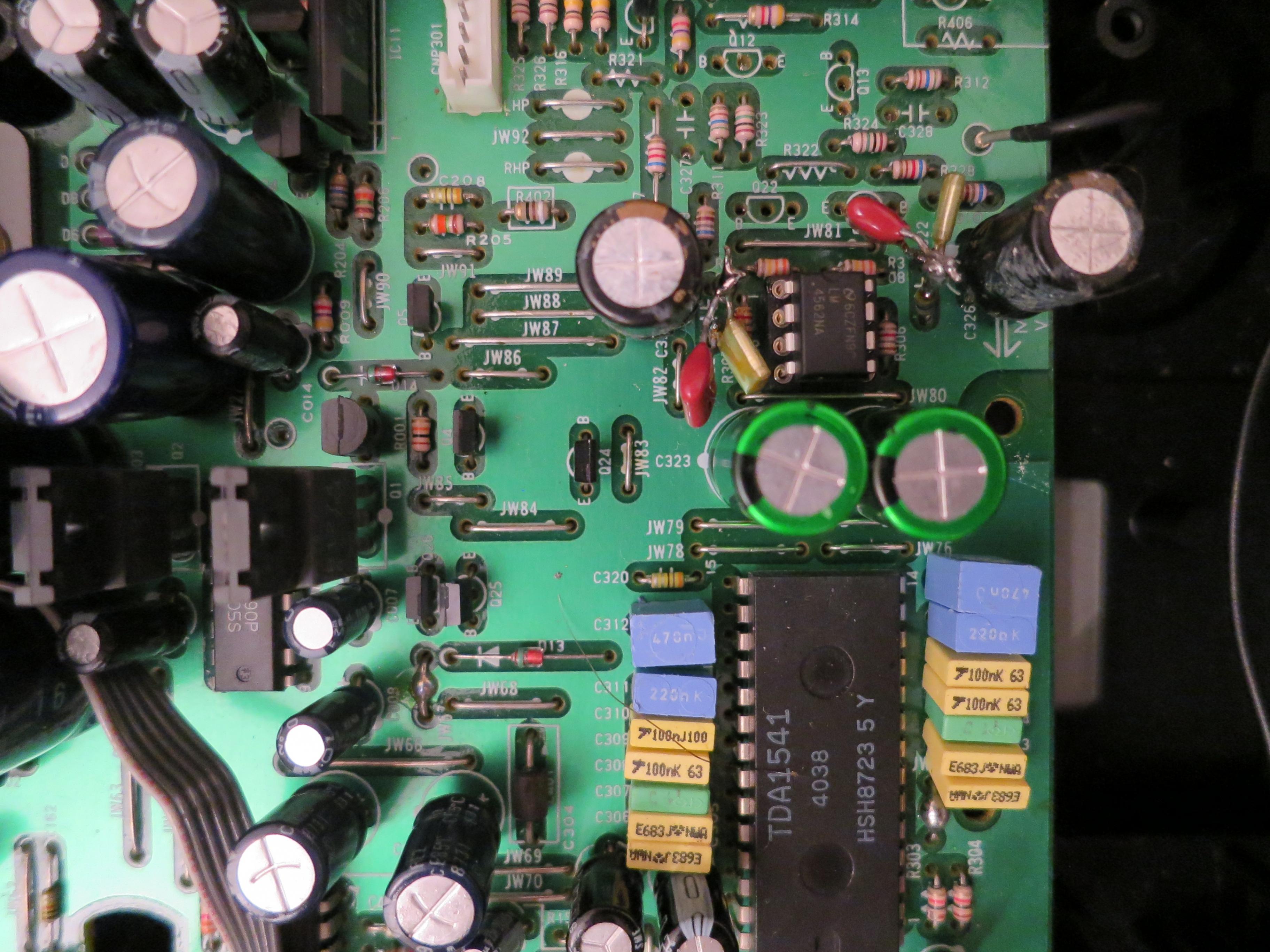

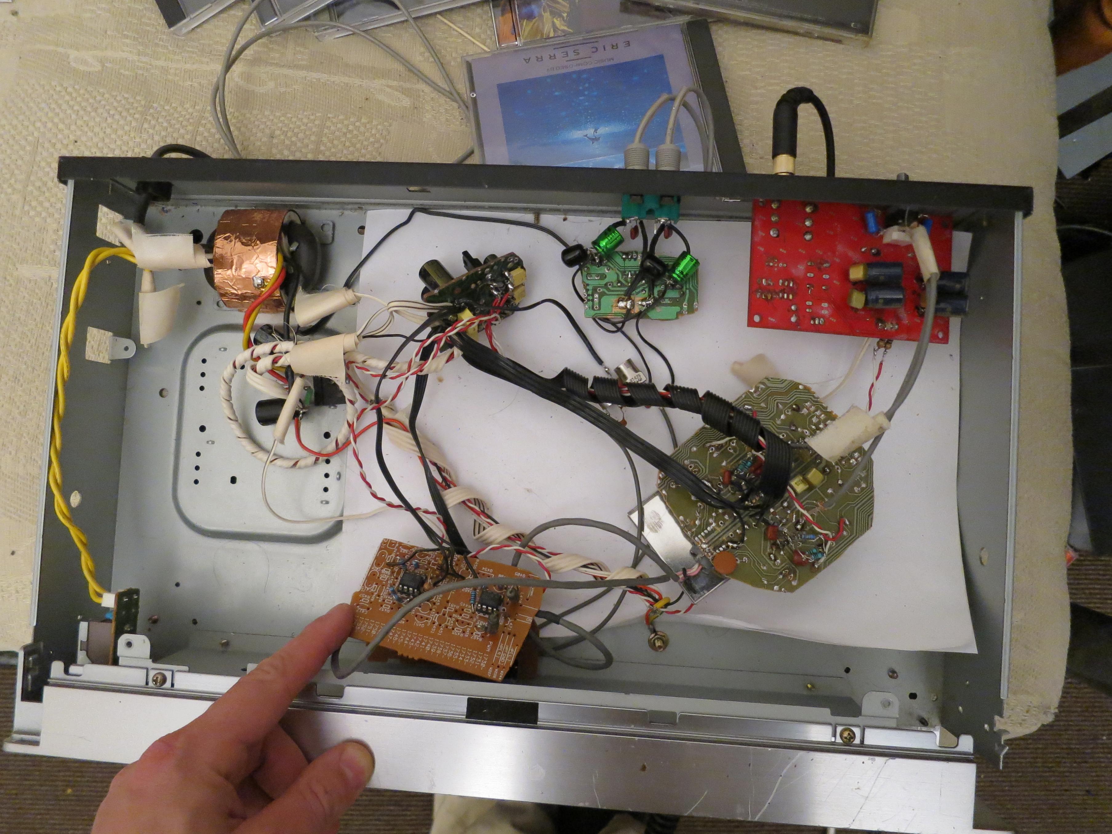

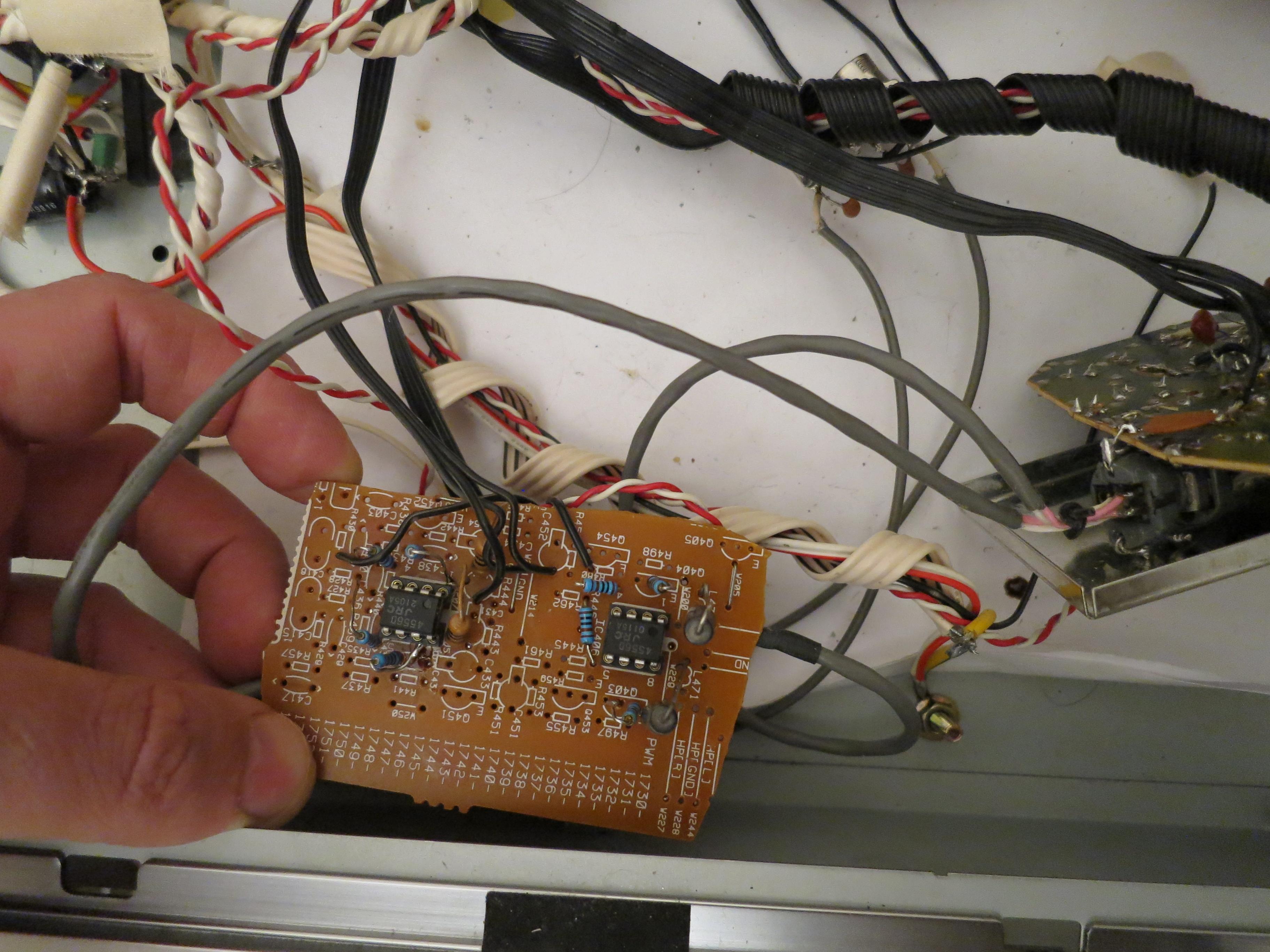

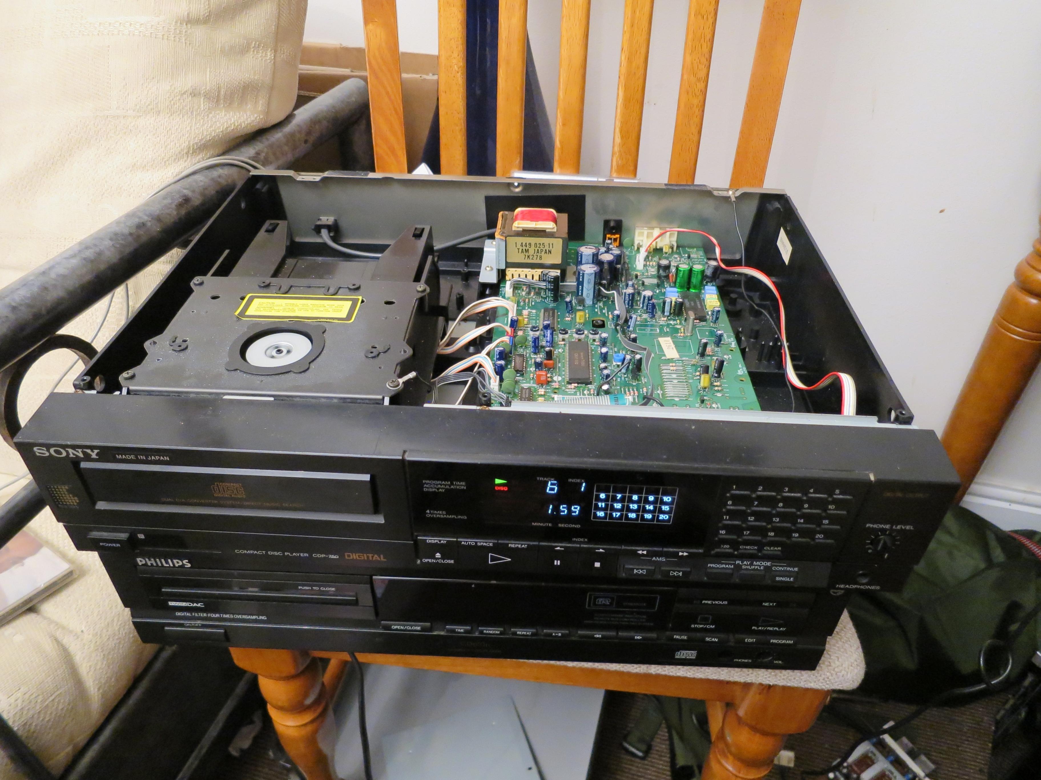

Last embodiment: OPA2228 for the playback preamp, paralleled njm4556 , then njm2043(much lower noise which also allow me to saturate the rec head a bit more with no background noise) in unity gain with common mode cancelation resistor(1k) for the rec tapehead amp, only an lm4562 with the usual 100 ohms series resistor in series with the 4nF integrating capacitor ,...as i/v stage for tda1541 as the Sony cdp750 doesn't even have a low pass filter in the output...anyway i have lots of passive RLC filters after that plus the tapehead system.Now I wonder what would be the use of a better i/v stage than this one...It's already perfect.
All i can say is that even the 1988 Technics test CD sounds wonderful on the whole system.As a matter of fact the rec head has about 400 ohms while the play head is 275 ohms and the bass is a bit favored by the system, but that doesn't mean that i have no highs...I will change the rec tape head with some other ones with a lower impedance(200 ohms...150 ohms) as i bought some new cassette players as a source for thape heads(aiwa-sanyo)and see the results.

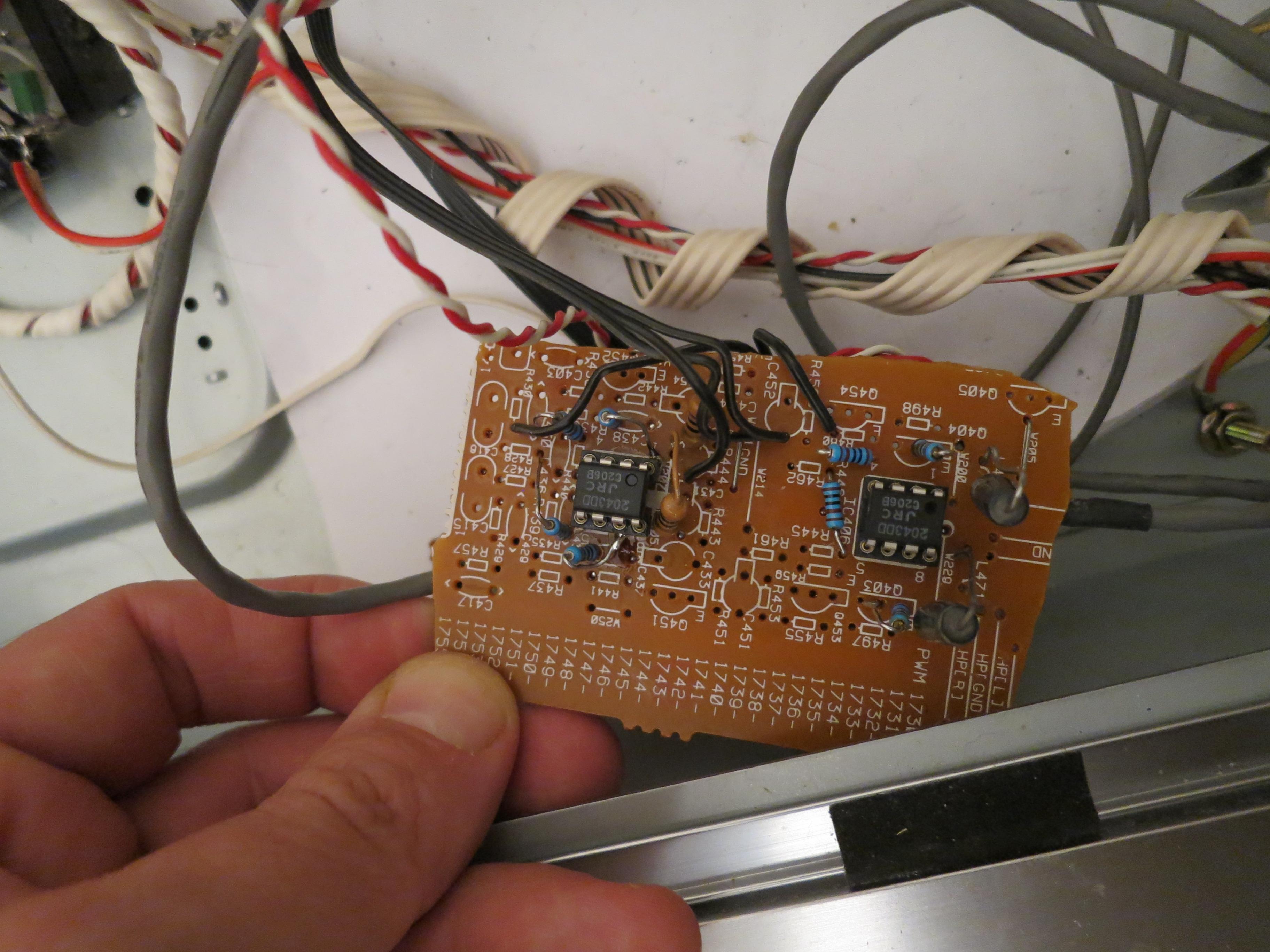

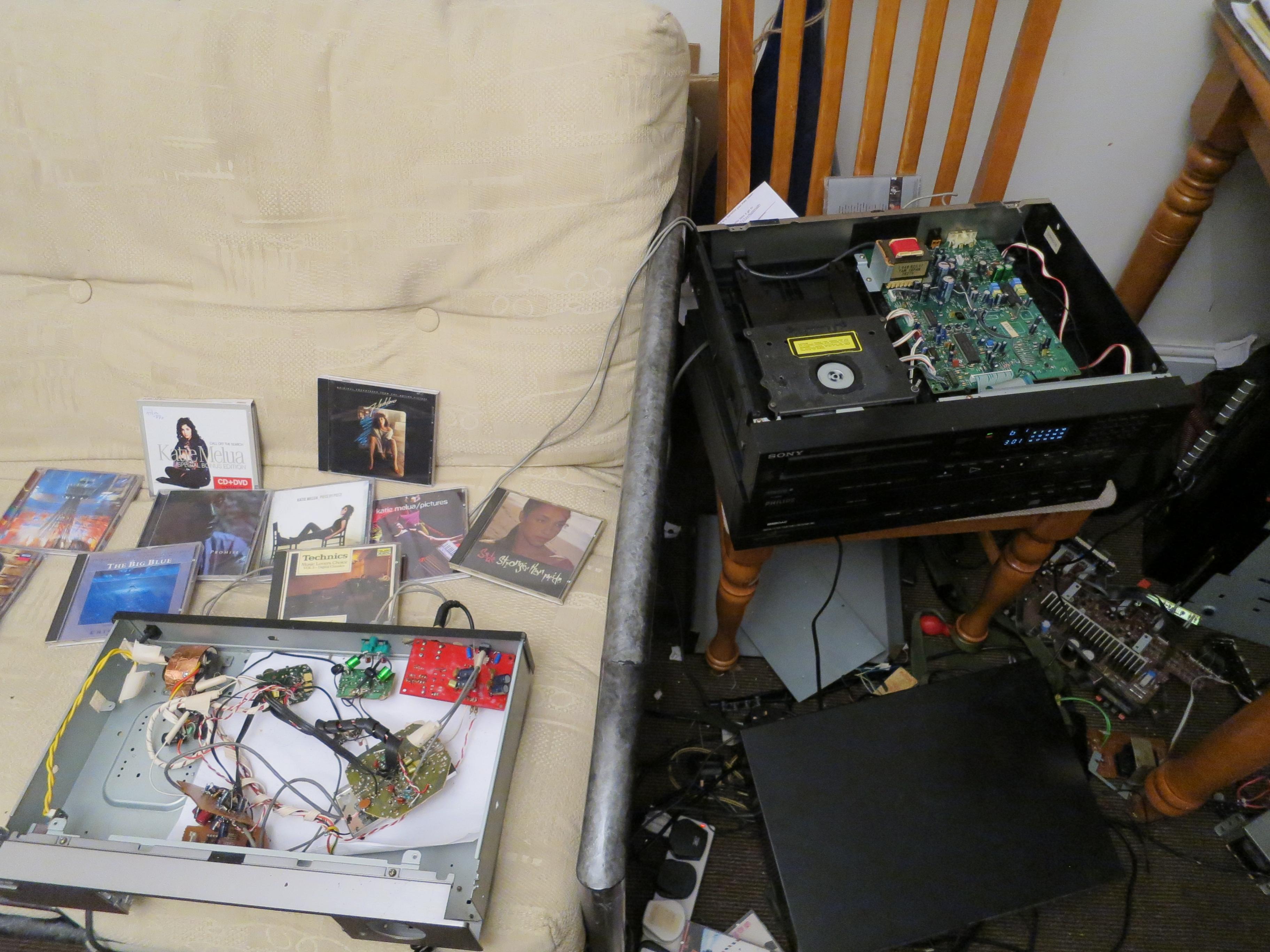

I'm a lazy person...i buy lots of vintage trash and i have lots of spare pcb's and spare parts...I could do very neat designs in Altium , but i find many pcb's that are easy to work on with a simple cutter and a side cutter plier 🙂 and as long as i never know what will be the final design looking like i prefer spider circuits for quick trials.Sometimes these spider circuits stay and work for longer than planned.
Well, you make it easy for yourself and that means you get stuff done, rather than spending so much time designing PCBs, ordering parts, agonizing over cosmetics...

Just for the record, i ended up using the lm6172 as i/v for The Sony player with tda1541 in the pictures above and i think that it will stay like this for a long time.It sounds so well against the lm4562 , i can't describe the feeling.It's simply FAST! As i use a TPA6120 based headphones amplifier with only a 6db first order RC filter in between the i/v and headphones amplifier , all i can say is that , if there are any ultrasound noises because this Sony has no low pass filter...i can't hear them. Most probably , the headphones can't reproduce them and the LM6172 can't be bothered, it will amplify linearly anything you can throw at it, no TID or THD will result because of any "fast edged" signals due to the DAC as many told us. Because it has only one output op-amp, I won't try any bipolar front end i/v stage and anyway i don't feel the need for such thing.For a high current output 16 bit dac, lm6172 is the way, its noise being completely irrelevant.I can only hear the music.
Post 51 looks good, would be cool if you find use of the unused holes though.Which headphones are you listening on?
Well ...post 51 is not alive anymore, i have better circuits and anyway i found out that i simply made it too complicated.Even the simulations were based on wrong assumptions.

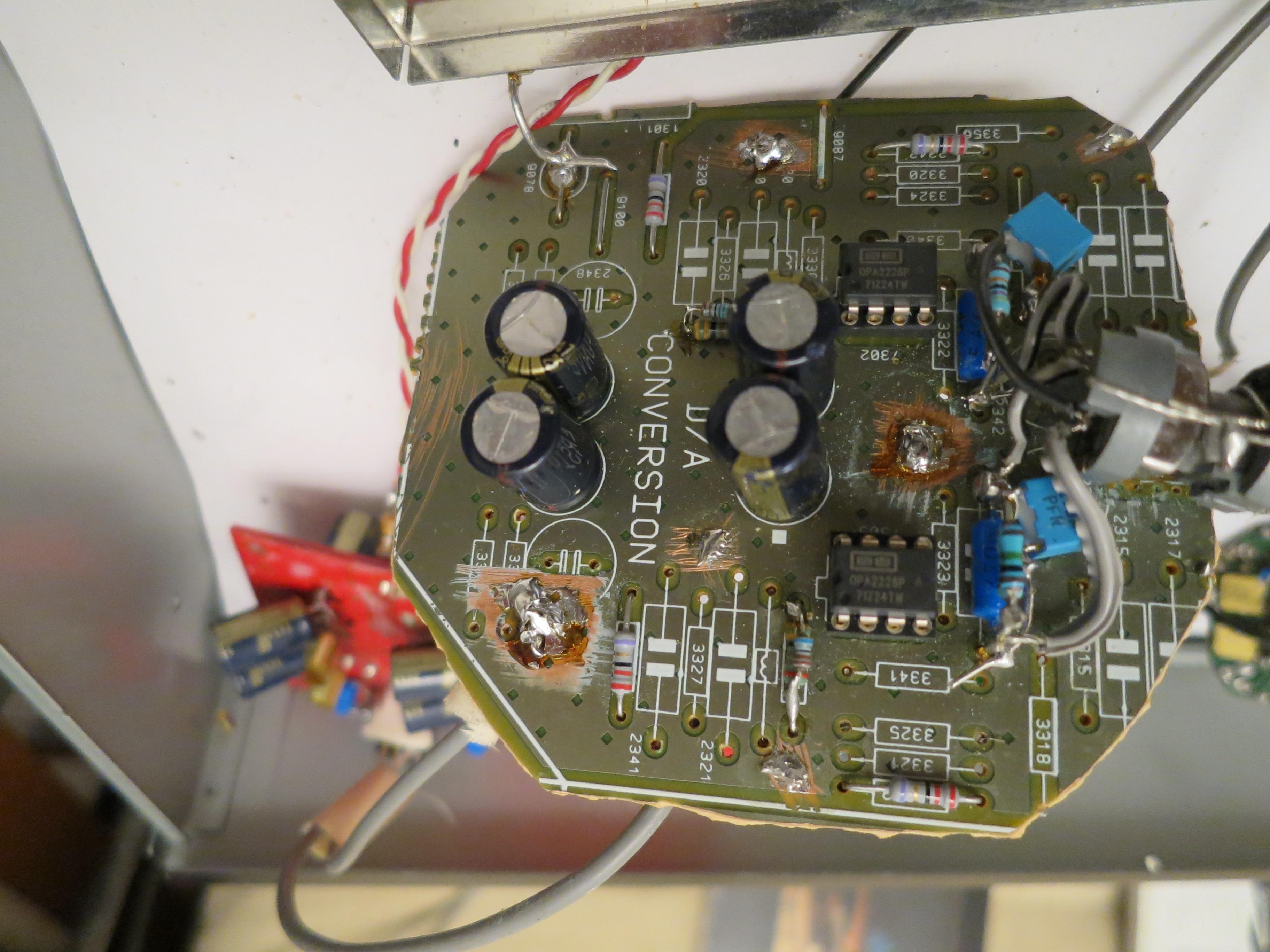

But of course...as i'm moding my Denon dcd1560 to have the pcm1701 dac supplied the same as in Luxman d103 which was the first "lampized" player , in its stock form, by the manufacturer itself ...i might do it the right way! For the start i just replaced the i/v stage as in Luxman using ada4898-1 and a lm4562 as the output stage after the passive low pass filter.I suspect that i won't need any valve at the output as the digital artwork and transport in Denon is vastly superior to the Luxman.Just because i could use the ADA4898-1 made me a bit confident that i might use different gain and capacitor in the feedback , removing the 270pf capacitor at the dac output.I'm just trying to make it work the right way.Denon had a different vision which was based on upc4570 as i/v stage.
