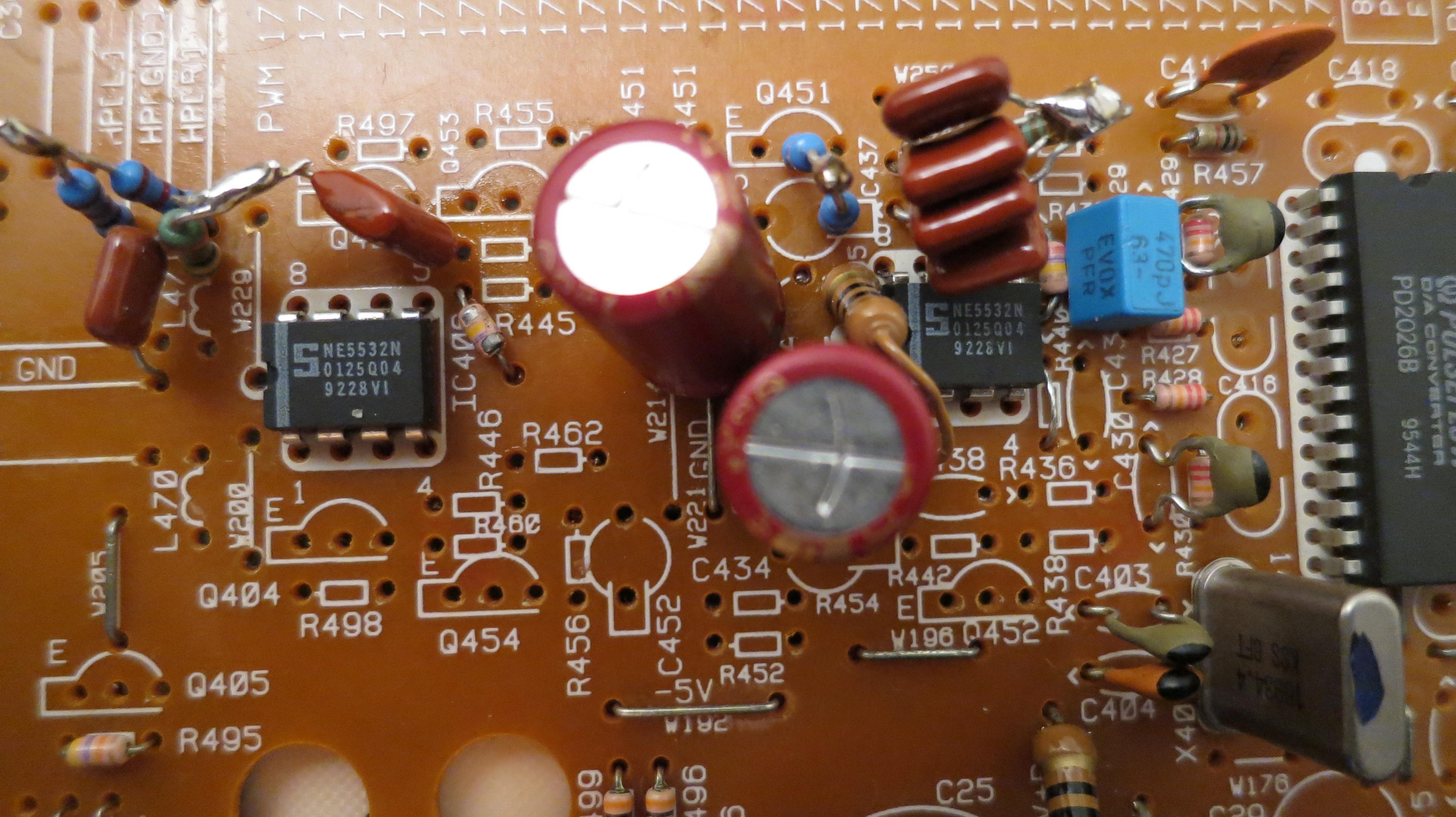

The ideea is that you do perceive that the sound is better, not distorted...as the "distorted" connotation is a bad one...And that is the case with tons of overkill designs, applauded valve amplifiers, exotic mc carts and so on...
Many of those who don't like the cd's never had properly "modified" cd players and you can see countless "non-oversampling" whatever you might name it over the whole internet, but you can't argue with people's subjectivity!
Lampization is made now by guys who have no electronics knowledge at all and their clients consider them the new Gods of electronics! I may be competing for a God role too 🙂)
I'll see if i'm lucky!

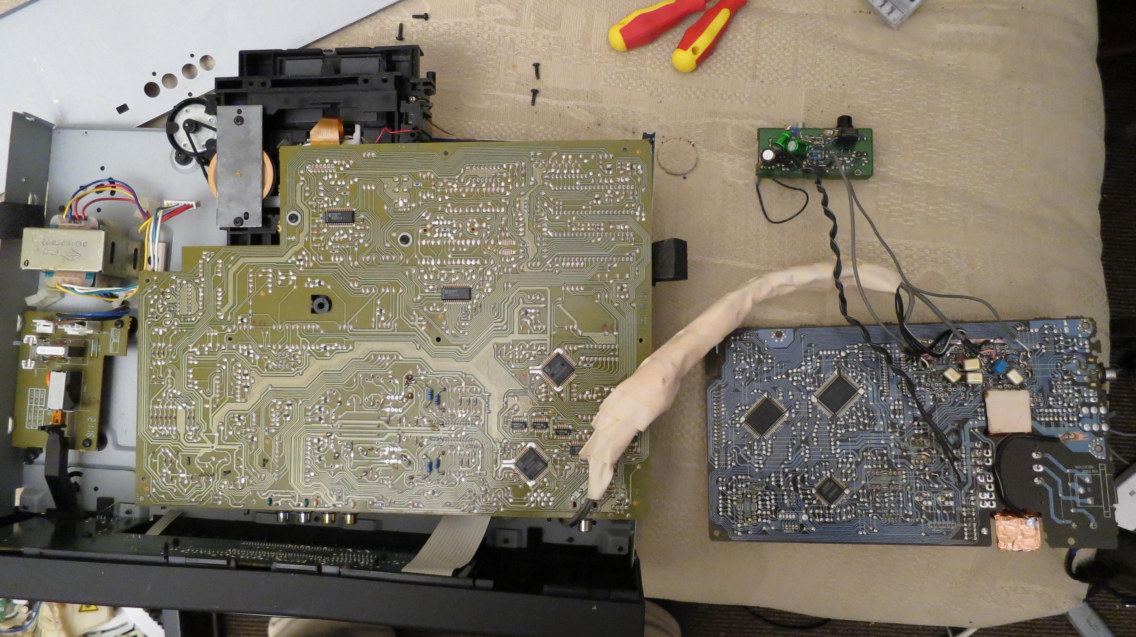

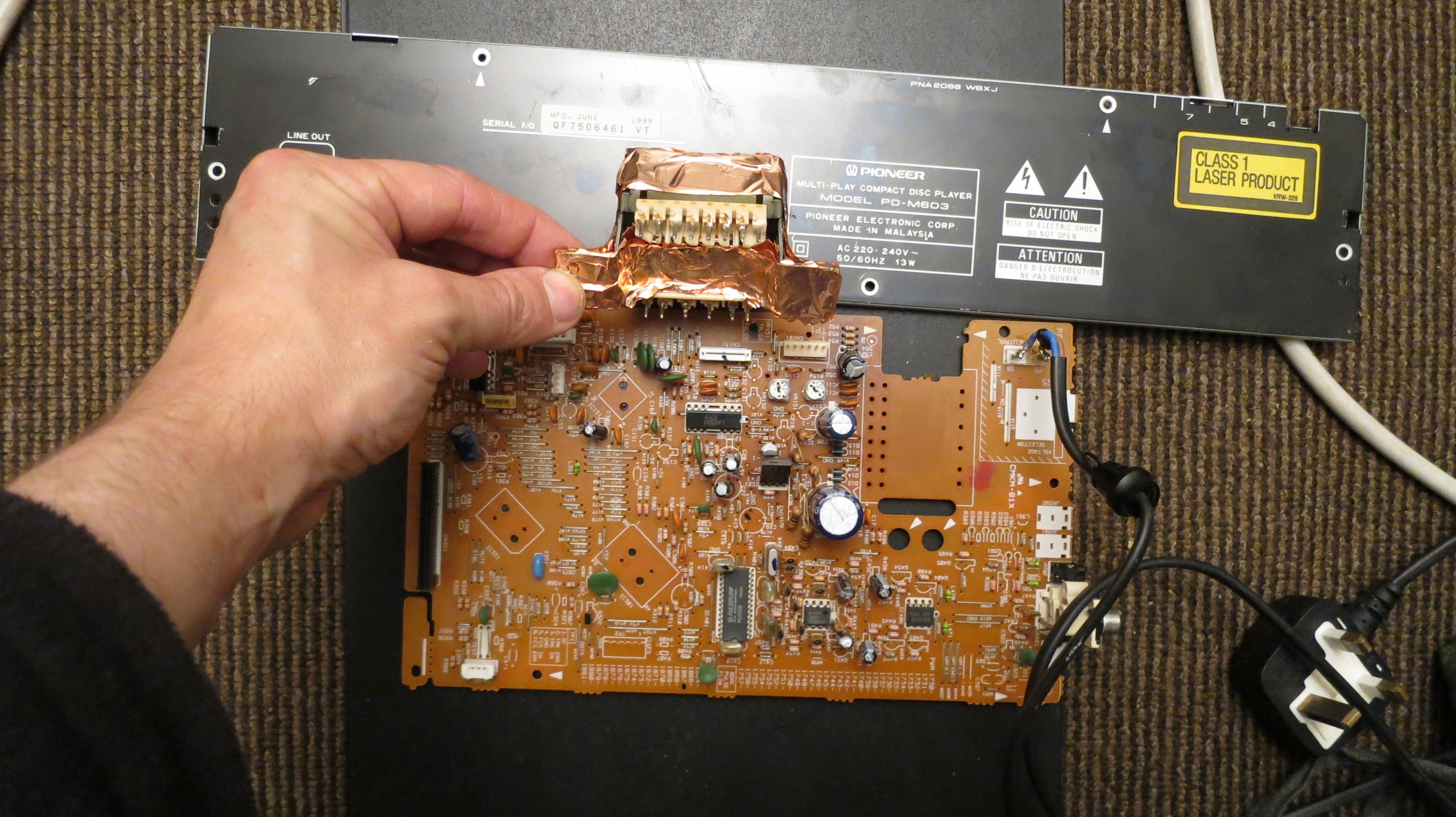

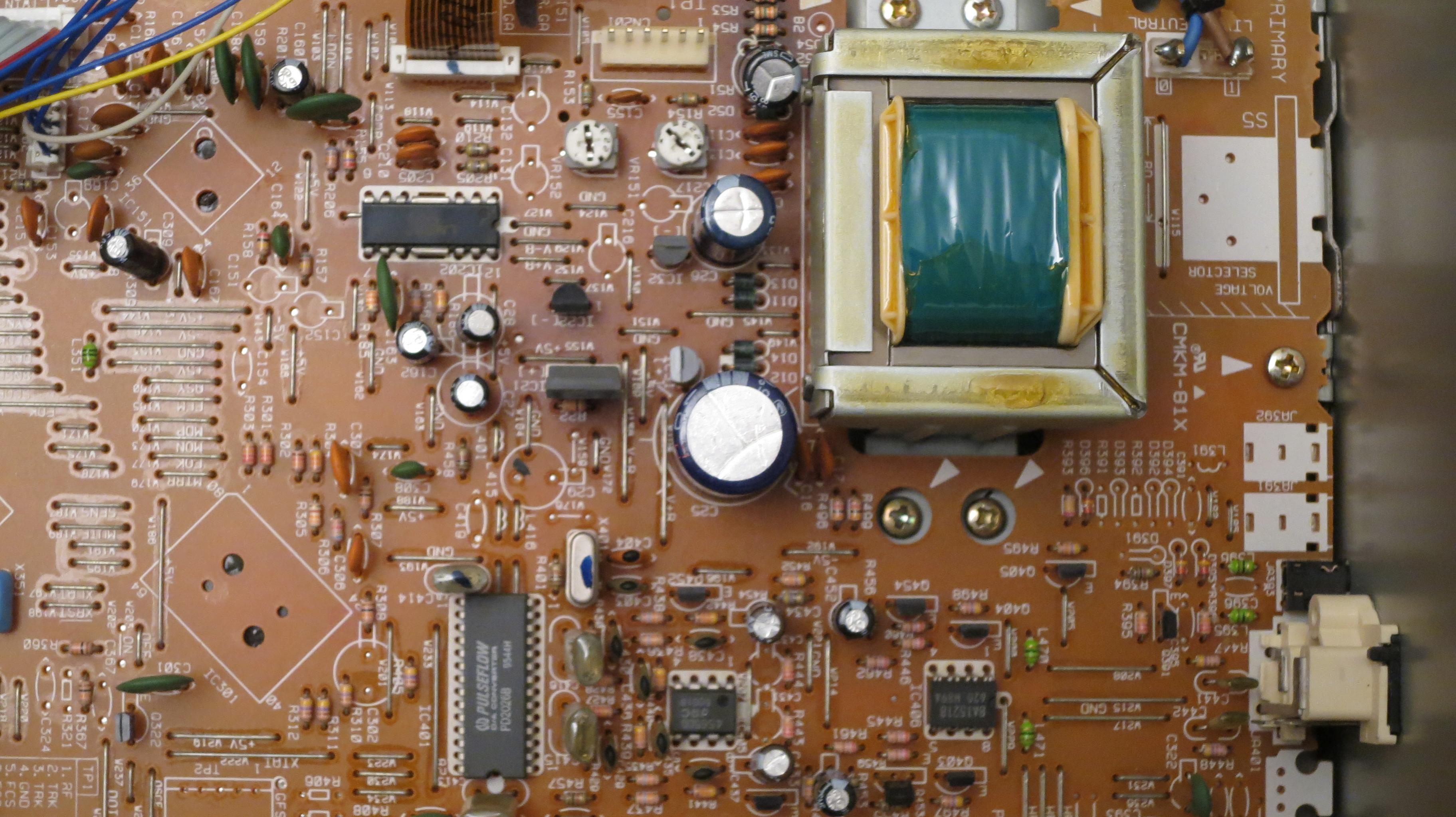

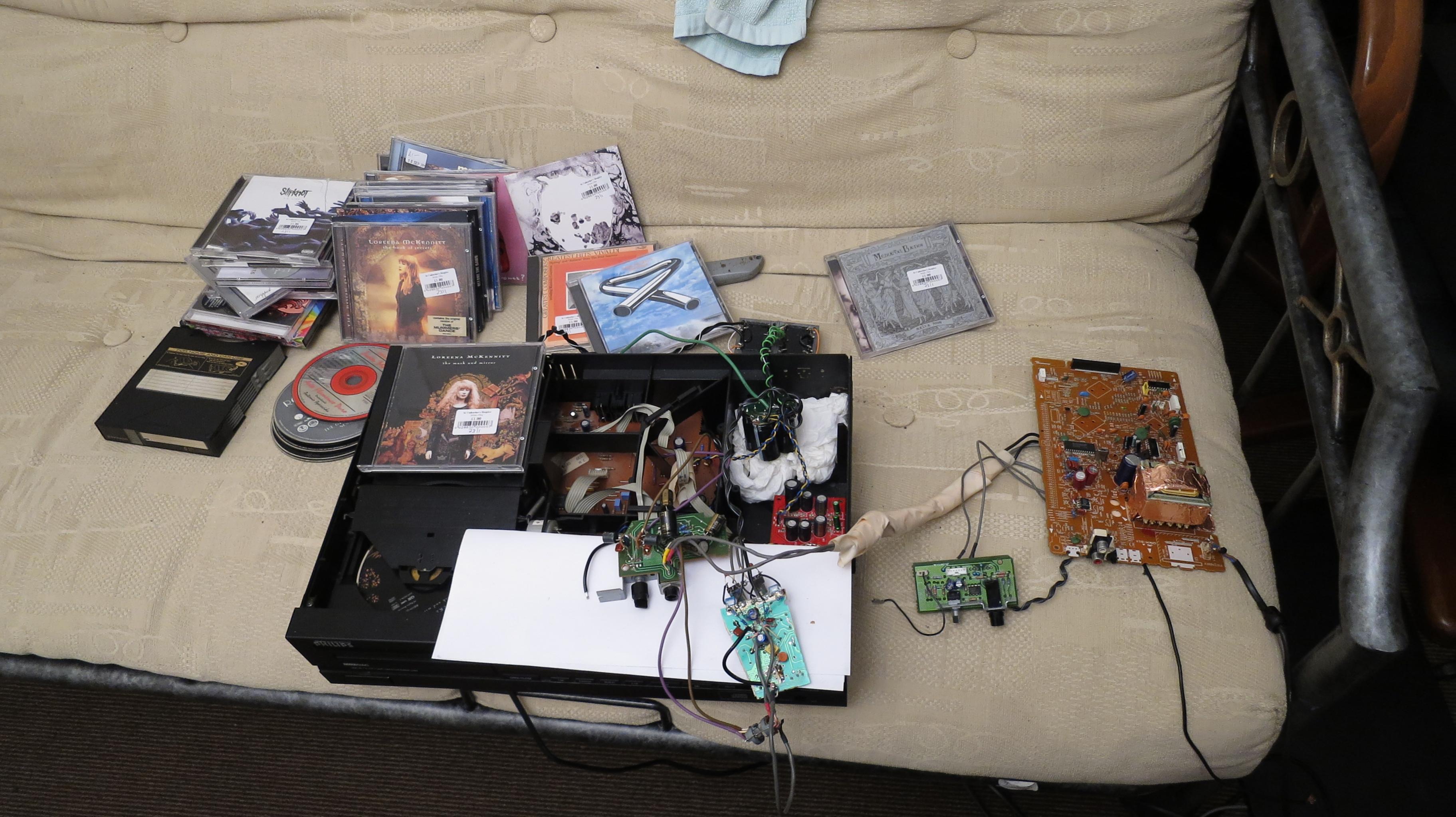

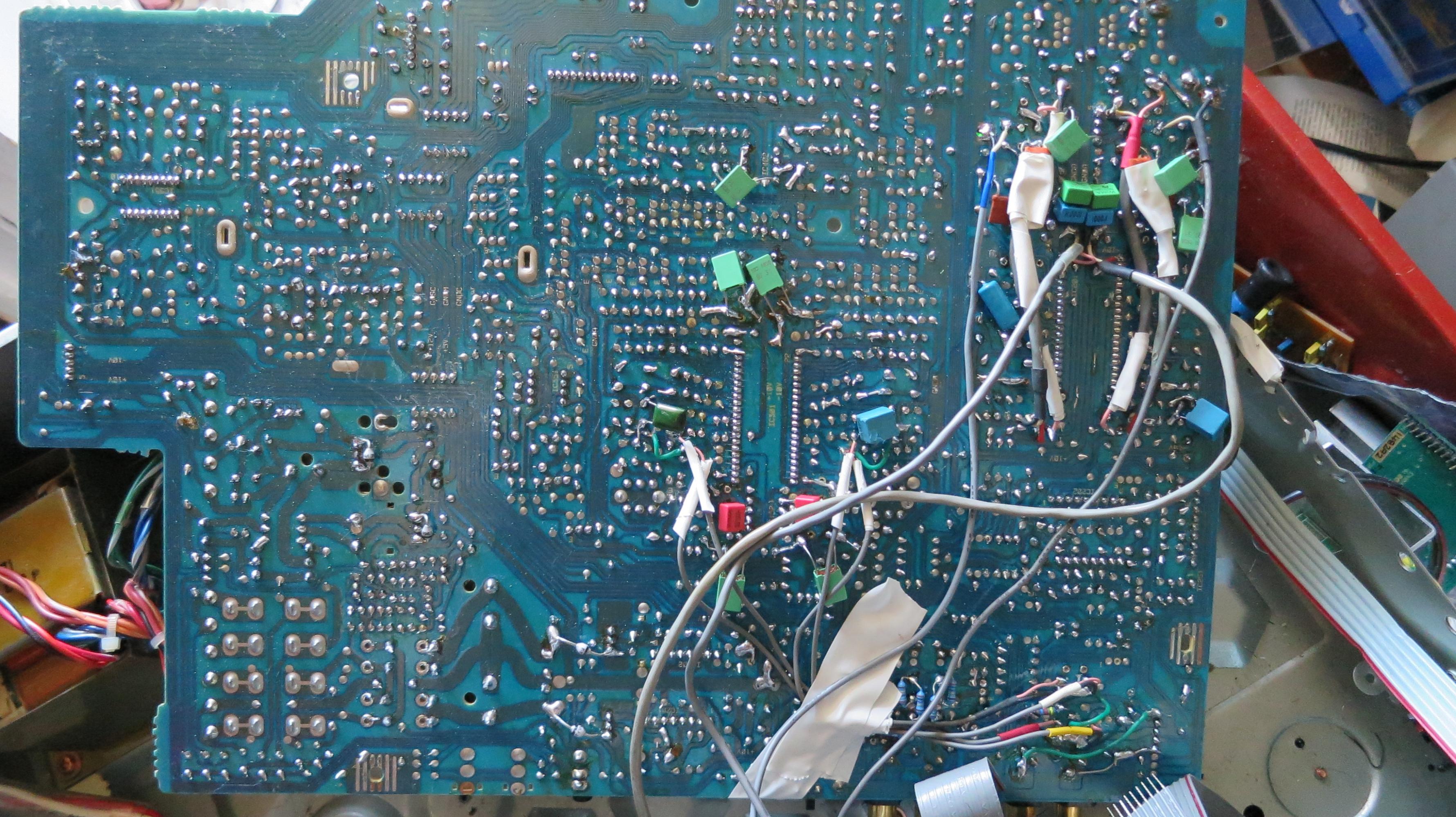

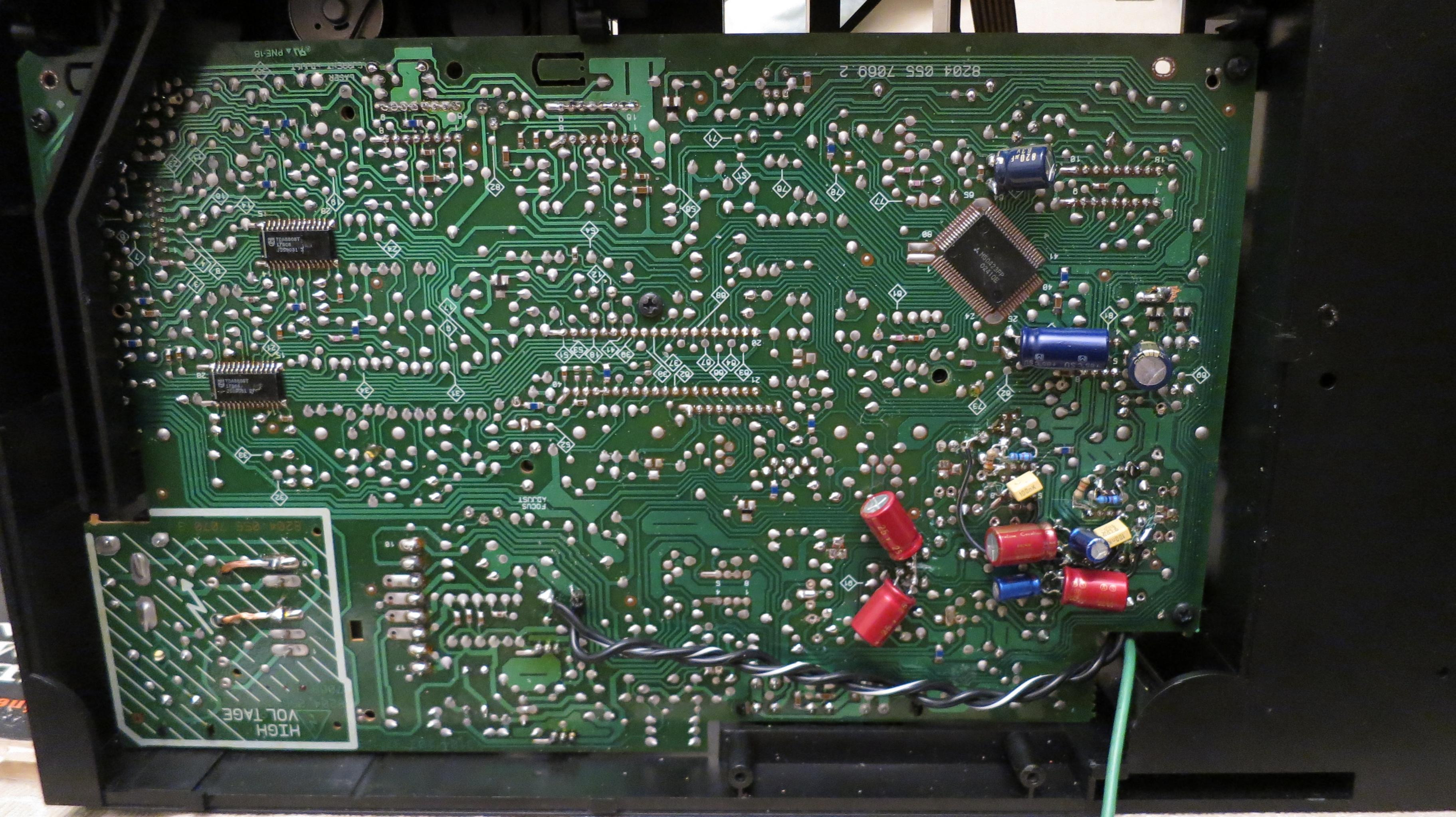

The price i payed for this is 20 pounds per player + mod and about 2-3 days of trial and error work per player...I can see in the future new audio guru's offering 50 pounds per any damn cassette double deck just for the tape-heads inside and maybe the cd-players will rise in price again like the cassette players! If you have tons of useless cd players and the worst quality cassette players that nobody was paying a penny even in their good days , this might be an occasion to contribute to this topic and sell them for real money 🙂
So being a bit less sarcastic, if i say that my mod is the best for the cheap cd players it is because it's the cheapest mod that works to my ears!

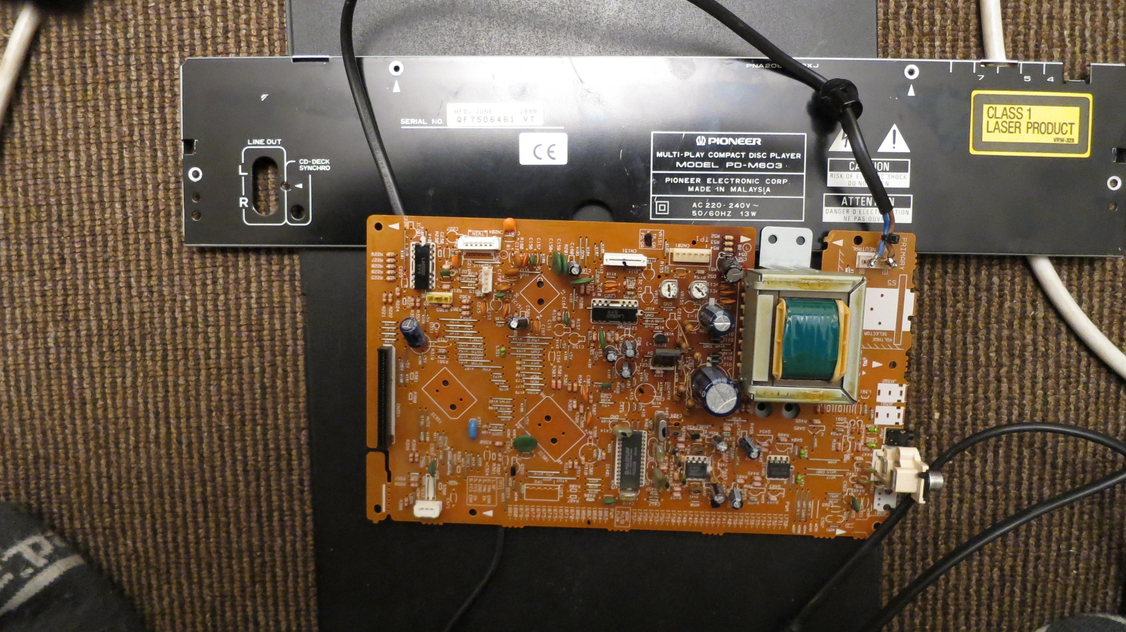

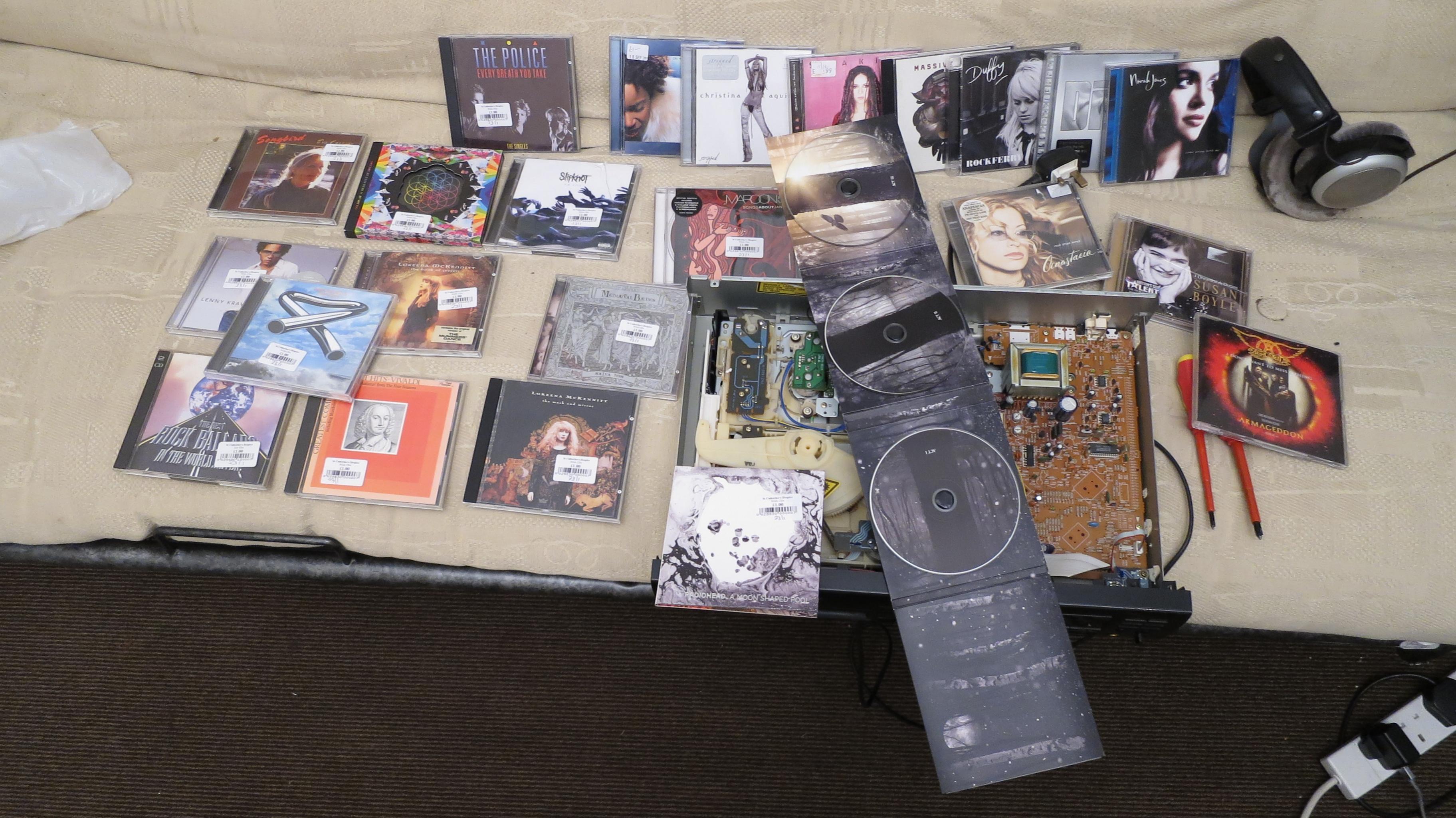

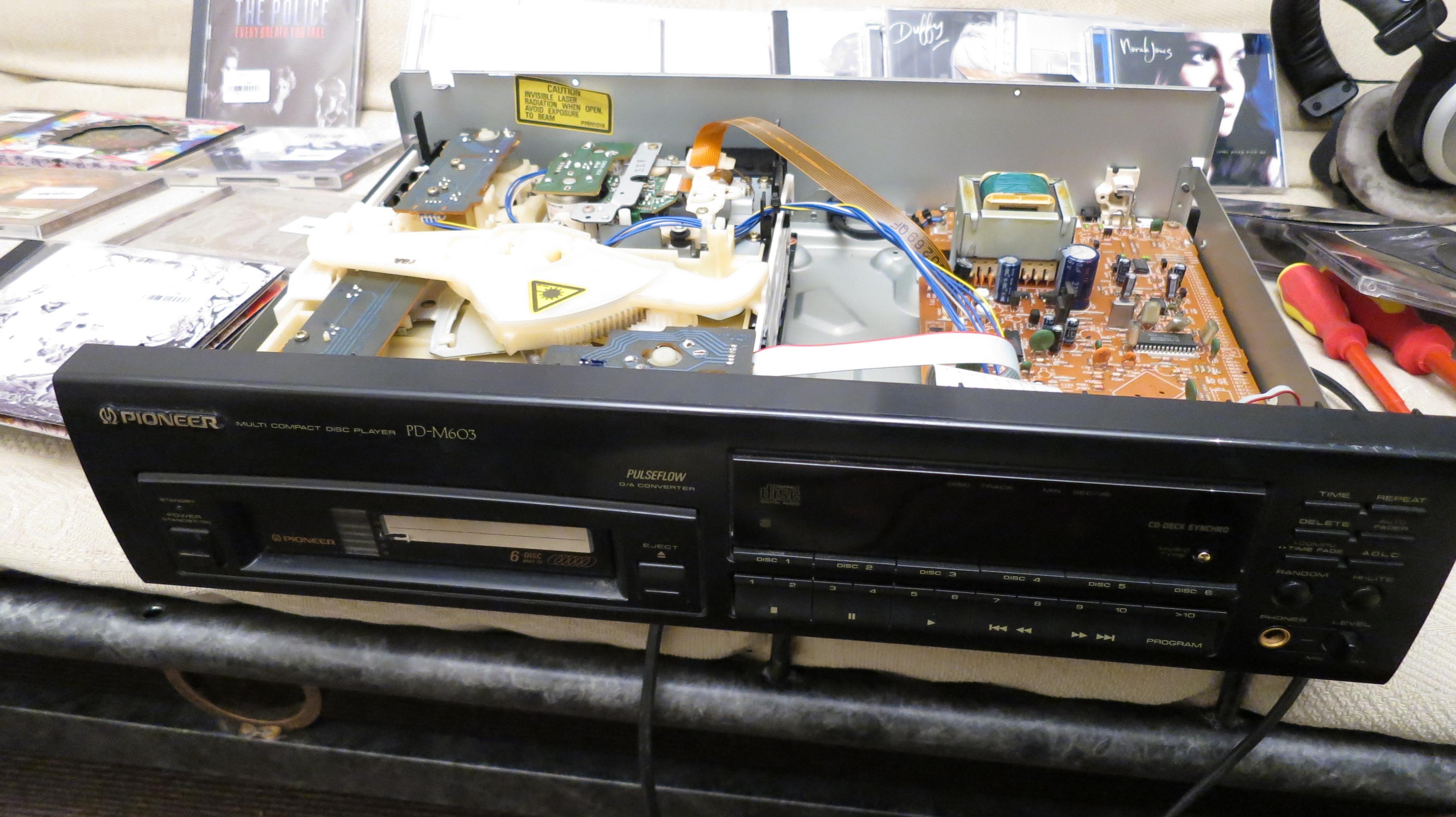

Just to understand the sheer proportion of this madness that took over me...I just bought another 15 cd's for 5 pounds(very good to as new condition , not the ones up right, I bought those for two pounds... ) and a Pioneer pd m603, considered to be a worthless piece of technology by many, including me as i have another identical one at home...Unfortunately i won't improve this one , i'll just make it a donor for organs to be used with the cd951...as it needs a bit cleaner sound that it has now. And...a smal surprise as in the Pioneer there were more cd's with Rod Steward and Celine Dion.I payed 10 pounds for the pioneer and the cd's inside are allready woth it!
Now there's even a tougher question to put: should i destroy the Pioneer to improve the Phillips cd951 or the other way around, to get parts from Phillips to mod the Pioneer as every single review of this Pioneer is negative.I am actually listening to it right now and on my headphones it doesn't sound really bad compared with the stock Phillips! I might sound even more misleading to some as i like many cd players in their stock form too...given that you have a well mastered cd to play, but i am mostly a headphones listener and i don't even have the best of them...

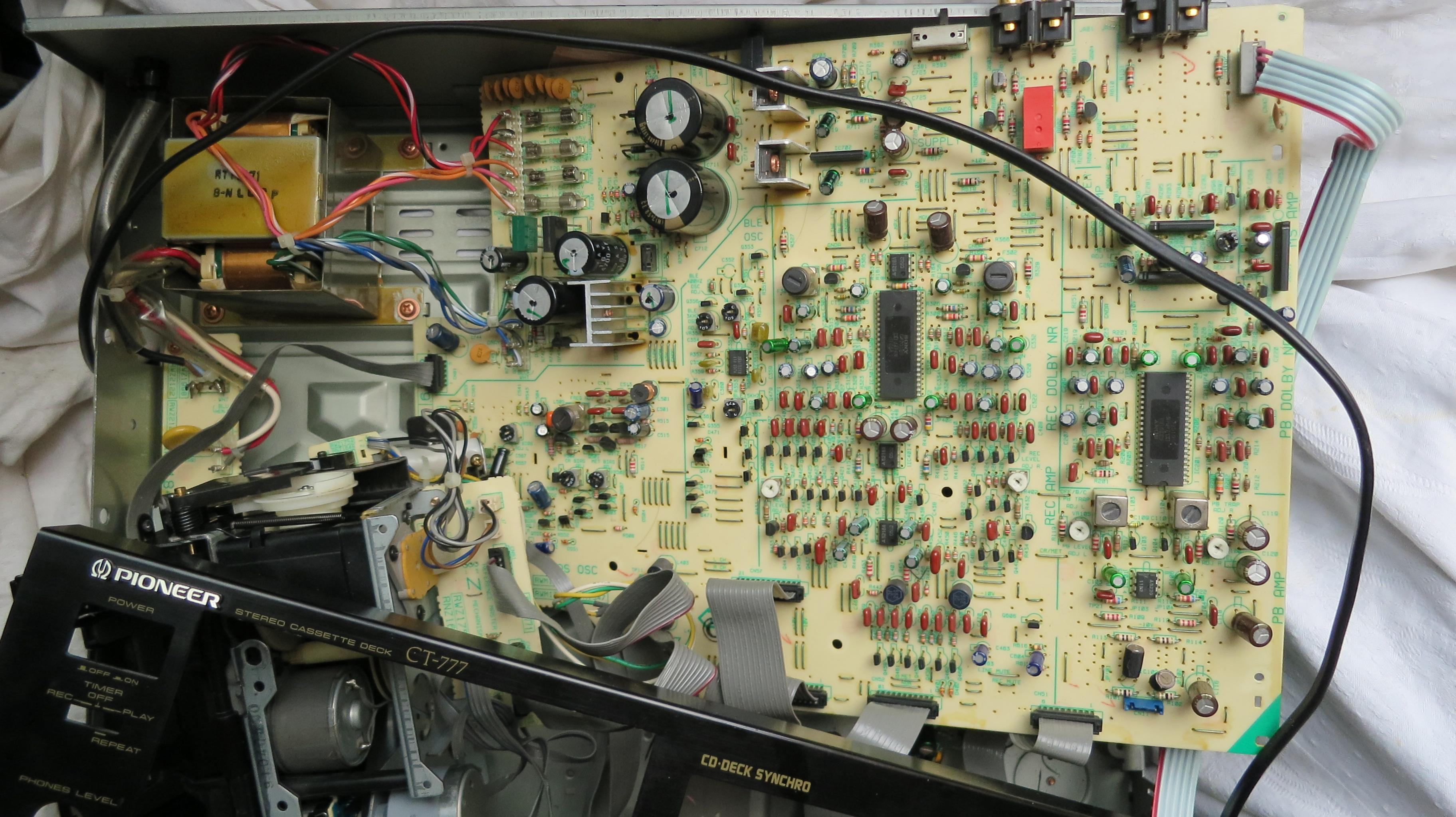

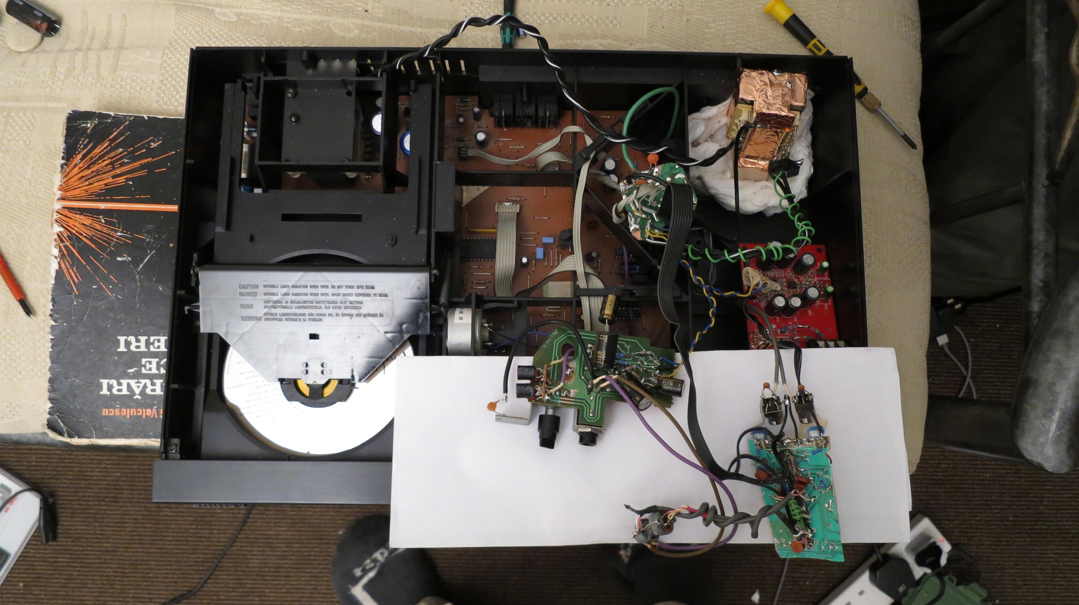

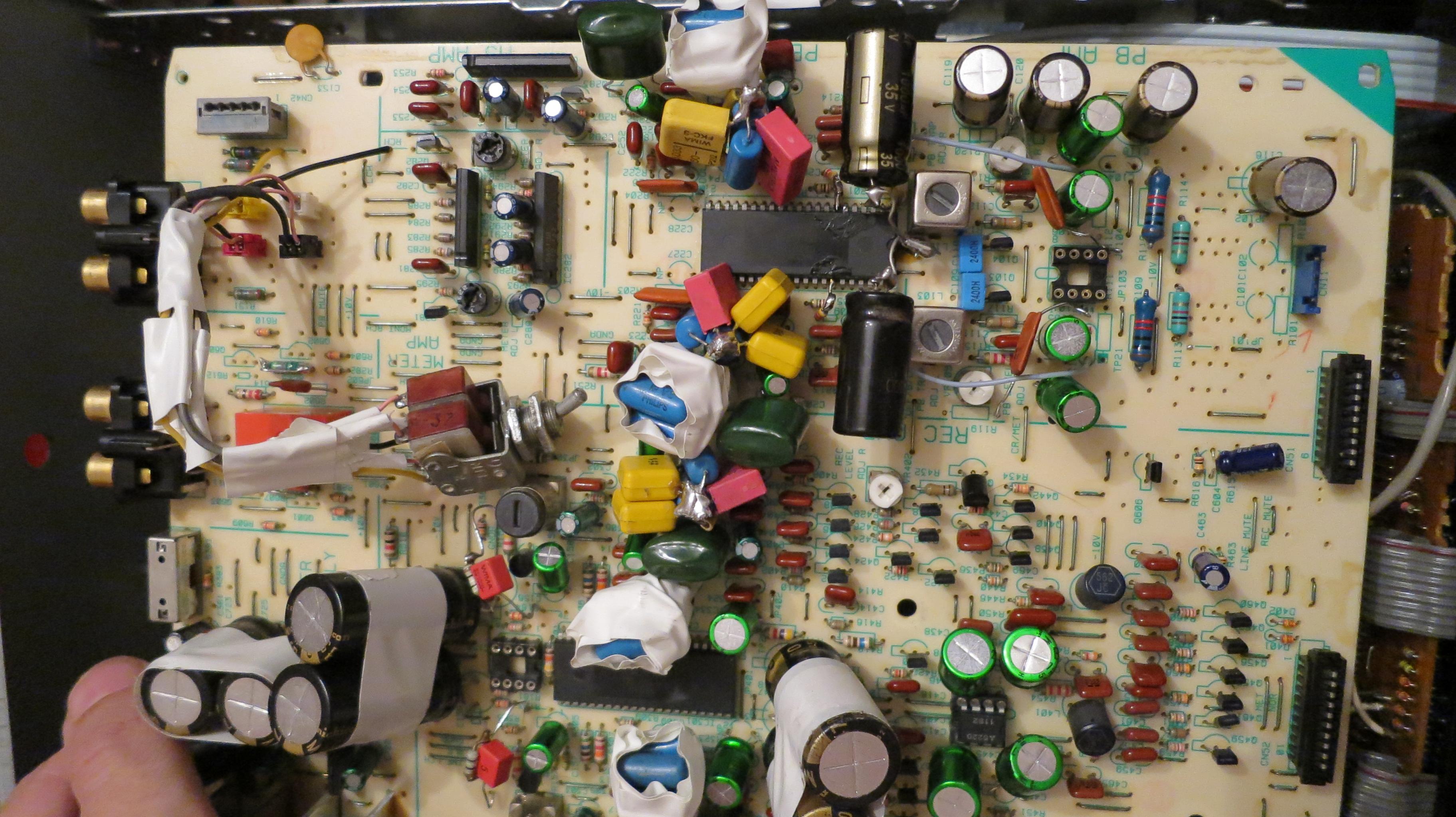

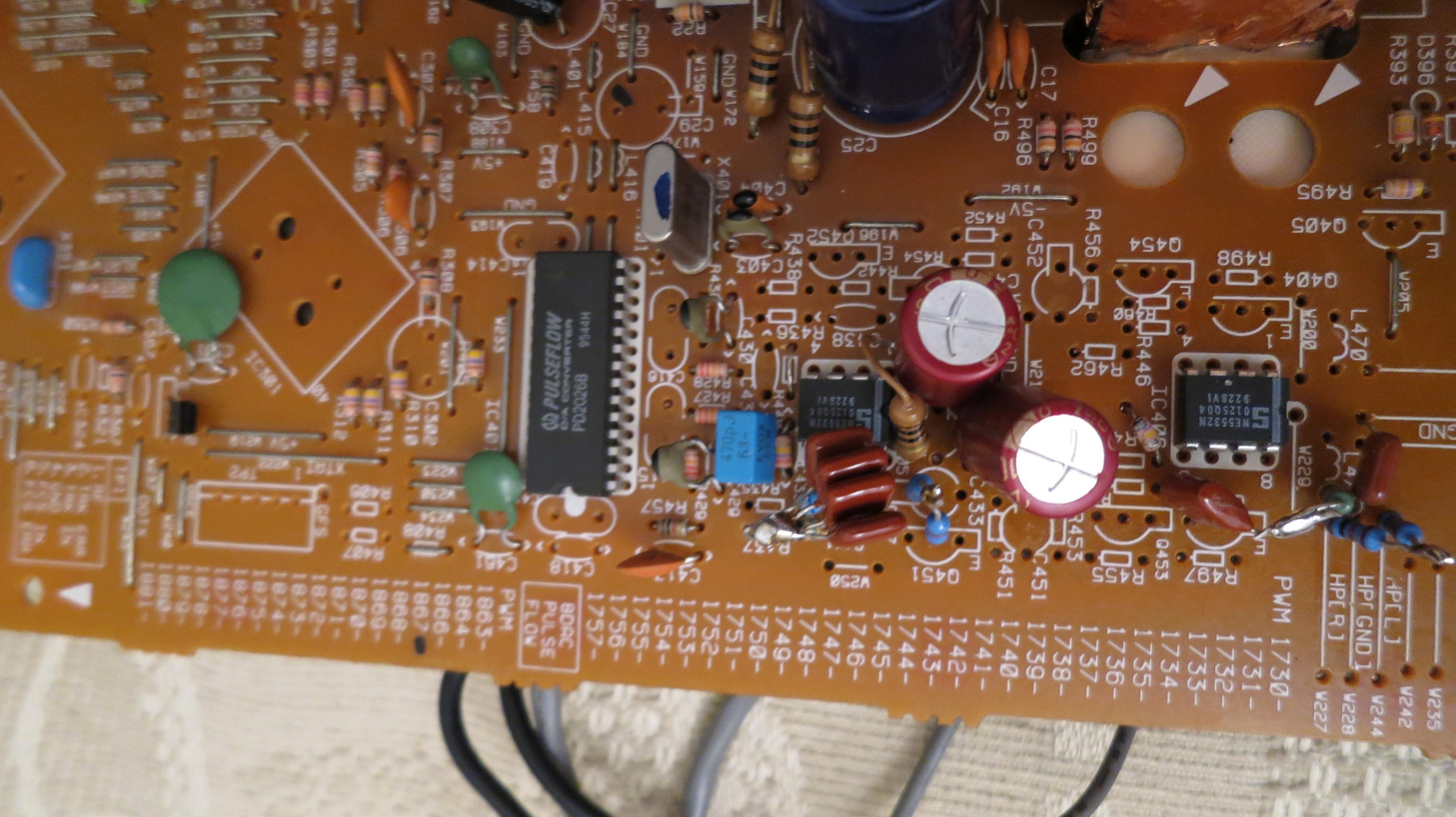

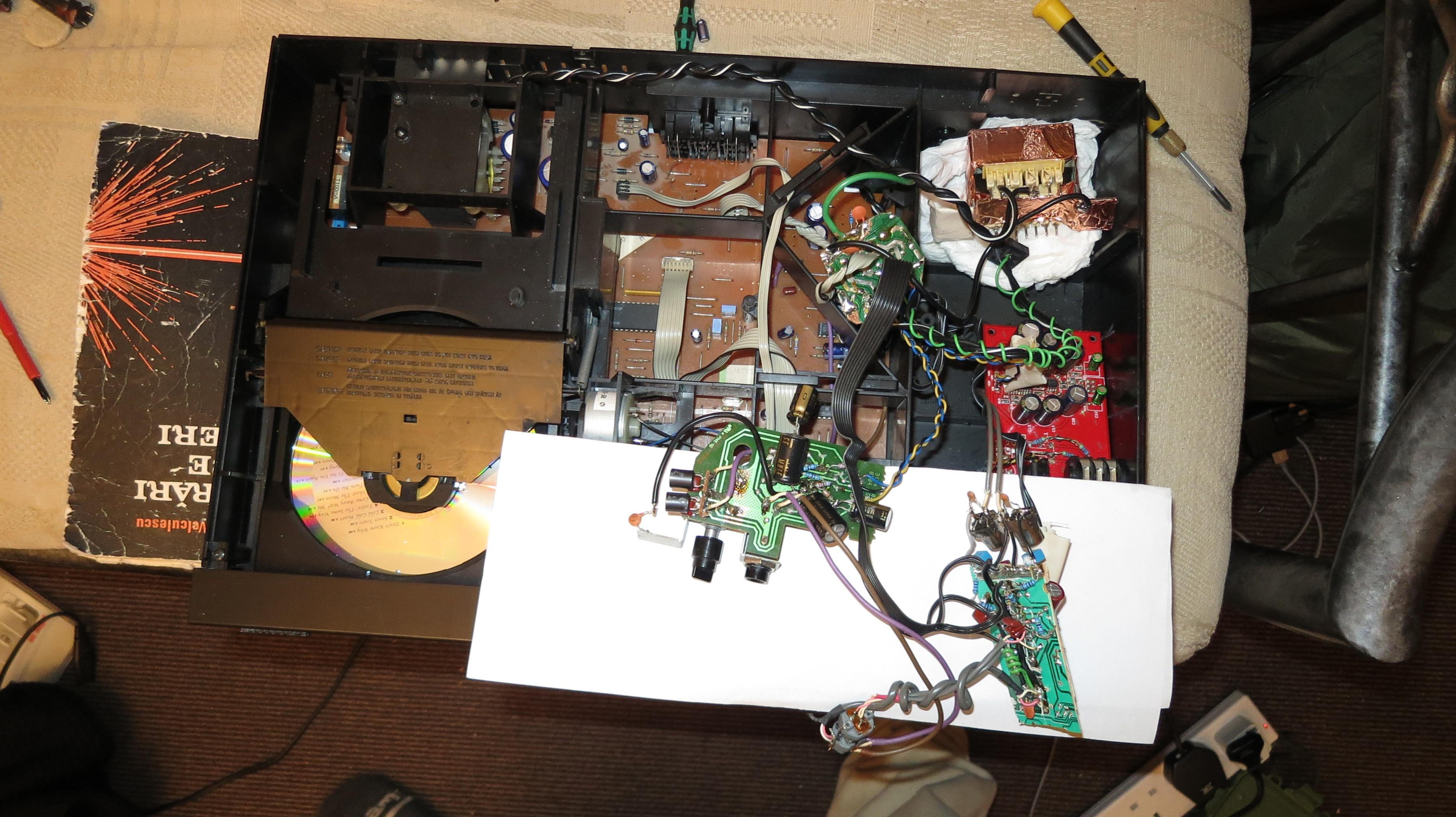

Tried to cancel the internal noises of the cd951 from the tape heads by transforming the new Pioneer 603 into a full playback preamplifier attaching also the modified njm4556 headphones amp to it. with no success.With no filter and shielding before the rec tape head it looks like an impossible task.
YouTube

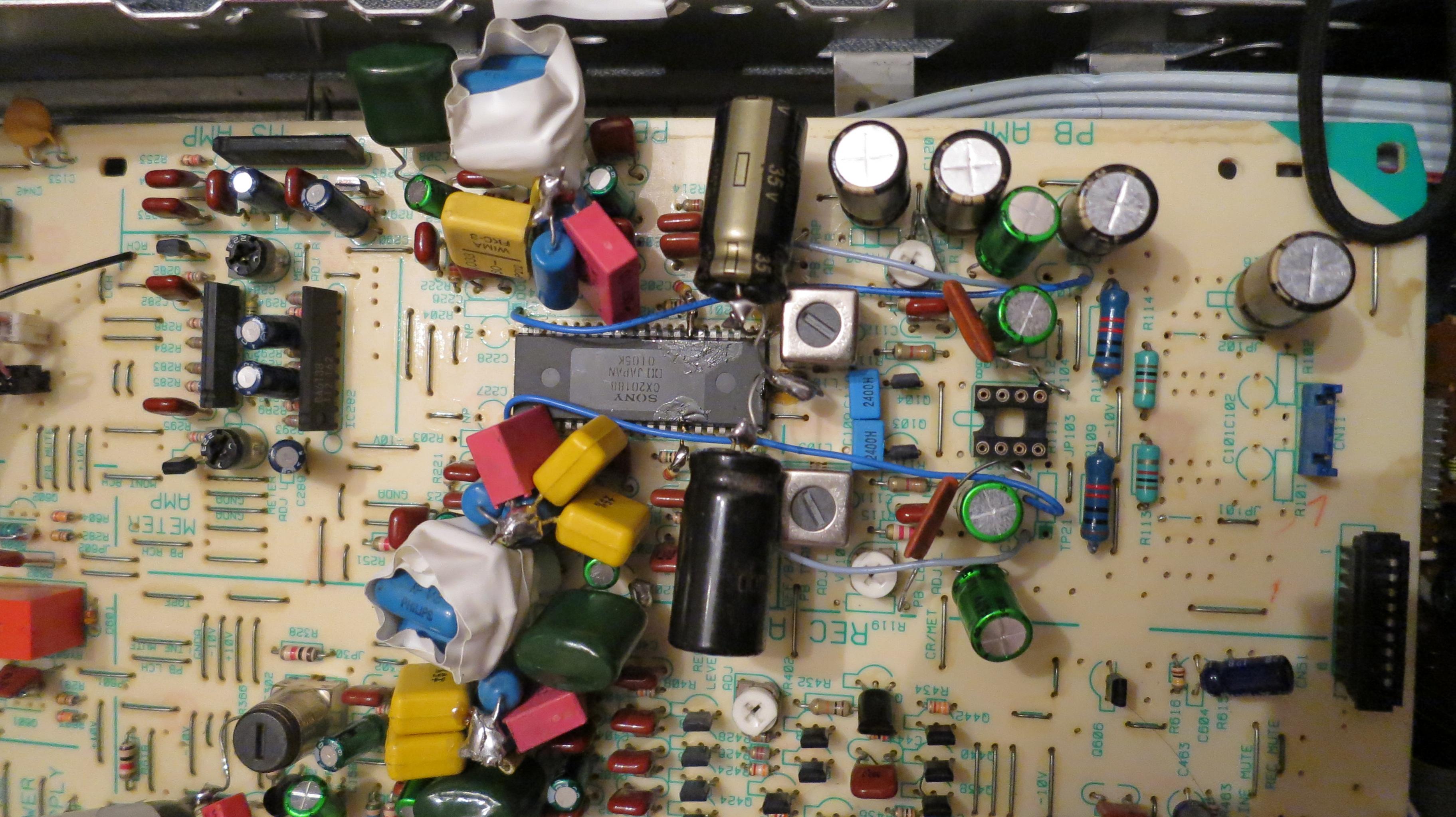

I doubled the gain of the playback amplifier , modified into a complete pioneer ct 777 playback amp with the original components values, sacrificed the CD951 for just 6 resistors and 4 capacitors to decouple the power supplies of each module, modified the whole wiring o that i can have no audible hum at maximum gain and maximum rec head drive.Now it sounds like a professional "effect box" 🙂
The noise that you here in the movie is caused by the camera. Be aware that i removed all the muting transistors everywhere in the audio signal path as well as canceled the lm833 based filter stage after the I/V.It might be the time now to look for better op-amps , but i really doubt that any op amp on the market is able to make this thing sound better than it is right now.

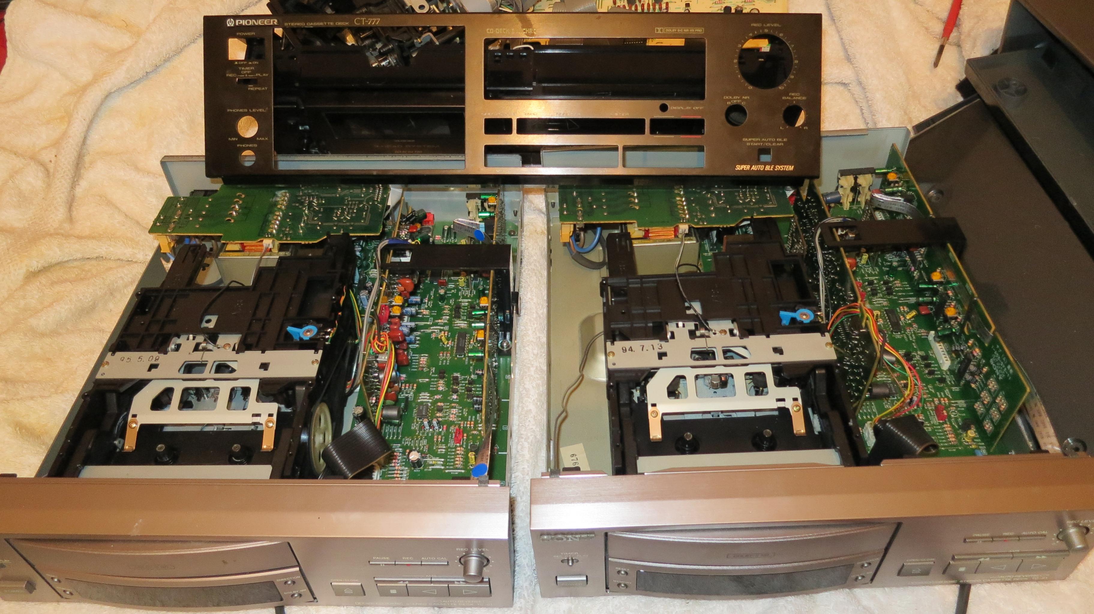

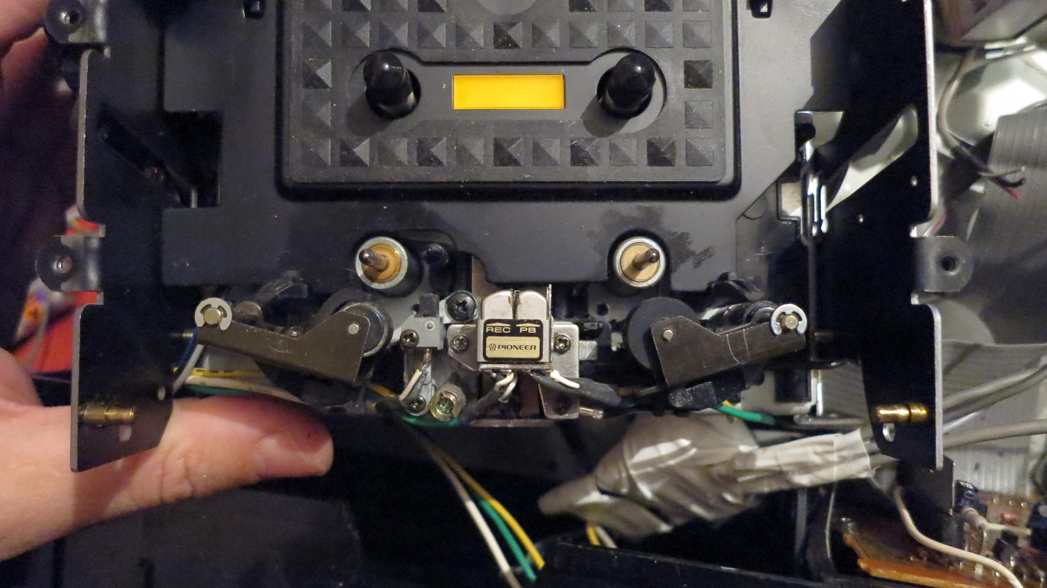

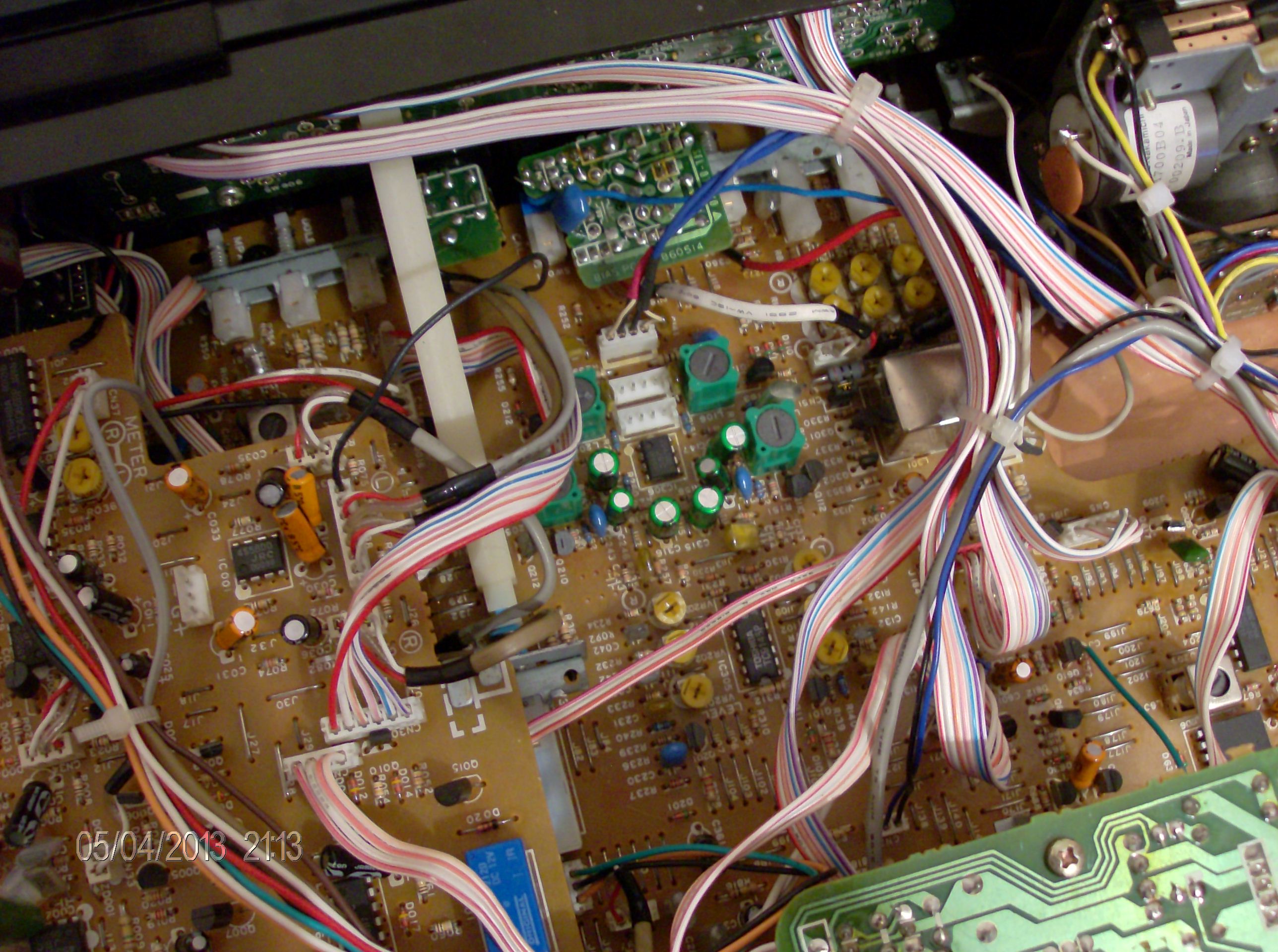

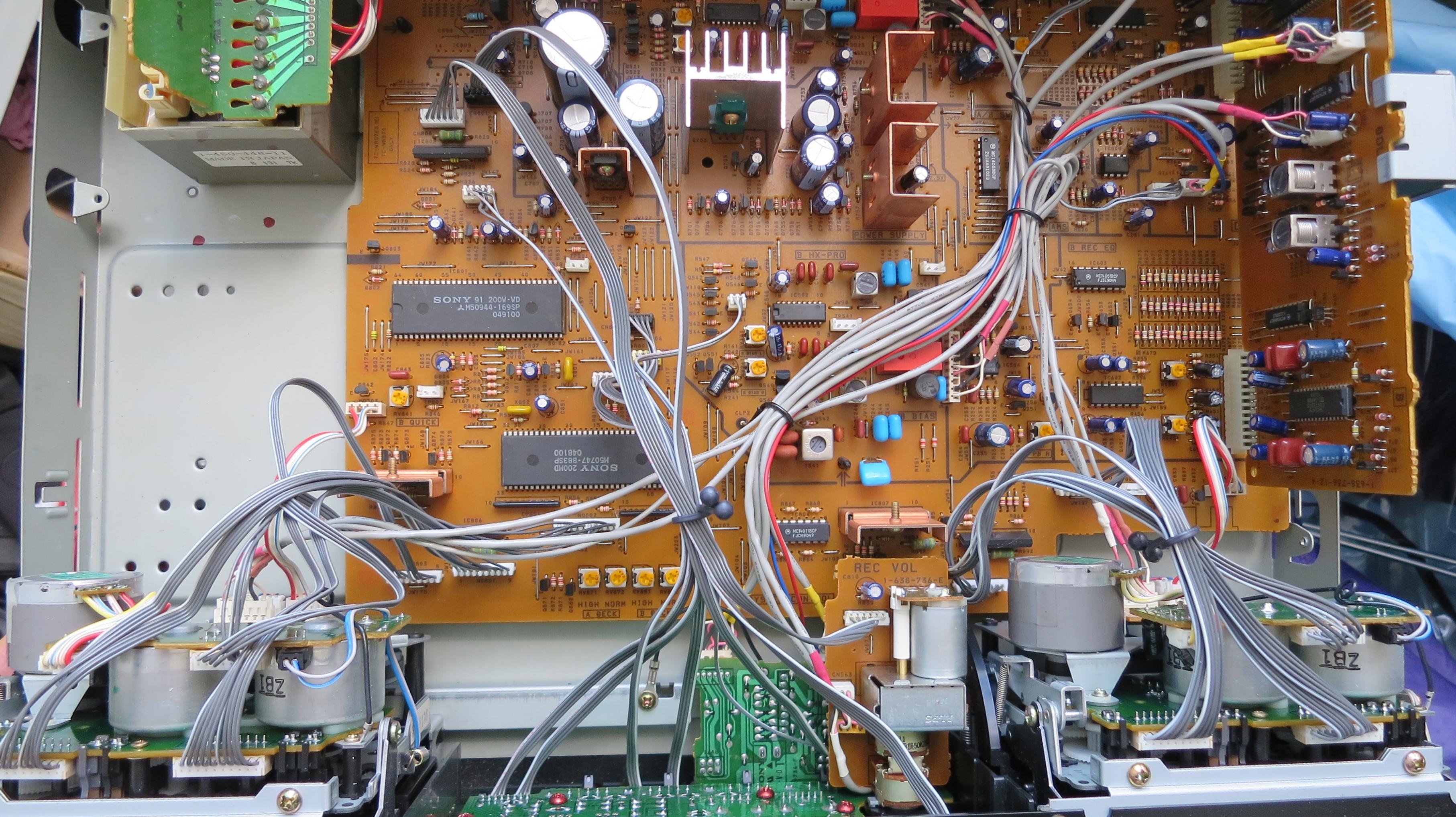

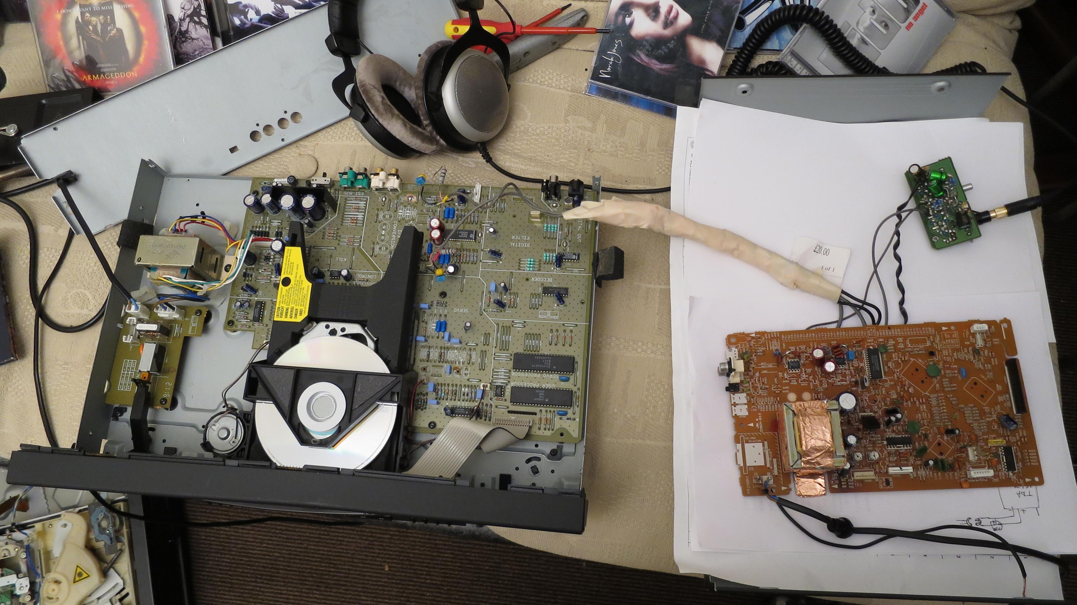

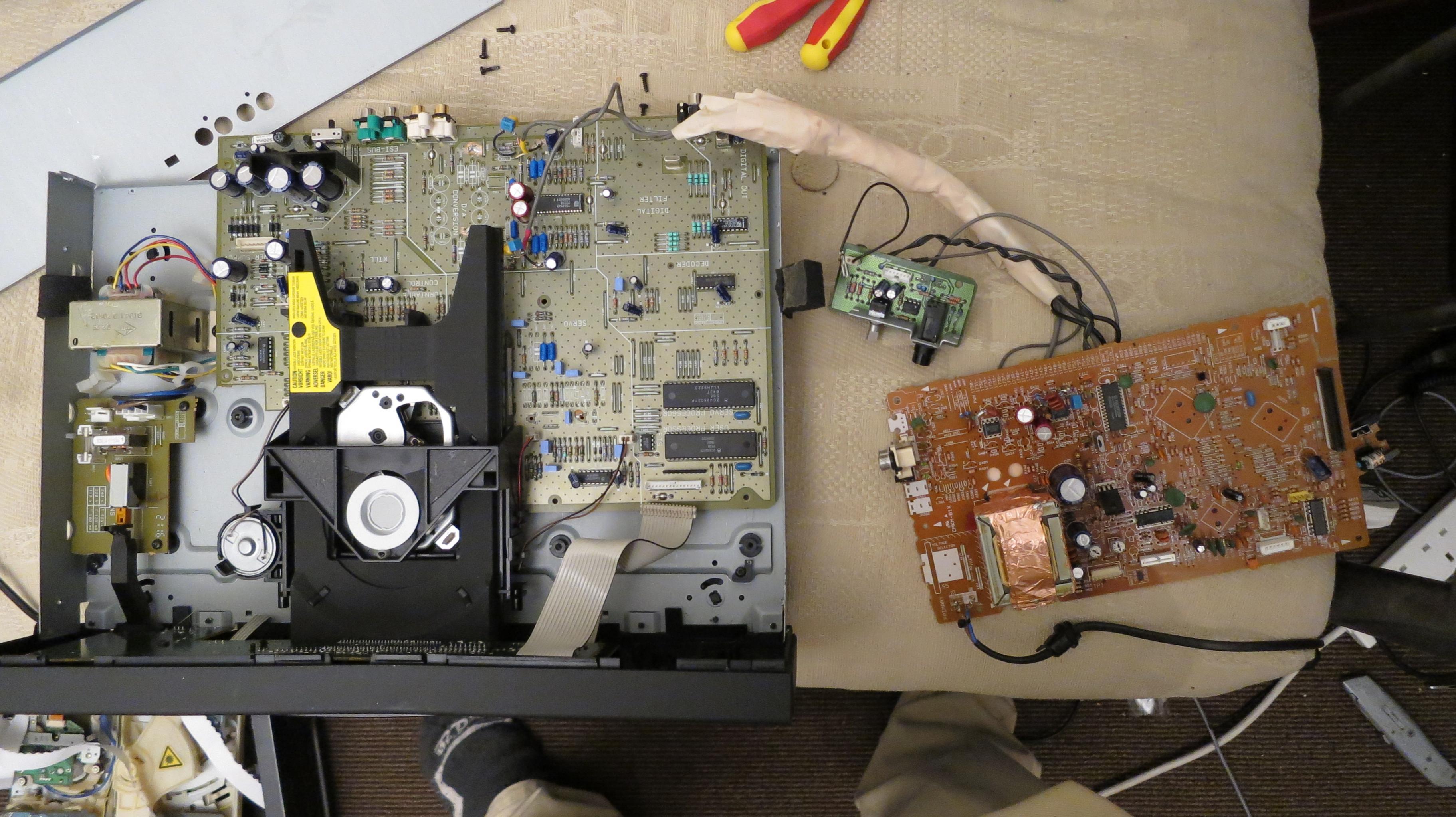

Actually i worked for two months on a real cassette player, the Pioneer CT-777 to be adapted with my Denon dcd 1560 .You can see in my photos that i actually modded the cassette player to the best possible .I explored even more by changing the whole input preamp with 3 versions of it and presented my ideas here and there:
Pioneer ...NO Dragon Killer - Tapeheads Tape, Audio and Music Forums
Pioneer CT-777/CT-95/CT-1100 playback input replacement

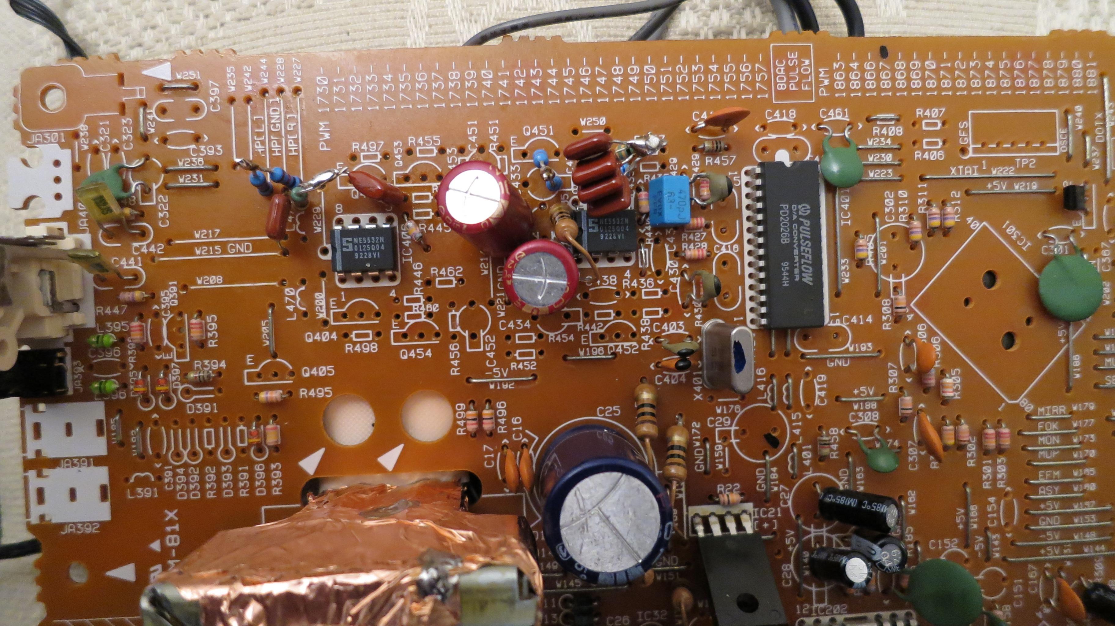

Unfortunately i can't find now the photos with the fet input mods that i added to the CT-777 and the Denon DCD1560 itself as i adjusted the Denon output (with an invert-ng subunity gain=1/4x or 0.25x gain stage ) to fit both the input of CXA20188 Dolby B/C processor or it's output bypassing it. I've made so many different mods to the whole cd-player-cassette player system that i can't remember, but I wanted the essence of it, so i took the decision to scrap the tape entirely .Unfortunately i found the time for this thing when i got 2600 km away from my lab ...At least i enjoyed modifyung a Phillips CD player as i never worked on anything but my Denon and some Marantz players before.

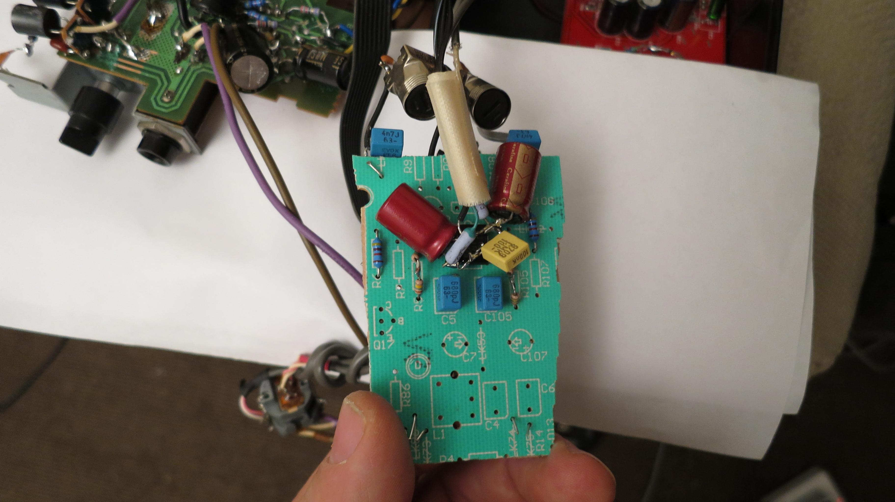

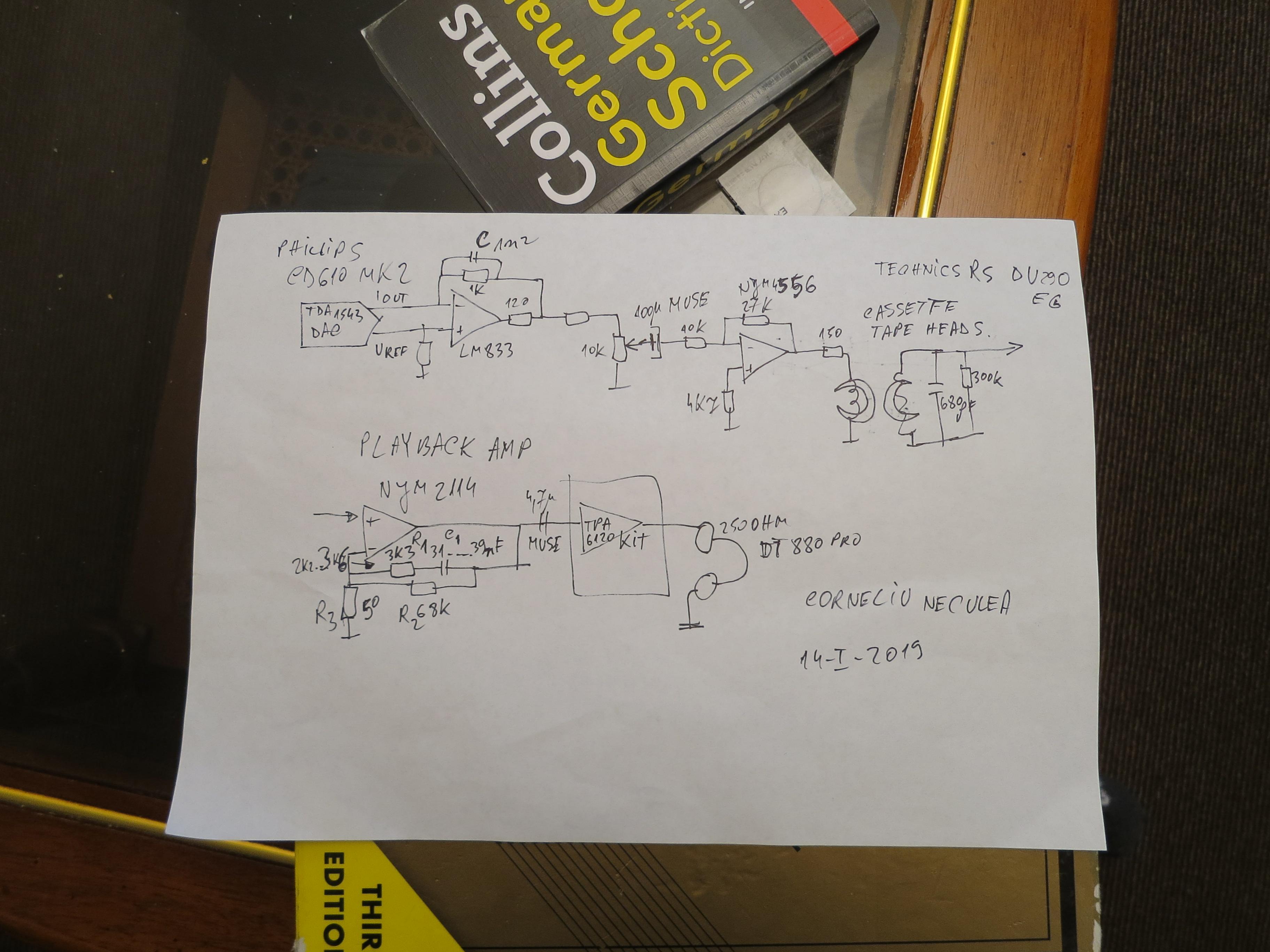

I just wanted to go in depth with this design to the level where I altered the i/v stage gain and adapted all the stages the best way. I don't also need all the mechanics , i have no bias oscillator to fight or disable or shield (i did this to pioneer ct-777 though) and i can choose my own playback amplifier and op amps or discretes to give the whole thing a gain.
With my last mod i simply have no audible noise at the maximum gain of the headphones amplifier , only a bit more White noise introduced by the njm4556 driver when i go all the way with the drive knob, but there i am also in very high distortion mode too. now i have anything in between cery clean sound to annoyingly distorted sound with only one knob.
Next thing to do will be to simply build a Nakamichi playback amplifier, get some really good tape heads from a good reputable cassette deck, replace the njm4556 with a lower noise op amp, but still powerful enough to drive my REC tape head and that is all you need to have a really good CD player. This simple experiment of mine made me buy about 70 cd's in the last two weeks , a handful of 30 years old cd players and i couldn't be more happy than this for this Christmas, me being alone for 12 days in an empty house and treating a seasonal fever too...

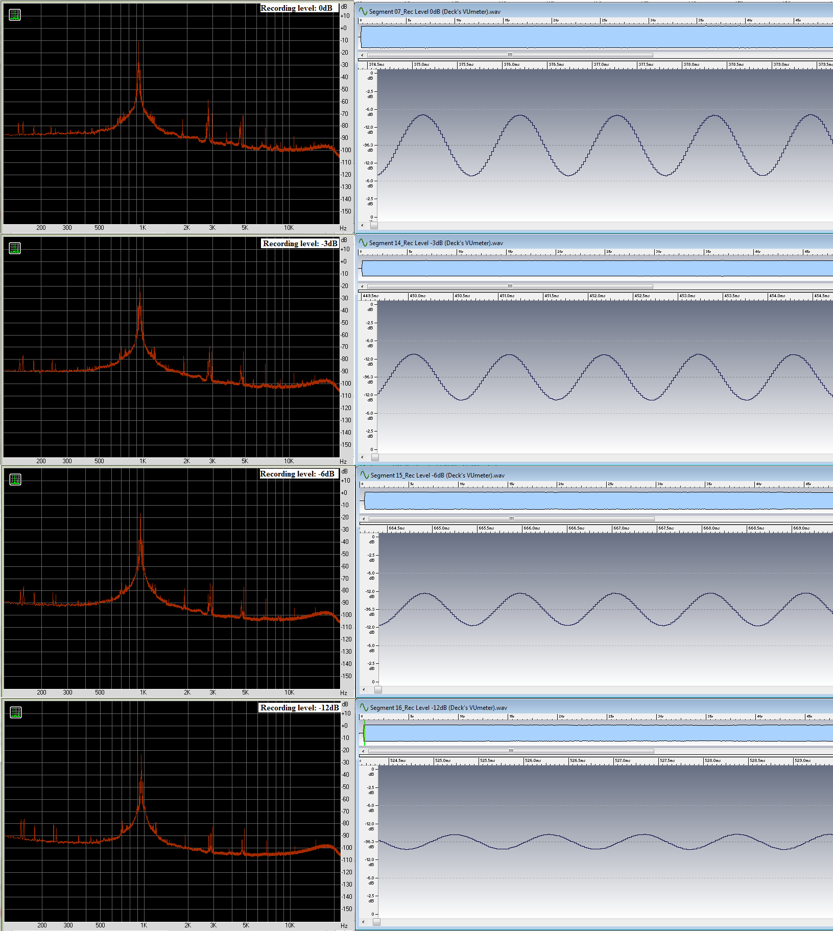

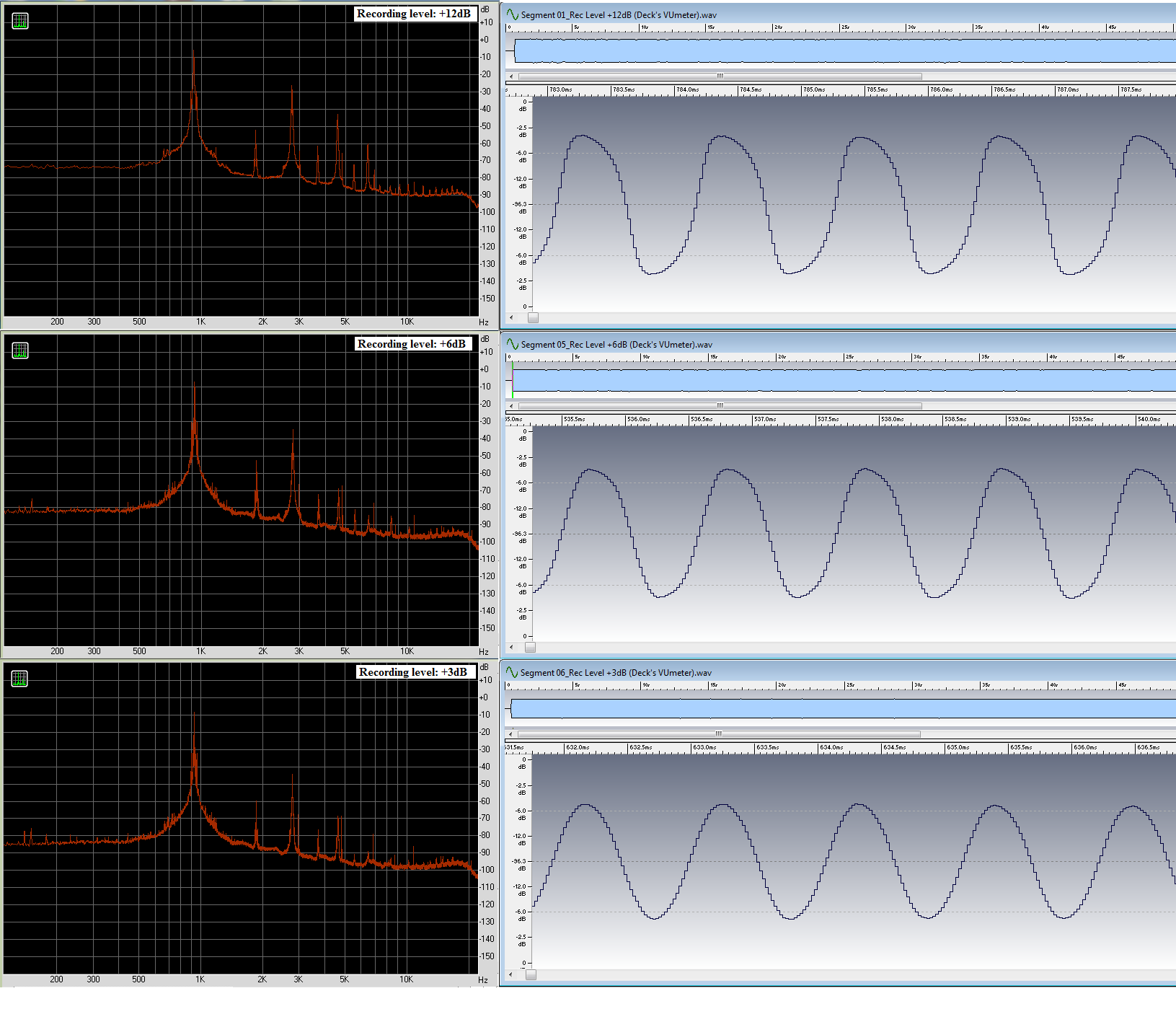

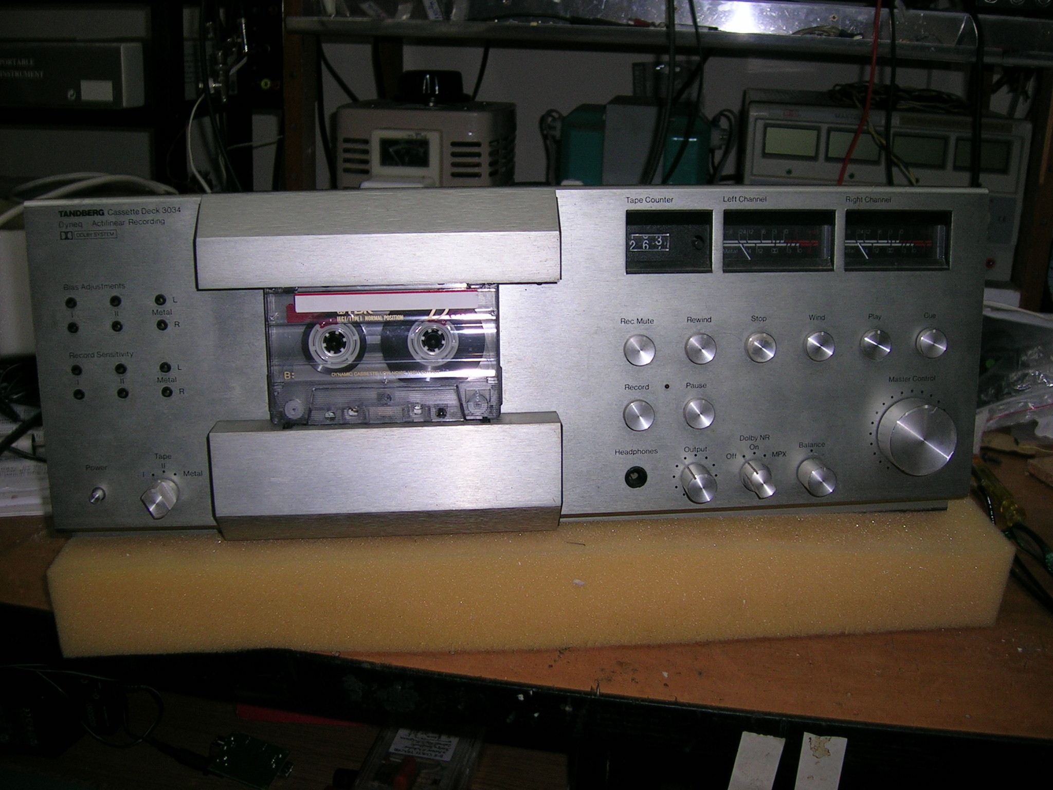

I run some tests today regarding the saturation behavior of a TDK Type D (Type I ) cassette on a Tandberg 3044 deck
George
I'm not sure if the Tandberg is a good deck to have this tests because it has the Dyneq system which automatically fight the tape saturation unless it can be deactivated:
http://www.ant-audio.co.uk/Tape_Recording/Theory/Tandberg_Actilinear_Dyneq.pdf
it's the same system as the one on Nad6300 which is making these players to sound way better over many others, being more powerful than the hxpro. I think that this is not working only at high frequencies but i can't be sure about that now.
It has no deactivation provision and it works effectivelly but to a degree (see DYNEQ expected effect at Fig. 2)

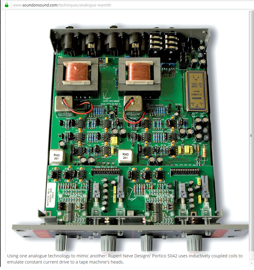

See how R. Neve does itSaturation on reel to reel is even harder to get because of the higher speed and probably it's needed only as a very mild effect not a very aggressive one as a guitar head crunch or drive.The Abey Road C37 saturation tape simulator effect must be also about the valve-transformer coupled sound as C37 is not solid state
http://rupertneve.com/static/media/2014/12/portico542manual-rev-A-master.pdf
http://mediaschool.ohio.edu/Websites/ousmas/images/origwiki/5042userguide12-6-5.pdf

Here you have the last reincarnation of the whole chain i'm using now.I simply can't make my mind which RC network to choose best with the R1 valued n between 2k2...3k6 and C1 31...39nF.R2 should be 62k instead of 68k as in the original pioneer schematic, i have no 62k resistor at hand, but i'm also 41 so i do enjoy a bit more bass and highs...All the values should be different for other tape heads and should be tweaked accordingly .
