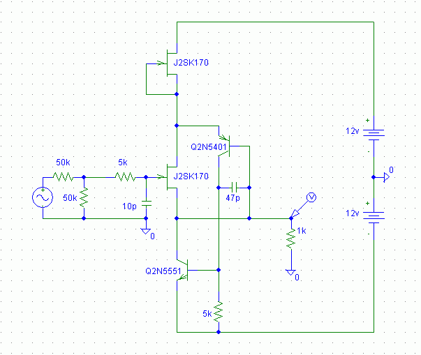

It's not really a feedback design. It's a constant voltage, constant current design, sadly not mine. The principle is from steven.
The idea is, a device having no voltage/current fluctuations does not distort by principle.

As usual, it's a matter of viewpoint wether we call it feedback or not 😉
Actually I made my way through the circuit regarding the PNP as the error amplifier which tries to establish a constant Vds accross the FET by controlling the NPN current sink. This controlled current sink also gives the low Zout of 0.1R, rising from ~20kHz with a 6dB/oct slope to ~10R at 10Mhz, as per sim (also getting your ballpark THD numbers). All this confirmes the feedback view, giving the gain values of a single simple common emitter stage. It is not direct signal feedback, of course, rather it is somewhat indirect via the constant Vds and constant Id.
Do you have a reference/link to the circuit (I don't know which Steven is meant)?
- Klaus

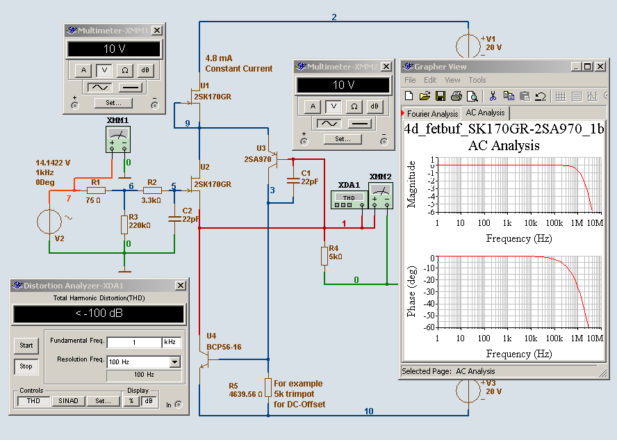

It is a remarkable circuit. I am going to say however invented it is a MASTER.
I started out using 2SK170BL, at ~10 mA CCS. And for a 1 kohm load.
After some tweaking I ran THD, FFT and AC-Analys.
Boy what performance!
Compared to other circuits I have simulated.
Then I switched to 2SK170GR model. 4.8 mA constant current.
As can be seen in my attached circuit.
I chose 2SA970 (high gain) for NPN and BCP56-16 for NPN.
BCP56-16 is a modern SOT223 (max 1.5W), basically with same characteristics as BC639-16.
The ouput level is considerable in my simulation:
Load is 5kOhm.
14.14 Vpeak (out of 20 max supply)
2.83 mA peak output current, almost 60% of 4.8 mA
I have used 22pF at input, to roll off -3dB at:
~ 2.2 MHz
( For practical use, if not having super PCB board layout,
I would recommend to change C2 to 100pF,
which would give a rolloff at ~ 480 KHz )
FFT shows nice spectrum, at the above OUTPUT:
2nd: -101 dB
3rd: -116 dB
4th: -136 dB
5th: -142 dB
..and the rest is below -150 dB
This circuit shows one unusual thing:
It puts out a tiny bit HIGHER Voltage, than the input
This is why I have added a small ( 75 Ohm ) resistor,
to drop to same output level.
As mentioned, it has a very good PSRR.
This is typical for circuits that uses CCS, constant current sources in vital parts of the amplifier.
There is for example a high correlation between
The Price and The PSRR ratio in good audio OP-Amps.
Study datasheets and you see this is a fact.
Regards

This slight increase comes from the sligthly lower current in the bottom FET. I've fiddled with the circuit a bit, added a emitter follower in front of the PNP which allows more current (=more bandwidth) in the "error amp", plus it unloads this fluctuating current from the top FET ---> even better perfomance.... this circuit really seems to have some potential. Another neat feature is that it works down to I/O-voltages close to the neg. supply.This circuit shows one unusual thing:
It puts out a tiny bit HIGHER Voltage, than the input![]()
- Klaus
I might be wrong, but it seems the relation between the BJT and the FET is positive feedback instead of negative feedback.

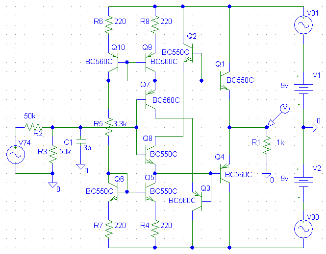

MikeB, I'm interested in this Diamond Buffer Output Stage. What is the use of Q2 and Q3? And since the input is BJT, would not the high input bias cause some instability issues when used with a high resistance pot?

q2/3 between the collectors of q7/8 and the rails are the difference to a normal diamondbuffer and are floating cascodes. These heavily improve performance of the buffer.

Hi, MikeB,
I saw some make diamond buffer by attaching collector of Q8 to emitor of Q1 (C-Q7 to E-Q4), instead to rails. What properties are improved this way?
Mike! So can you expain more details about the difference?😎q2/3 between the collectors of q7/8 and the rails are the difference to a normal diamondbuffer and are floating cascodes. These heavily improve performance of the buffer.
