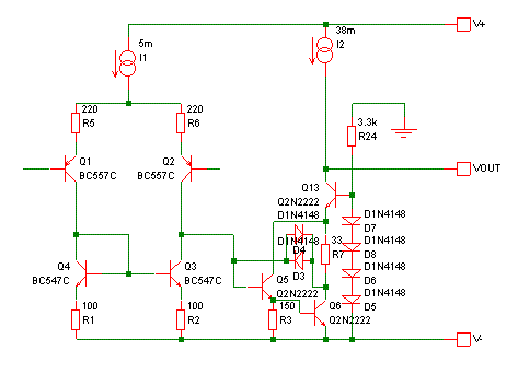

Here's a VAS design I came up with a while ago that I like the look of, although I haven't tried it. It's fast and offers clean clipping with rapid recovery.
There's a few key points:
A) None of the VAS transistors ever saturate or switch off.
B) If Vbias is set correctly, it provides symmetrical current limiting.
C) Due to (A) above, voltage at the base of Q2 stays almost constant, even when the output is clipping.
Regards - Godfrey

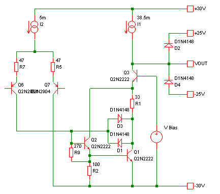

edit: p.s. Here's a version with a current mirror, hastily cut out from a complete amp schematic before I run out of edit time. It needs clipping diodes too.

Some ideas there Godfrey. I especially like the collector resistor R1. This doubles up as a current limiter as well.
Does R1 act similarly to Puefue's "magic" resistor? i.e. trying to maintain constant power dissipation.
Does the compound current route R9+R2 as the input collector load, change the way the VAS works?
Would a pair of 25V Zeners from the +-30Vdc supply rails work as the voltage limiting +-25V references?
Or.
Would it be better to run the next stages @+-25V and then the VAS limit would match the next stages capability?

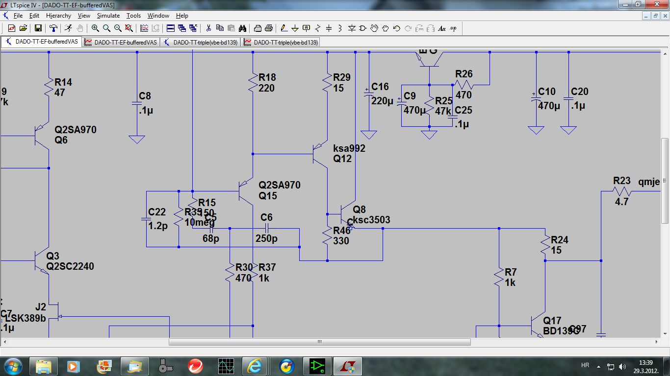

My Ovation 250 uses collector resistors as Godrey shows in a beta enhanced cascade config. However, I did not implement the anti saturation networks as he has done. For my reduced implementation, I can say it sounds pretty good (note: my overall configuration is balanced, but Godfrey's enhancements can be applied just as easily)
In principle its a cascoded darlington. How does it perform linearity wise compaired to beta enhanced. I have found them to be inferior although there aint much in it. Also its not a straight forward comparison.
The cascode reduces miller effect which is true but it doesnt reduce the intrinsic Cob of the vas, the capacitive effect is simply transfered to the cascode device where alas it is smaller but now you have darlington and twice the Cob in the vas. The lower output impedance of darlington will however have lower distortion but this only in the low frequencies, when Cob comes into play at high frequencies it will be inferior. I guess its a poison to pic. If your darlington has perhaps infinite hfe I guess at some point the impedance will be the determining factor. Maybe a darlington where the first transistor is a cfp would swing it in favour at high and low frequencies.
