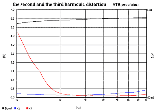

Aurum Cantus G2 published distortion specs.
1. Does this bear any similarity with reality?
2. Is this good?
Unless there are some nasty high order distortions that aren't shown, if the real figures are close to what is below that looks pretty darn good to me.
2. Is this good?
That's true, although it would likely be ultrasonic. I wonder how many people have measurement equipment that goes up past 60kHz to measure K3 at 20kHz.
I am interested to know if anyone has data to back up the "high distortion of ribbon tweeters".
