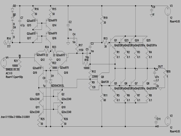

Re: Cascode PNP
so this is Graham's design?
Wow!
LineSource said:Graham,
Used your circuit to test out recently downloaded Spice models.
Wow!
- best topo for 25W class A into 1 ohm resistive load?
